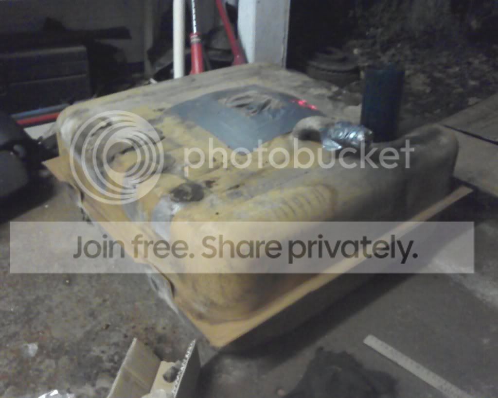

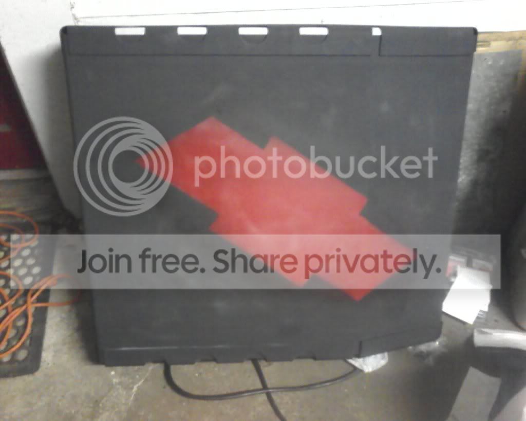

Had today off work, it rained all night and part of this morning, so I straightened the garage enough to back the K5 in partway. First order of business was taking off the skid and dropping the tank(3/4 full:doah:)...by myself...did get creative painting the skid though haha:D

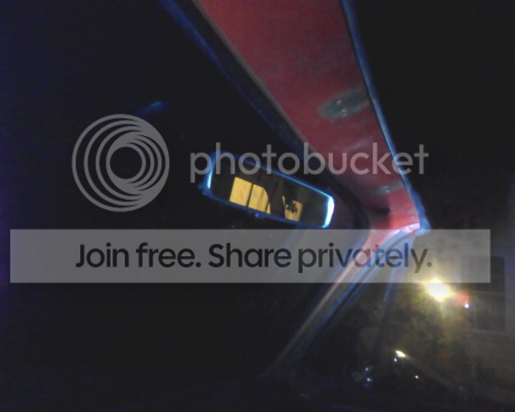

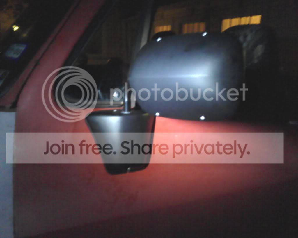

Then I swapped on the new rearview and side mirrors

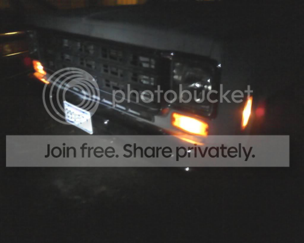

And went back to amber lenses to match the sidemarkers and b/c i like amber better than the clearish ones

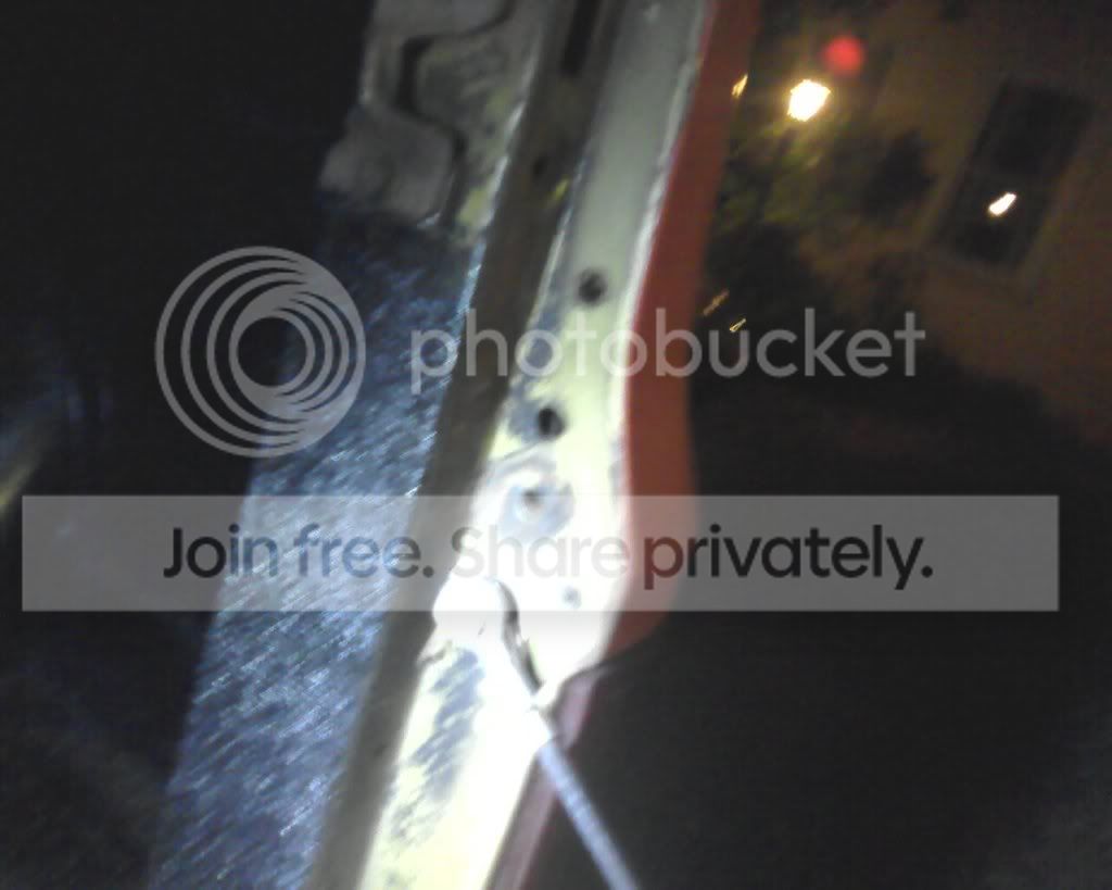

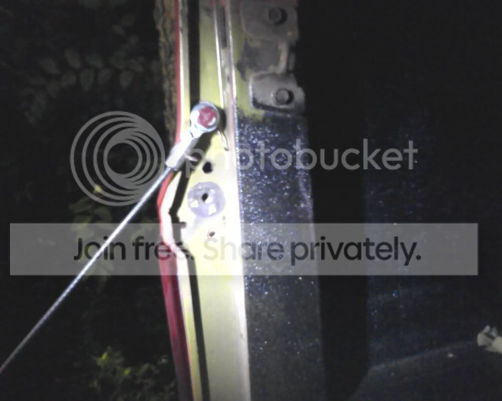

Also put a new tailgate cable on, it's longer than the one that has been on there, but i made it work and don't care if it doesn't match.:haha:

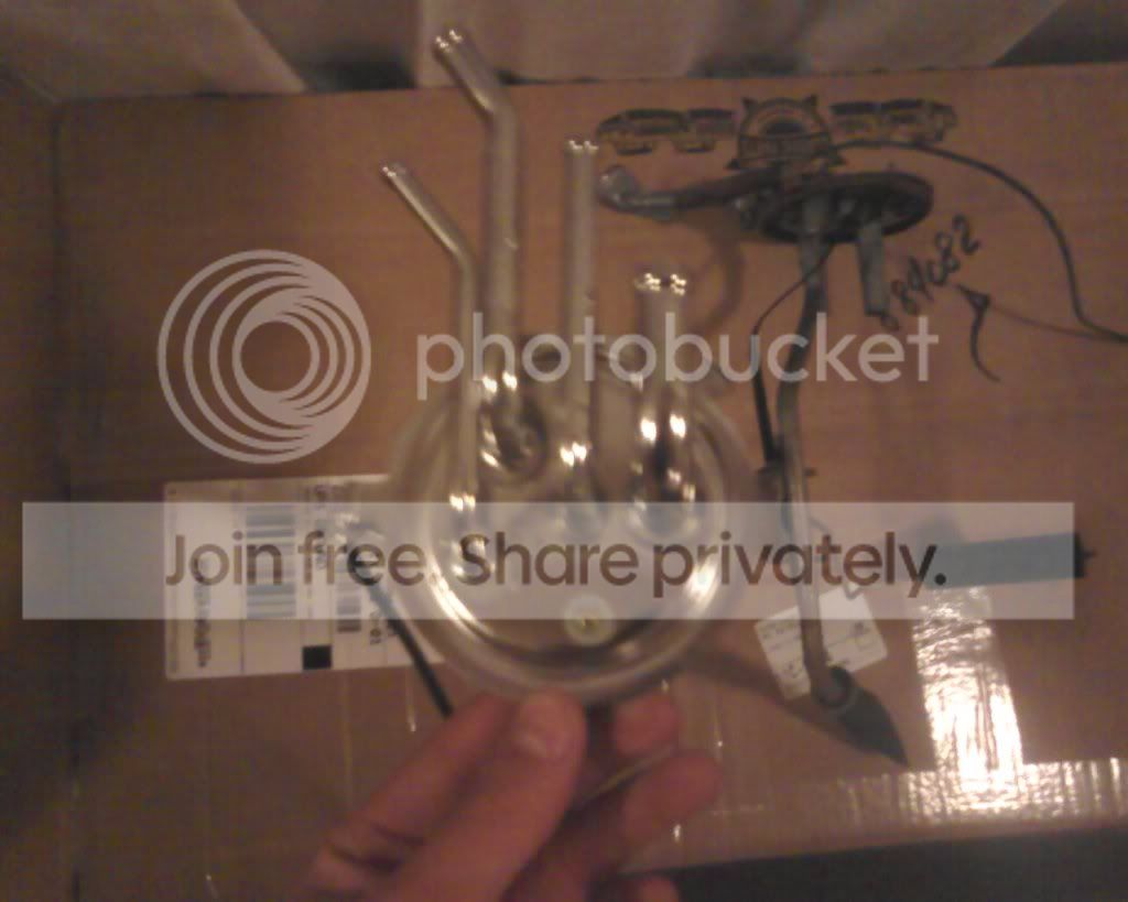

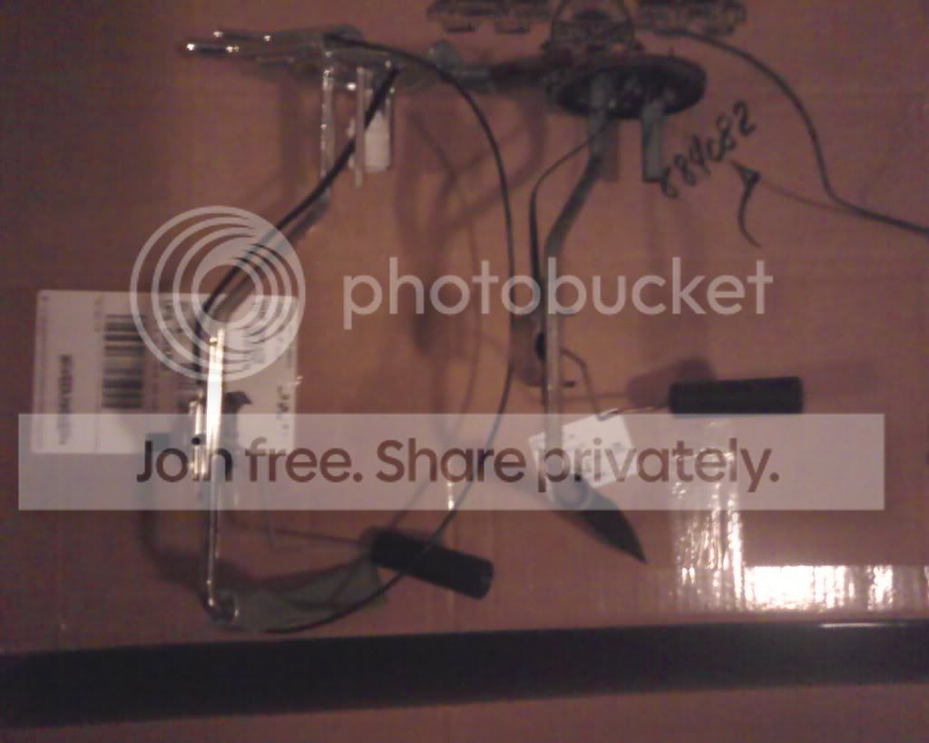

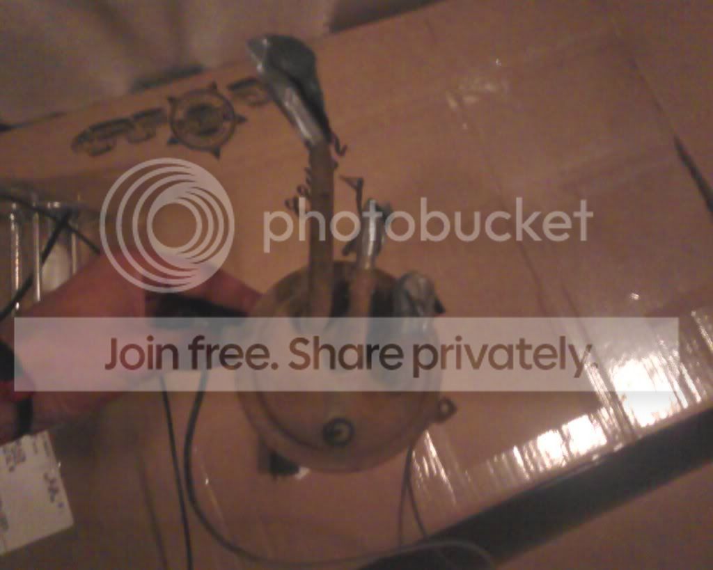

Also found out that whoever swapped in a new fuel sender at some point put one in for a 25gal tank (3 outlet). the tank in this k5 is a 31 gal (my dad said "no wonder i ran out of gas all the time...." haha) So the new one i ordered and got in is for a 31gal tank (4 outlet). I don't have a 4th connection (I think it is for a return line?) Anyway, it's been working on 3 so it'll stay that way.
I have the LED lighting and the new turn signal switch/cam, so I will need to install those. I went by Autozone tonight and ordered new straps for the fuel tank (cheaper and no shipping charge) since I sheared one of the bolts.

I like the amber lights much better than the clear also. I just installed 4 new headlights on my '91 burb and will be installing new amber turn signals soon. The clears just don't look good at all to me.

That fourth tube on the pump unit is a vent for the k5 tanks. I'm pretty sure that all the senders measure the same resistance for fuel level. perhaps the 25gal is a different story but my saddle tank sender measures the blazer tank I swapped in perfect minus the typical over fill/reserve that most of our trucks are off by.
