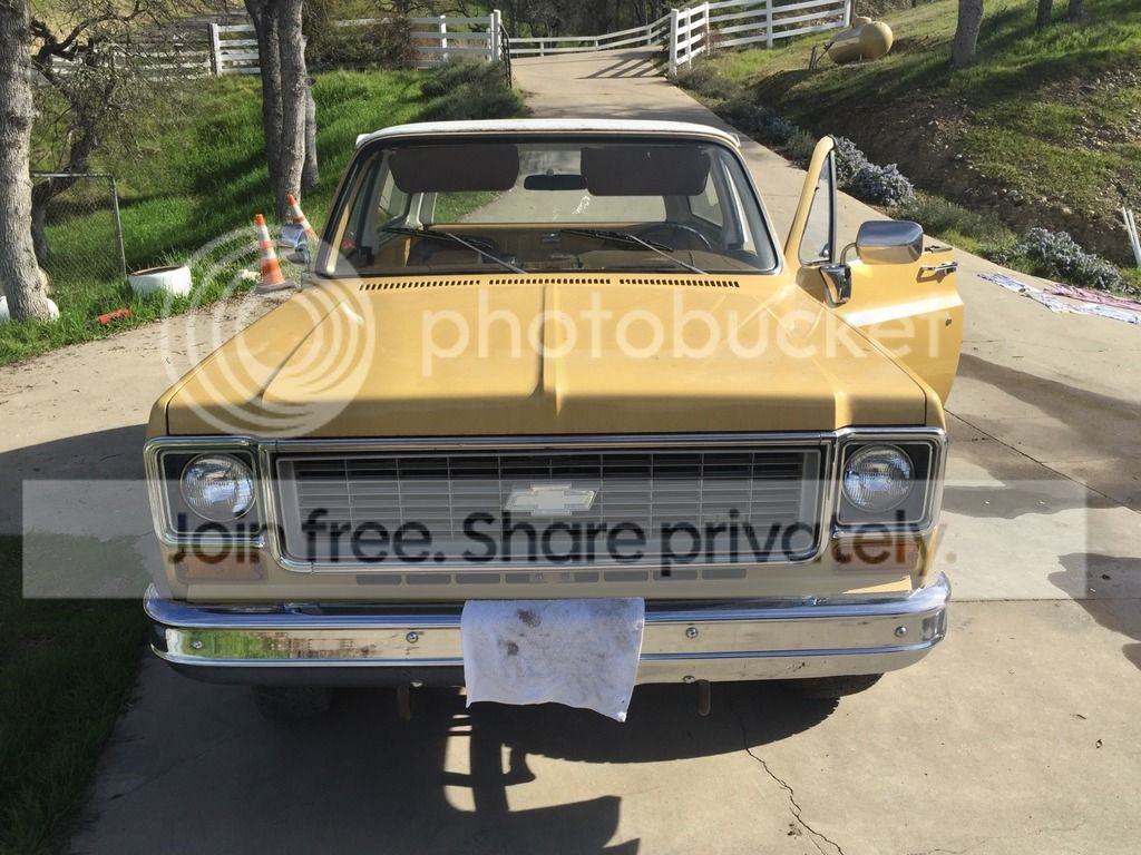

After a 6 year hiatus from wheeling, I've finally come to my senses and after 4 months of searching I have finally picked up the right full convertible Blazer. It's about 90% rust free, just a few spots on the floor boards by your feet and some minimal surface rust.

Looks like the one I almost drove to look at in Texas back in 2010...it's the perfect color already :D
