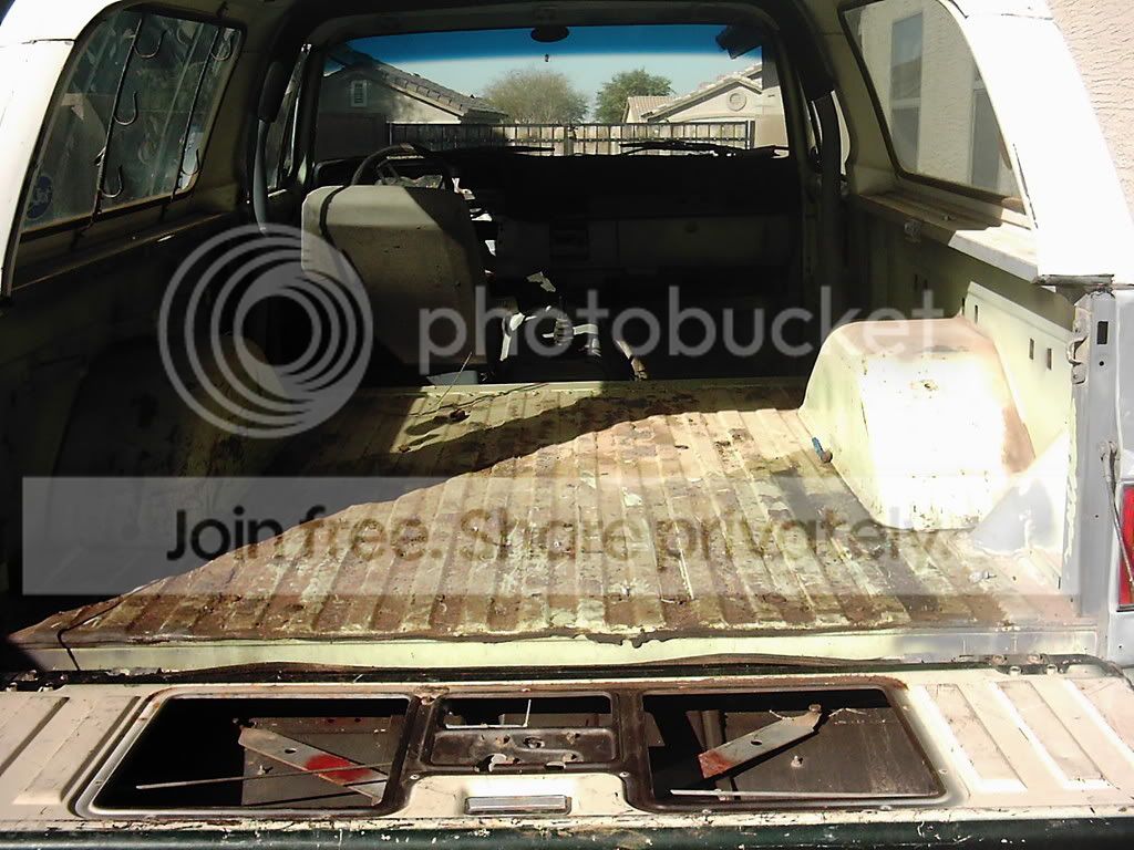

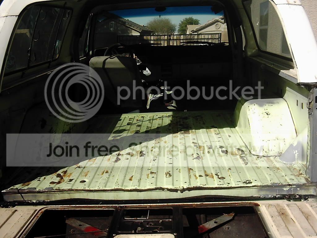

No new updates really. Cleaned out the interior this past weekend and thats pretty much it. Looks like the P.O. used adhesive in the back to hold down a carpet. So i have to do some more scraping to clean all that out but its not too much. heres some pics
before
][/img]
after
][/img]
also removed the Gas tank to get ready for my new Poly Bushings as well as the 1 inch body lift. Which will be ordered this week and installed next weekend.
