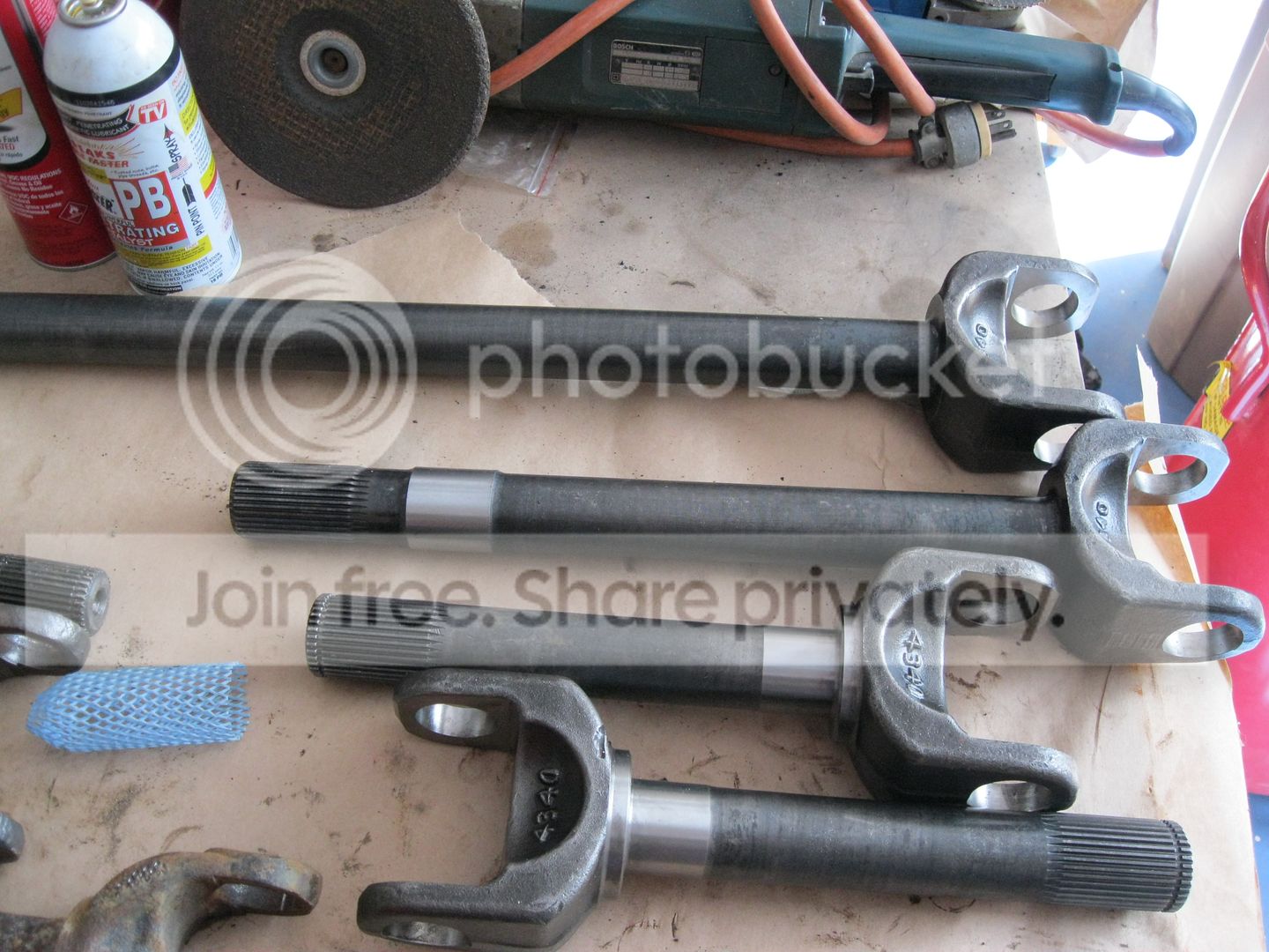

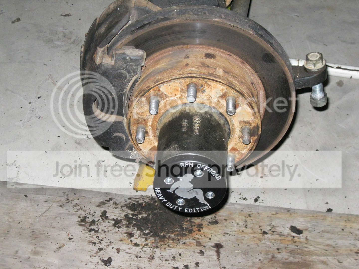

Out with the old
In with the new

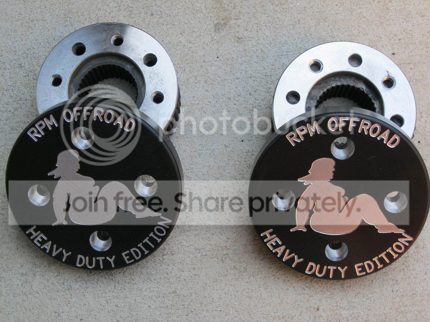

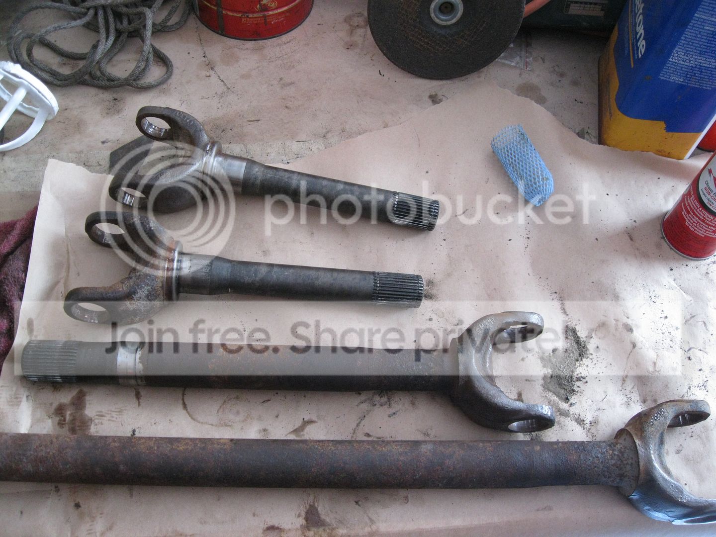

35 spline 4340 inner and outer shafts
35 spline drive slugs
got them in
then I saw this :doah:
guess I'll be pulling the drivers side back apart in the morning :whistle:
I hate having extra parts

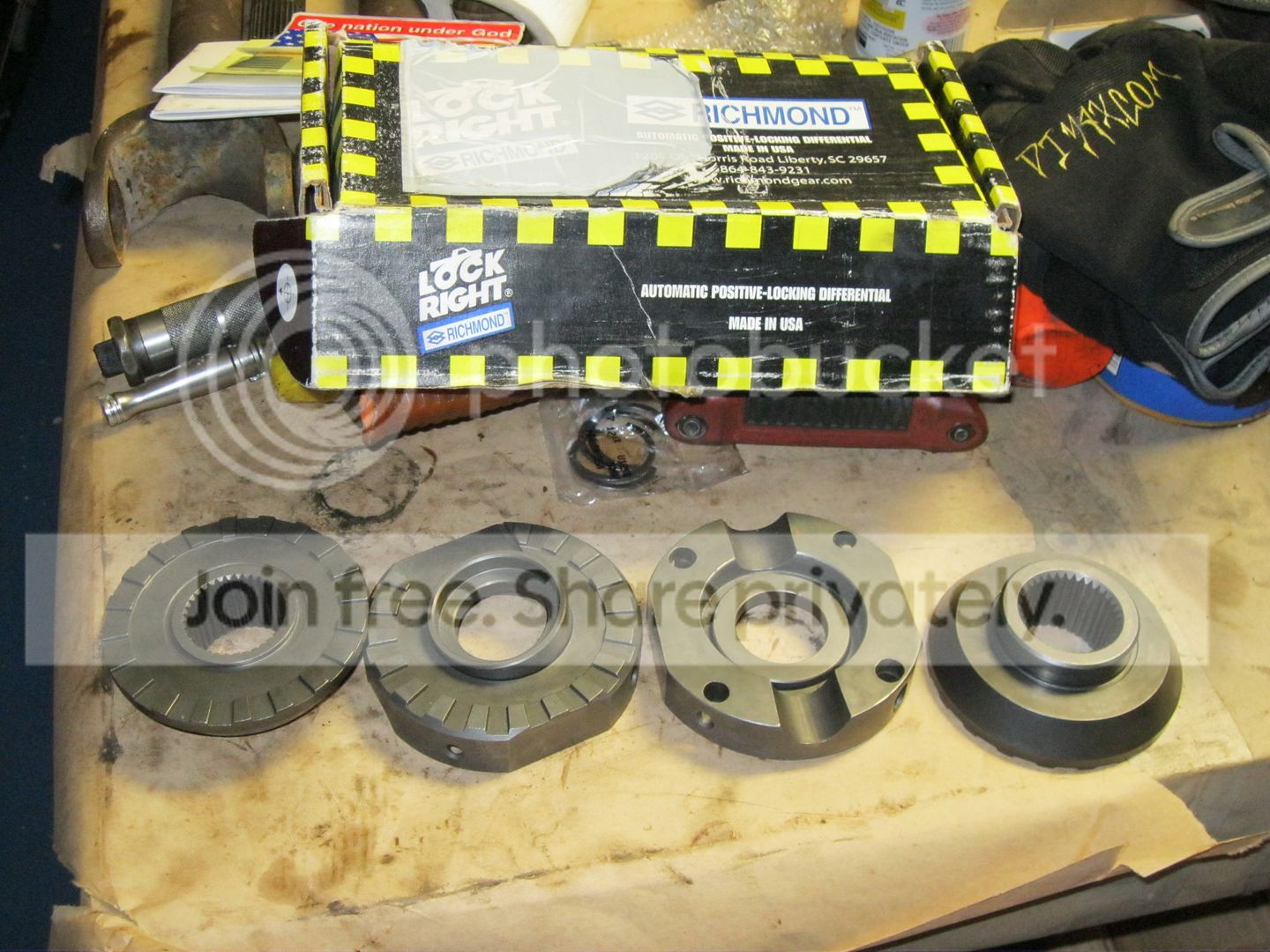

I've seen some failures with the D60 front lock right, but they do last a while. At Blazer Bash in '03 BadDog got off to a bad start when his lock right up front started popping and banging rather than locking. Up til that point he was a fan of the inexpensive LR in a 60 front...he ended up installing a detroit up front.
I think he got about 10-12 wheeling trips out of the LR before it packed it in. He was buggy'd, small block, doubler and on 42's.

i've had good luck with my lock rite. it's in it's second truck now. when i swapped it out, the teeth had some wear on it in one direction, so i put it in the other way into my race truck 3 or 4 years ago and it's never lost a beat.

I want a full Detroit for it but I figured for $220 shipped I could deal with the Lockright for now.

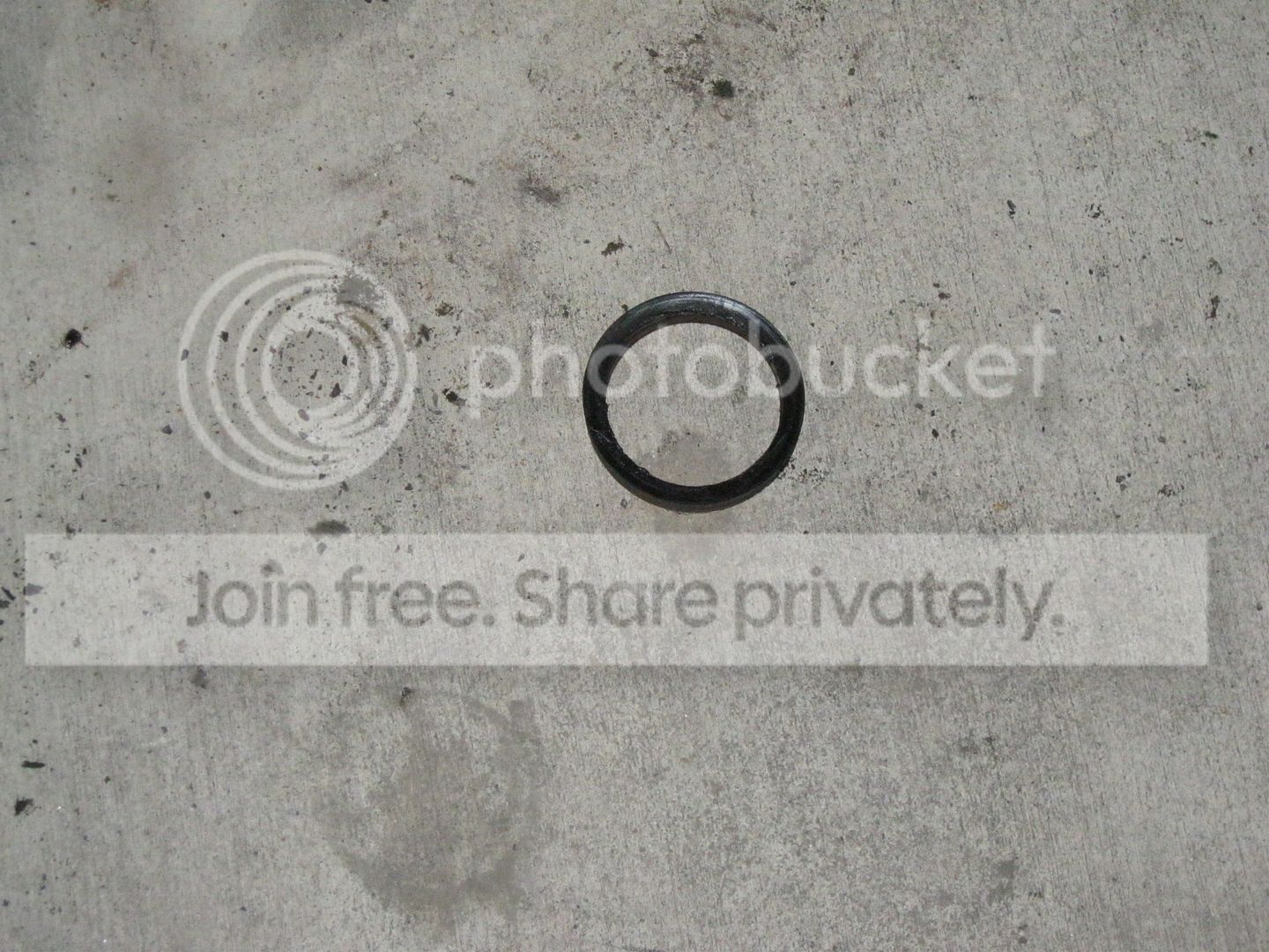

1: I got that seal put in that I forgot yesterday.
2: Lockright in and done. Locker was a pain in the ass. The driver side axle had to be pulled 1/2" out to get one of the gears in place. I'm getting real good at pulling the spindle now.:rolleyes:

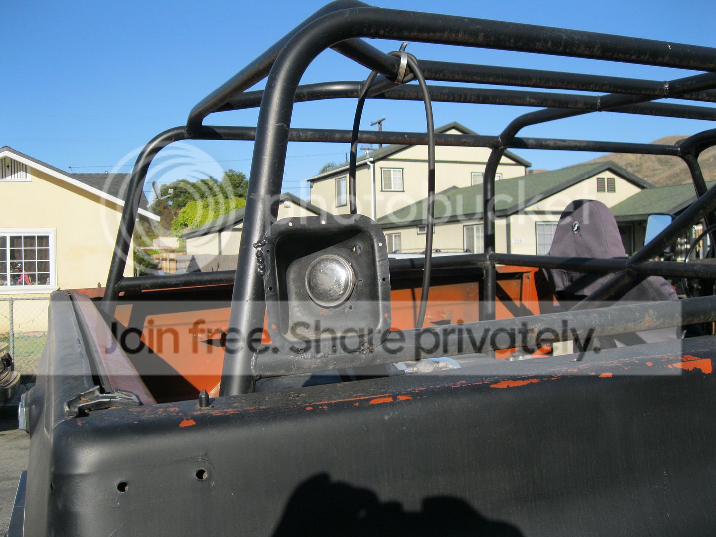

3: Pulled the fuel tank in prep to move the shackle flip back a few inches. Also going to relocate fuel tank into the bed I'm not sure if I can do this or if I need to get a fuel cell. Any thoughts?
4: Installed new 140 Amp alternator

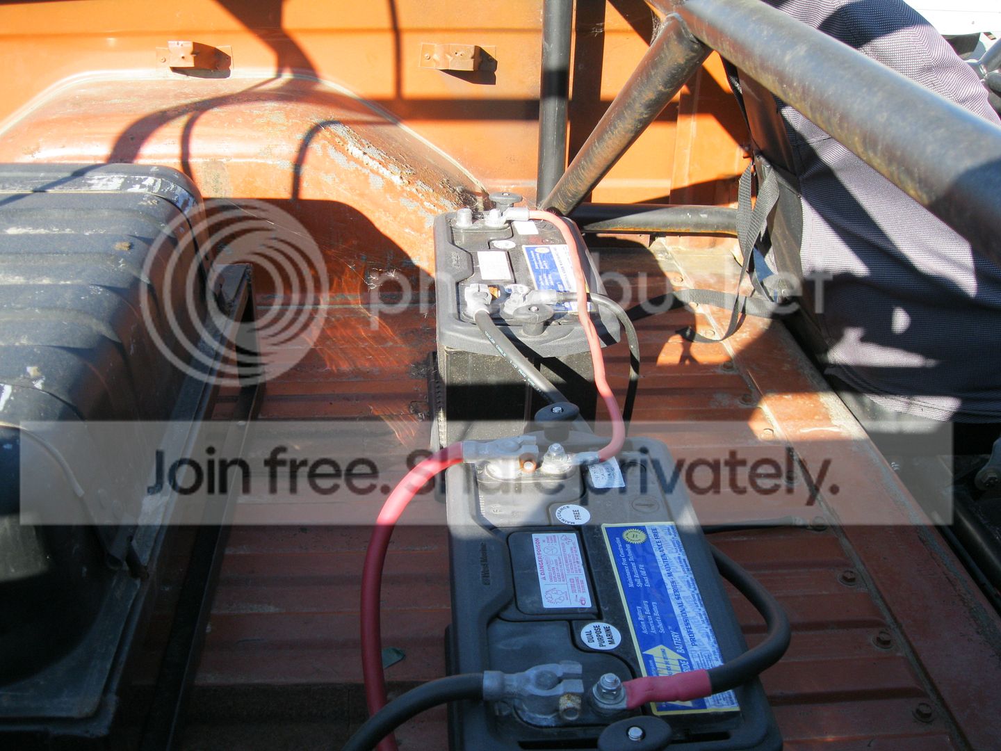

5: Started mocking up dual batteries. I'm relocating them to the bed behind the seats. They will be covered and isolated from fuel tank (to prevent any metal from arcing from the battery to the fuel tank)

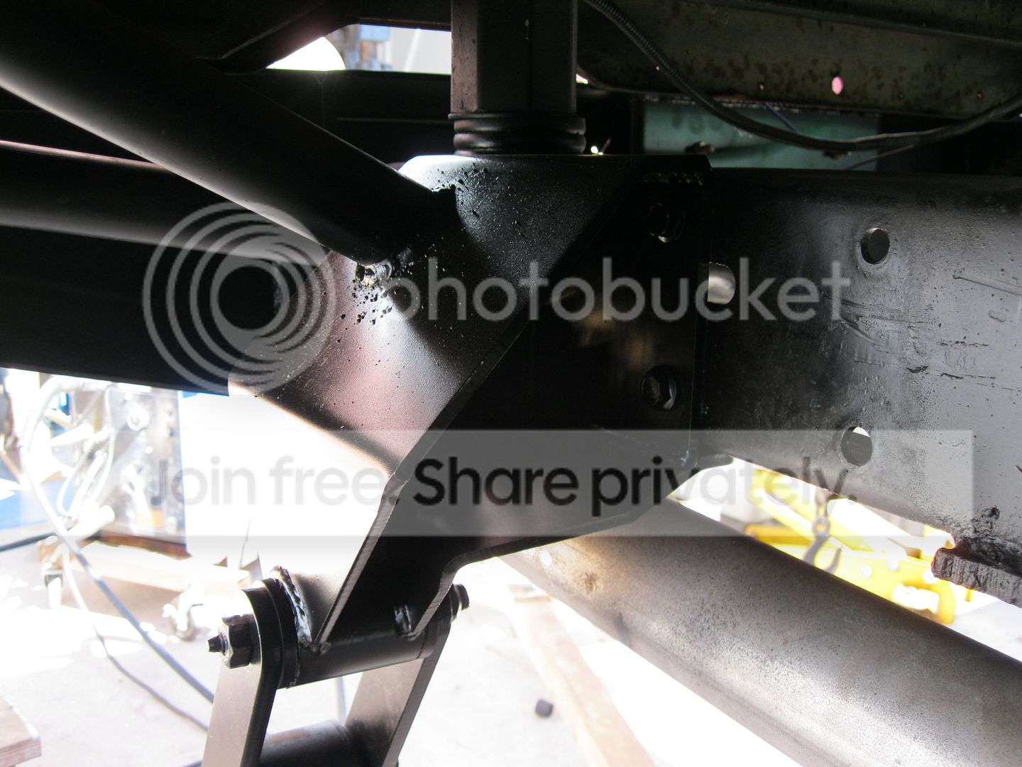

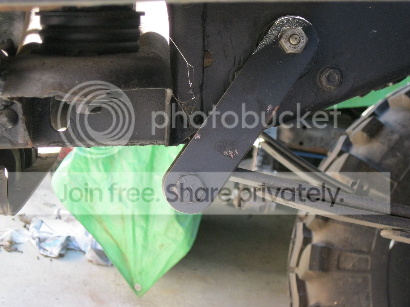

More progress

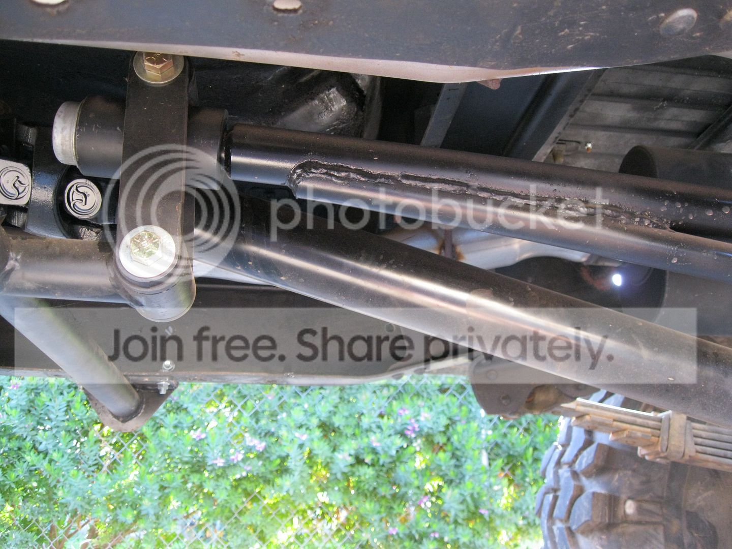

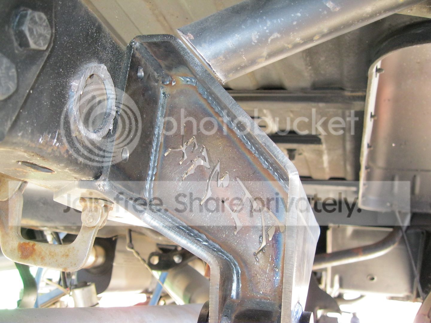

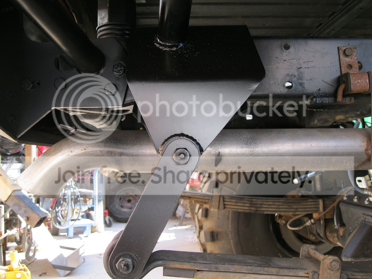

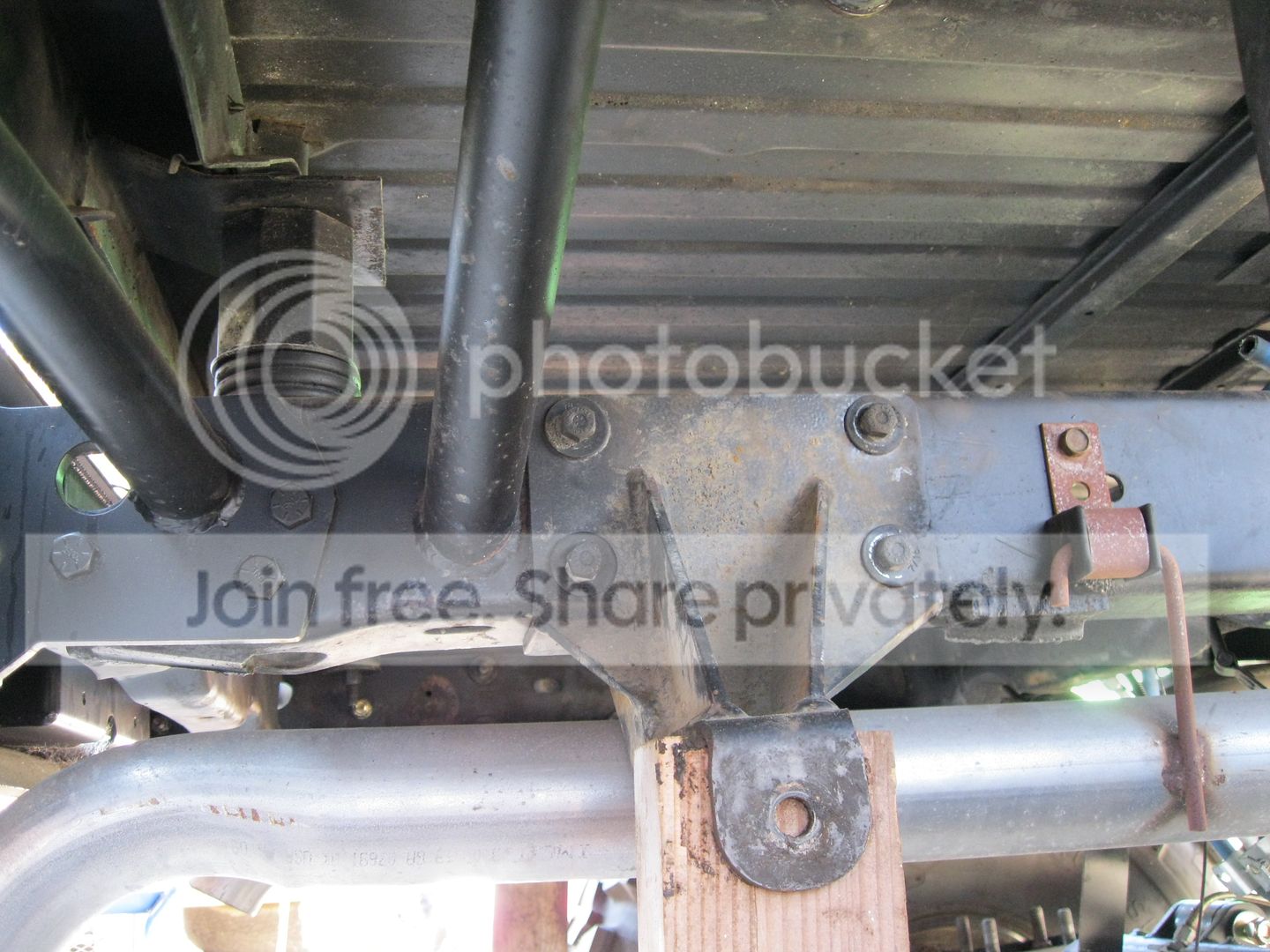

Changed from the ORD shackle flip to a DIY4X flip & switch for easier shackle length adjustment.
Before
Cut out cage tie
Finished
shackle angle

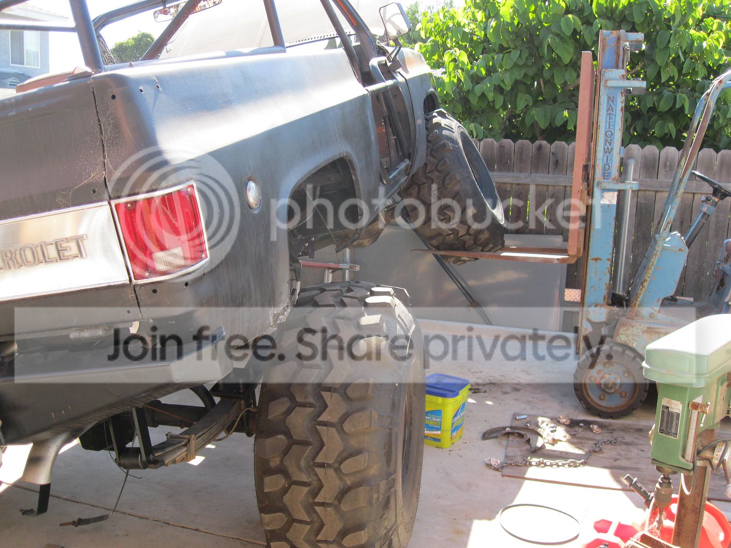

Fork lift flexing
I can get more rear droop if I take out the bolts in the spring clamps, I'm just not sure if that would destroy the spring to quickly. :dunno:

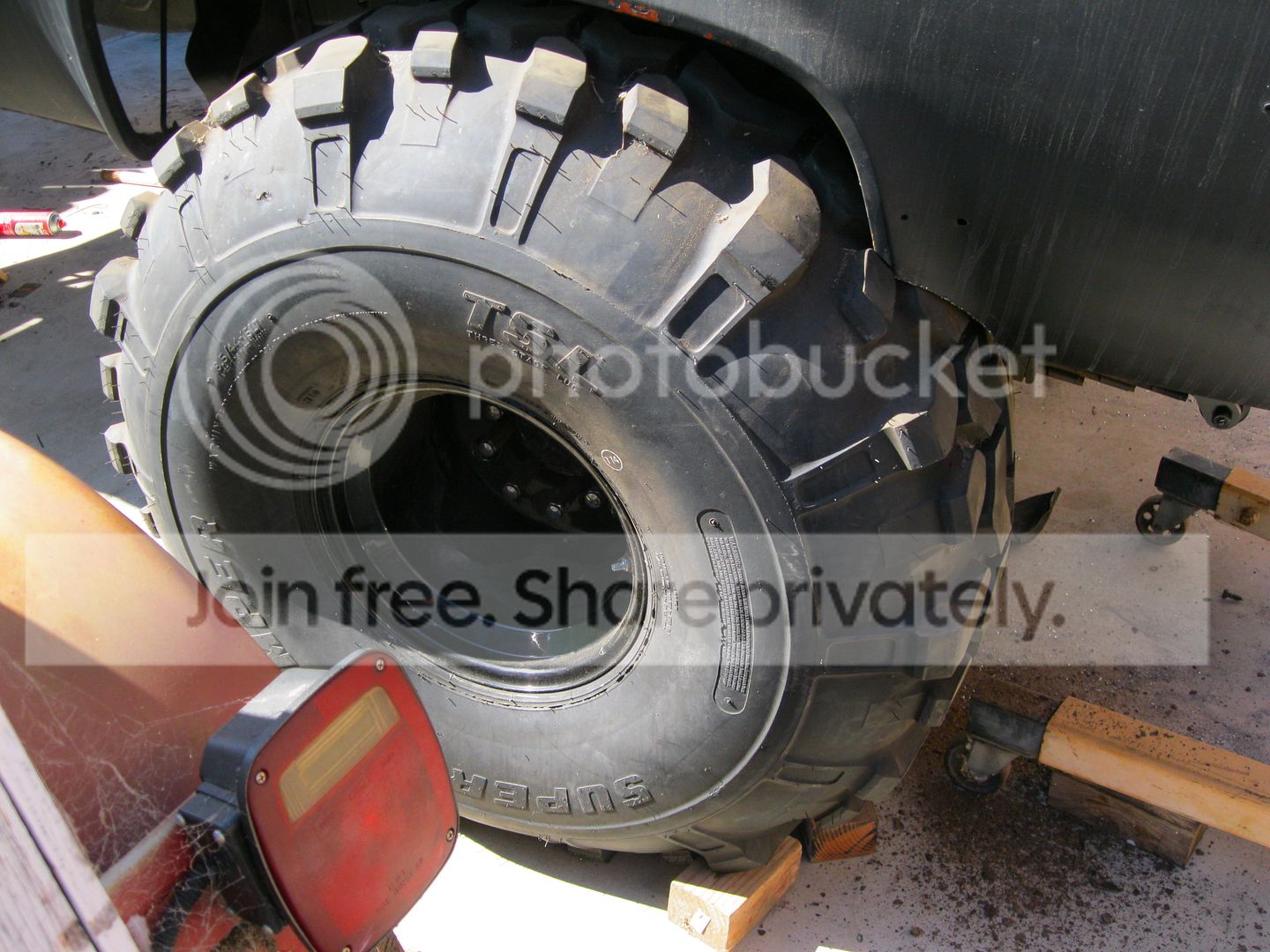

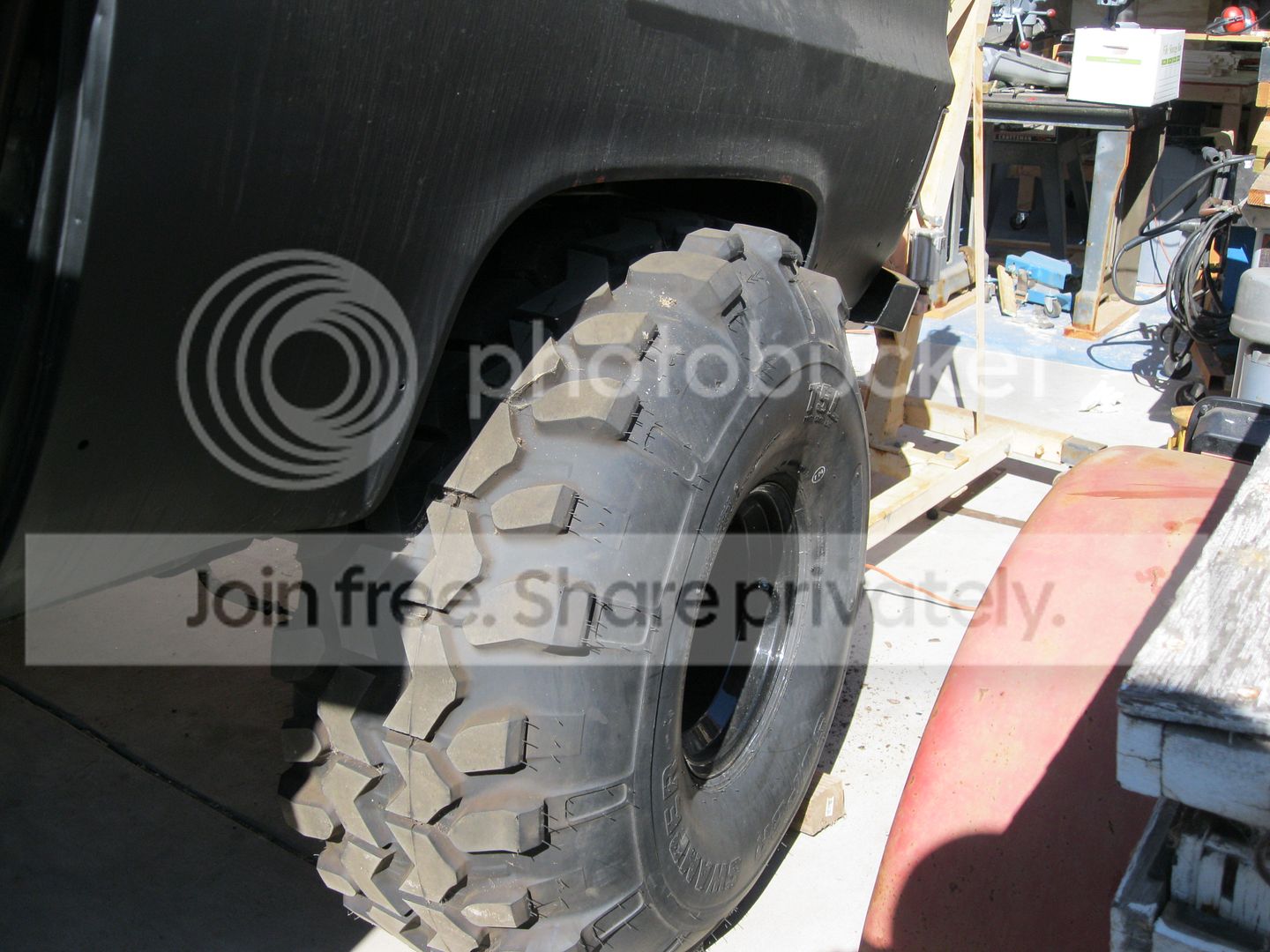

Front shackle angle @ full stuff
Rear stuff, did a quick fender trim to stuff that far, more needed.
Different angle
Looks awesome! That rear stuff is really in there.

hmmm, so 550 tq, a doubler, 4.56 and 40's might spell trouble for me?

Here you go.........

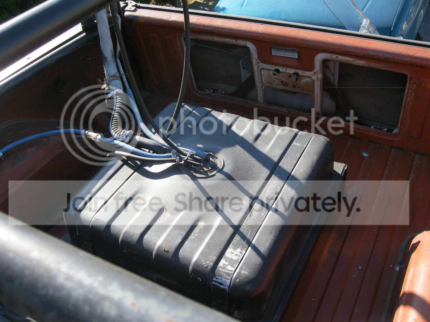

relocated the batteries to the bed

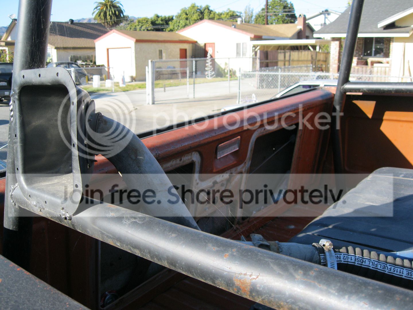

finished mounting the fuel tank in the back also

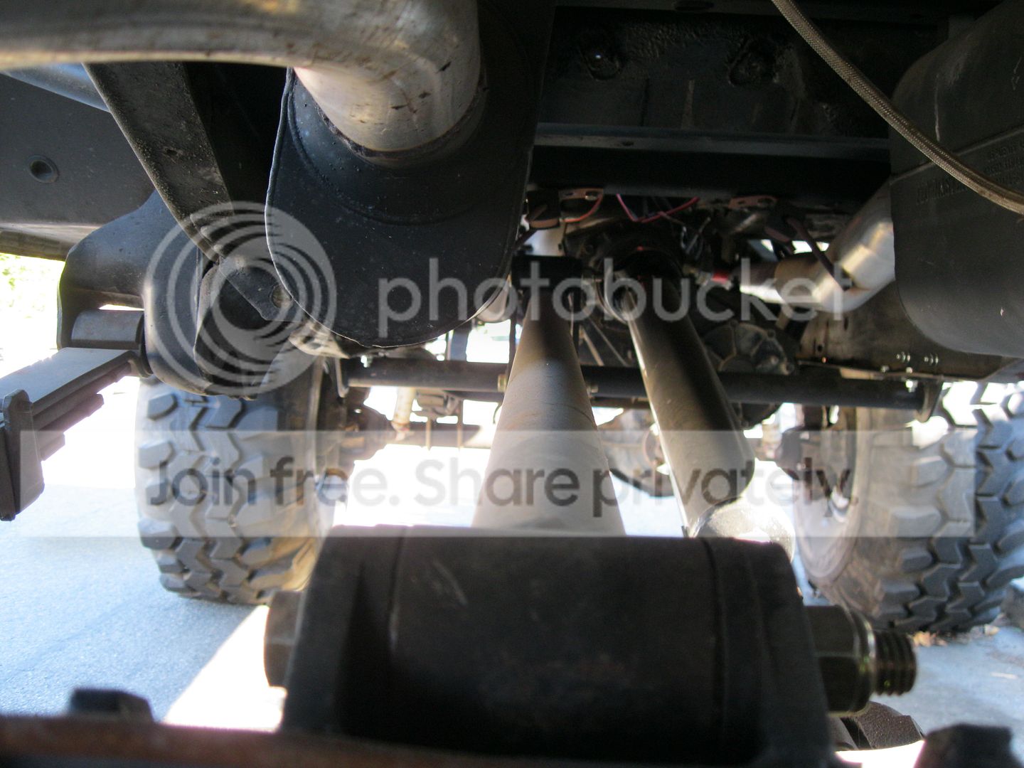

Pics of the fuel filler (leaked like it had no cap on steep inclines)

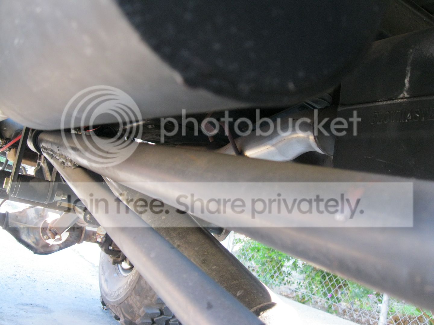

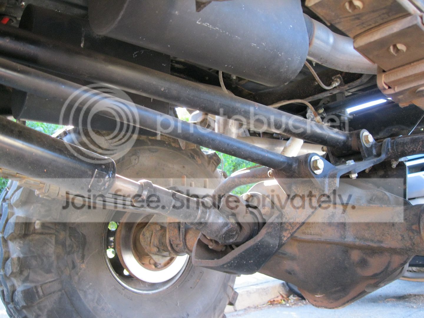

Wraptor was a bit tight to the muffler
barely touches, you can see the rub spot on the right side of this pic.
