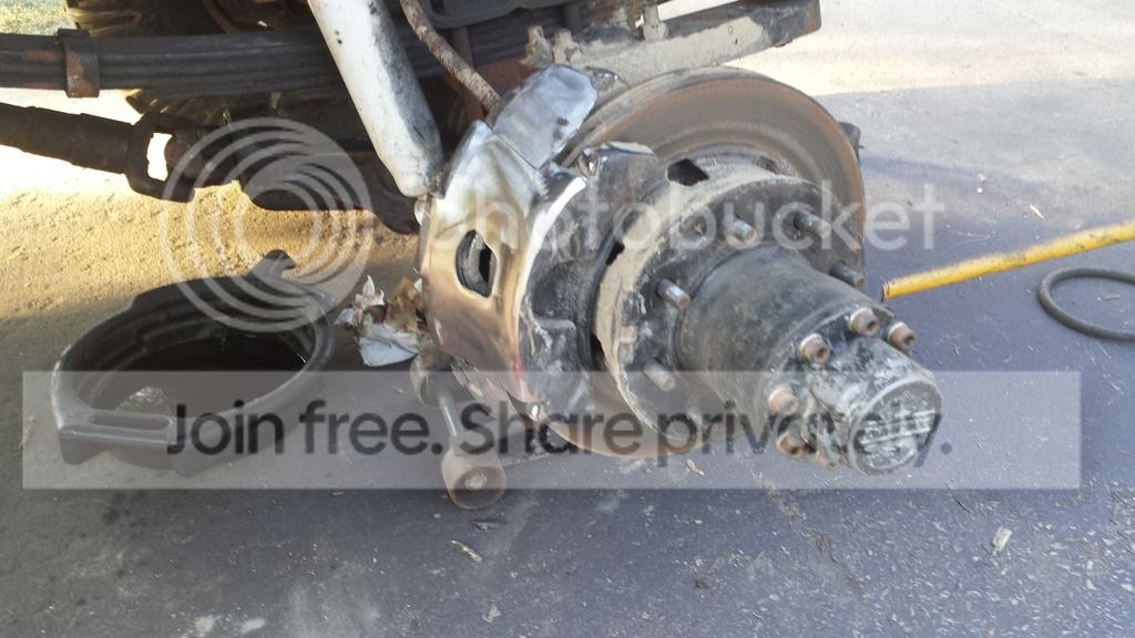

Got one of my calipers ground down. About 3 hours into this one. Will do the other side tomorrow, shouldn't take as long....I ground this one a little more than I needed to.

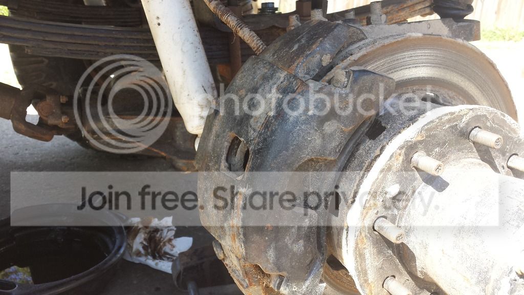

Before. Drain pan is there because my oil pan leaks. It leaks through the actual pan. Didn't do it yesterday when I had it running, but when I pulled it onto the driveway today it had a puddle growing under it. I have another pan I will swap on.
After. I only really needed to grind on about half the caliper/caliper bracket. But it looked like ass with the giant ridge in it so I decided to blend it. I'm running a Dodge axle but I believe GM D60 brakes are the same. I have enough clearance for when the caliper moves and for when I put some new pads in.

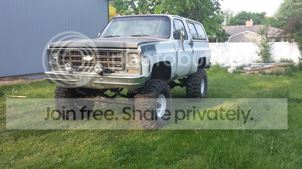

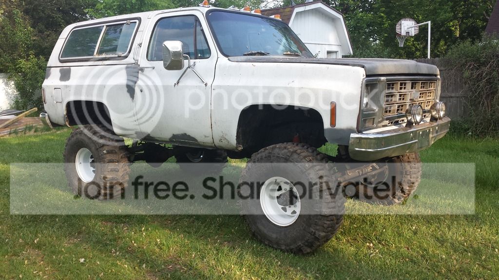

Spent the evening after work yesterday grinding on the drivers side caliper. Right about 3 hours into that one too. Mounted up the Boggers on the new wheels after that. Decided to put all four on the Blazer.

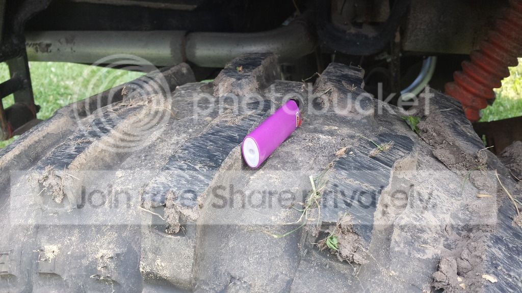

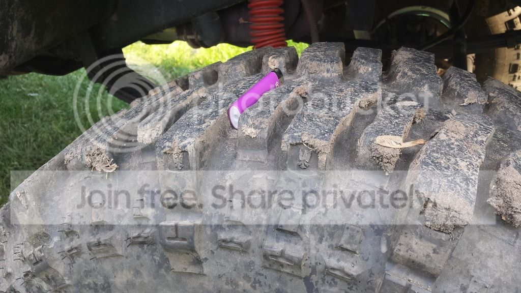

For reference on how much tread there is. Standard BIC lighter.
Lookin' good. Been a while since I saw a set of good ol' white wagon wheels. There has to be an easier and quicker way to get the calipers down to where you need them to mount 15" wheels. I just don't know what it is. :dunno:
There probably is a faster way. I was using a 4.5" grinder. If I had borrowed the 7" I could really lean into it and it probably wouls have gone quicker. But...it's done now and I won't have to do it again

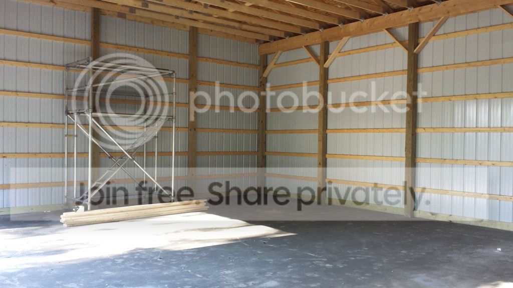

Poured the floor Saturday morning. Good news and bad news with it.
We got about 2" of rain the night before, so I wasn't sure that we would be able to do it or not. It stopped raining around 3am Saturday and about 8am the first truck showed up. The ground was already pretty soft and sloppy back there with no topsoil left. First cement truck made it back just fine and started sending the mix down the chute. When it came time for him to back up some....he started spinning and sunk in. Even with all 6 drive tires locked in he wasn't going anywhere. Luckily the second truck had shown up and was able to get him out. Took a few tugs but eventually he came out. The second truck didn't have any problems, he was able to stay on firmer ground.
That was the good news (when the good news is a cement truck getting stuck...that bad must be brutal).

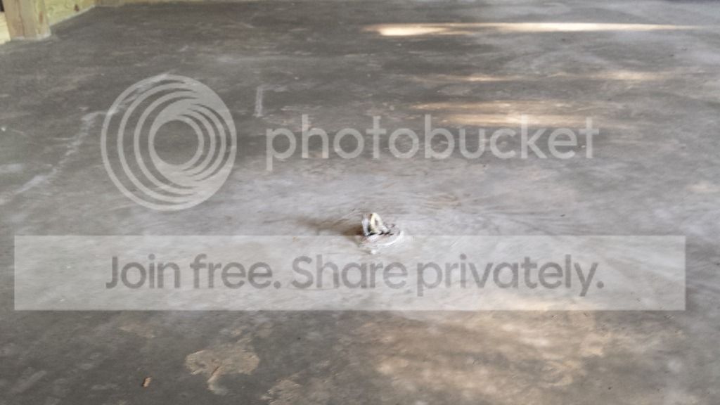

I had bought some anchor pots to install in the slab while we were pouring. Only two of them, one centered in each bay along the back wall. Just something to hook a winch/come along to so I could pull a dead vehicle in. We got the floor down, screeded and floated out. After it had set up a little, just as we were about to power trowel, one of the helpers went out to put in the pots. I figured he knew what he was doing and wouldn't have any problems. By this time it was starting to rain fairly hard so the rest of us were busy getting some plastic on the doors to prevent the rain from coming in. It was also around this time that I had to take off and get ready for a wedding that afternoon, so I left and let them finish. Come back from the wedding and it was dark, plus I had been up all day, was tired and had to work at 7am the next morning....so I didn't go out and look at the slab. Get home from work Sunday and head out to check it out. Walk in the man door and start looking around. Floor looks beautiful, finish looks great. Glance over at one of the anchor pots and notice it doesn't look right. Take a closer look and........he put it in up side down! Up side F-ing down! I was so pissed. Nothing I could do about it at the time either.
After I calmed down some I went back inside and called my dad. He works for the guy who was in charge of the pour/finishing and is a good friend of mine. Dad said he didn't notice it at the time and Bobby probably didn't either. We are going to have to cut them out and re-pour them. Which isn't a huge deal in the grand scheme of things, just hate to have had that happen. Tomorrow (Tuesday) they are going to saw cut the control joints and will cut the pots out. This weekend we are going to pour the approach in front of the building (4' out the width of the front) so we will have a load coming in anyway.

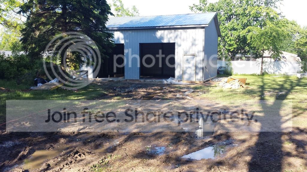

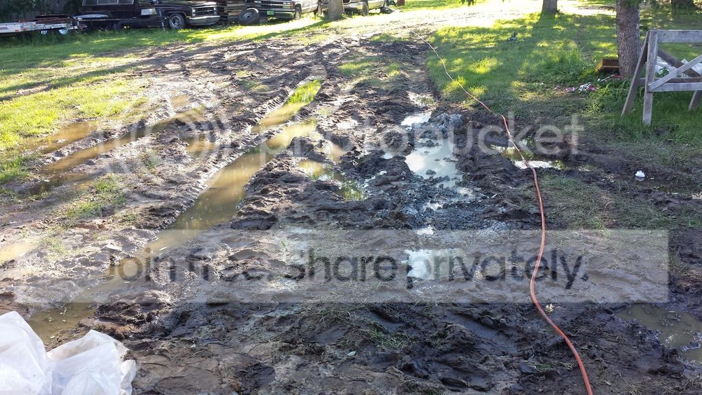

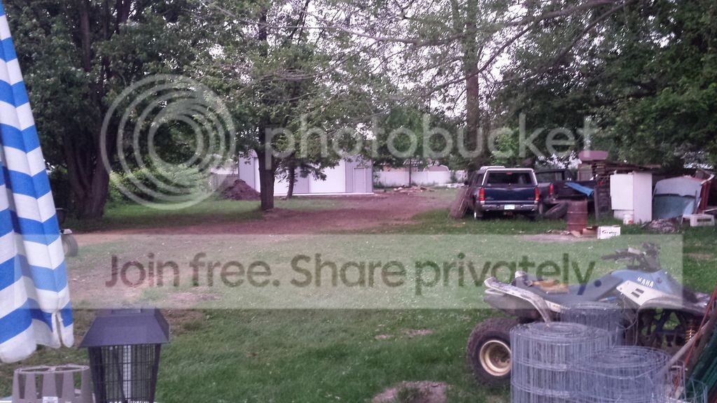

Yard as of today. Haven't gotten any rain since Saturday...still sloppy.

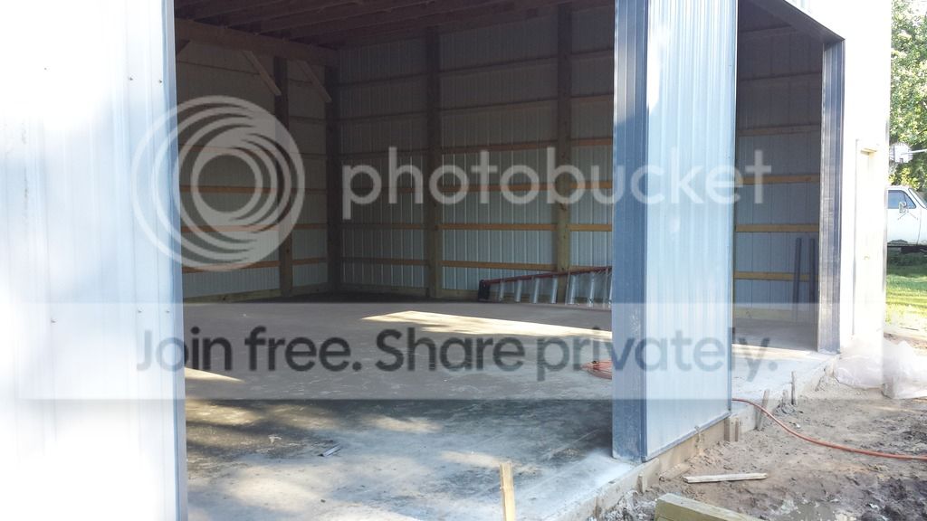

From one of the big doors looking out.
From the man door.
Other corner.
Upside down anchor pot. Why he thought it went this way...I have no idea. Maybe the nice flush cover of the other side wasn't clue enough. They aren't flush with the floor either (about 1/4" up), which I could have lived with had they been installed correctly. I will make sure they are installed correctly and flush this time.
Man that sucks. Oh well. At least they don't have to redo the whole floor. You're almost done.

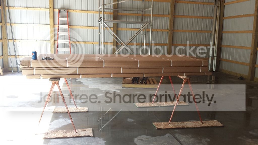

What I came home to Monday night. Door panels on the stands. Floor is wet because they had cut it earlier that day. I made sure they didn't make any cuts where the hoist will be going. Can sort of see the square cut out where we had to remove the upside down anchor pot.

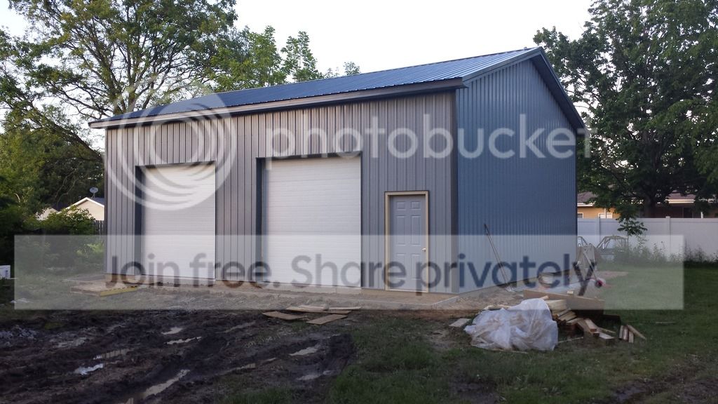

Doors installed and working. Still need to put up the vinyl weather strip around the openings. Have to get some filler metal to fill the gap that the darker grey metal is short though. We have enough scrap left over from the roof panels that will work.

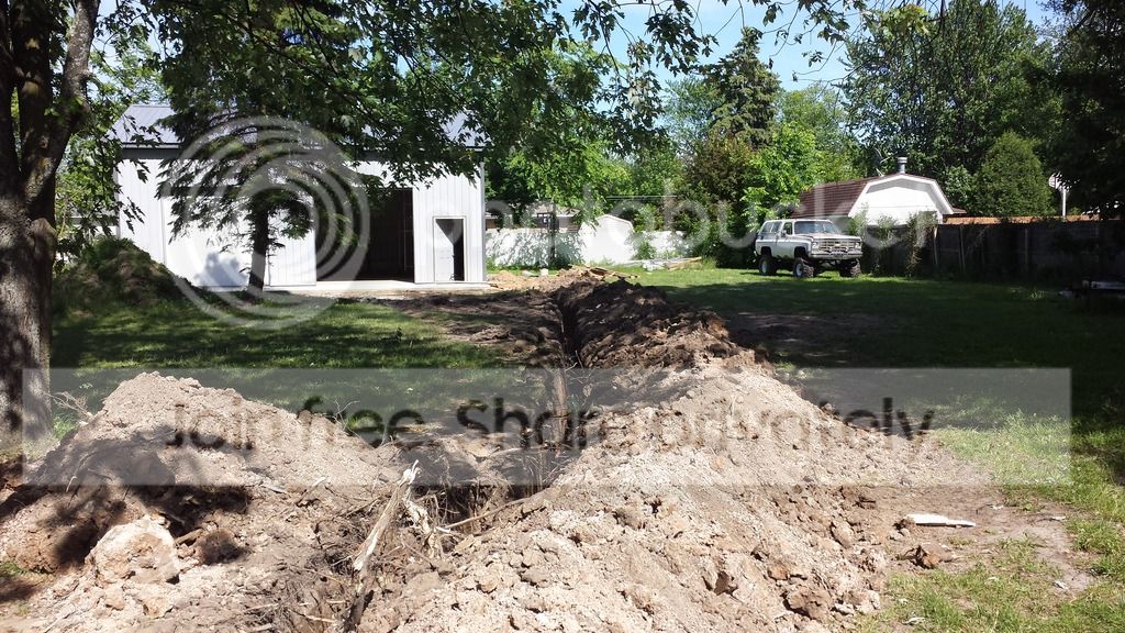

Made some decent progress the last two days. Have some pictures, will post them when I have more time. Dug my trench, ran the power/water/air lines. Back filled and smoothed out the yard some. Will finish hooking up the electric tomorrow, need to pick up a few things before I can glue the conduit.

Finished up most of the barn electrical service today. Glued my conduit, drove my ground rod and picked up the ground bar kit and neutral lugs I needed. Just need to trim the wires and pop the breaker in on the feeder. Knocked down the high spots on the area I dug the trench in too. Maybe tomorrow I'll get time to finalize everything.

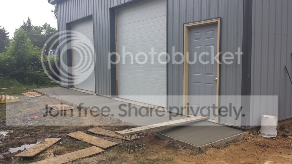

The approach they poured on Friday morning. 4' out the entire width of the front. Came out looking good except a bird decided to jump all over the wet concrete so now I have a bunch of bird prints in it. O-well...not a big deal.

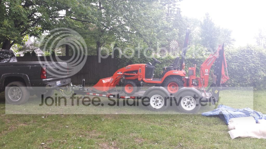

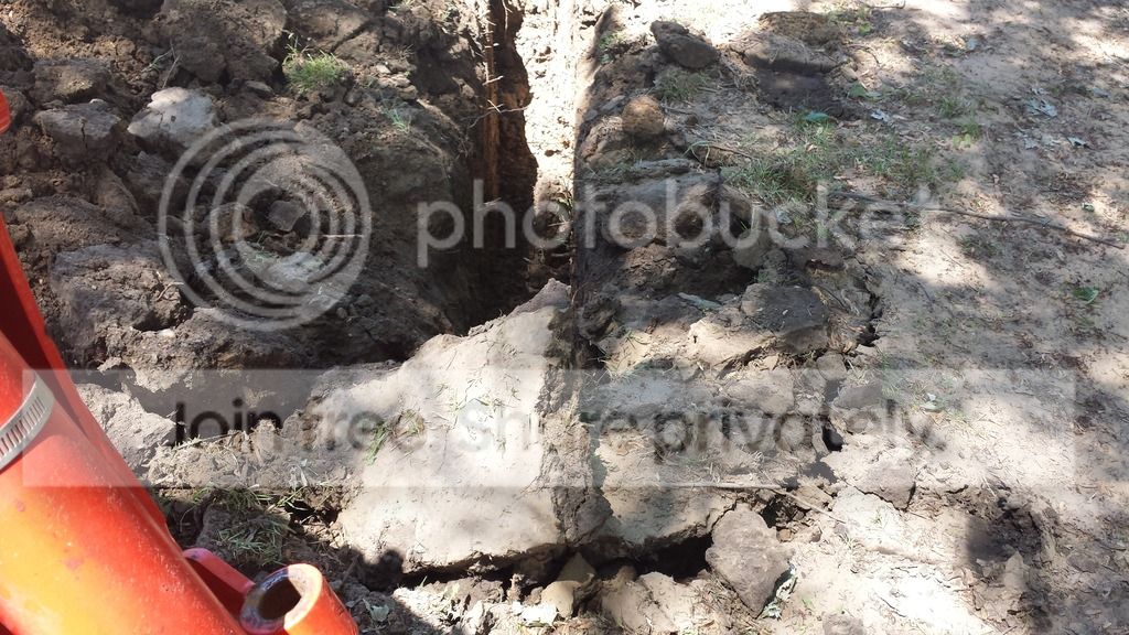

This followed me home after work on Friday. Made digging the trench easy. Went down just over 4' deep with it.
The areas that I've been driving over for the last 15 years or so had gotten super hard and compacted. Was coming up in sheets.

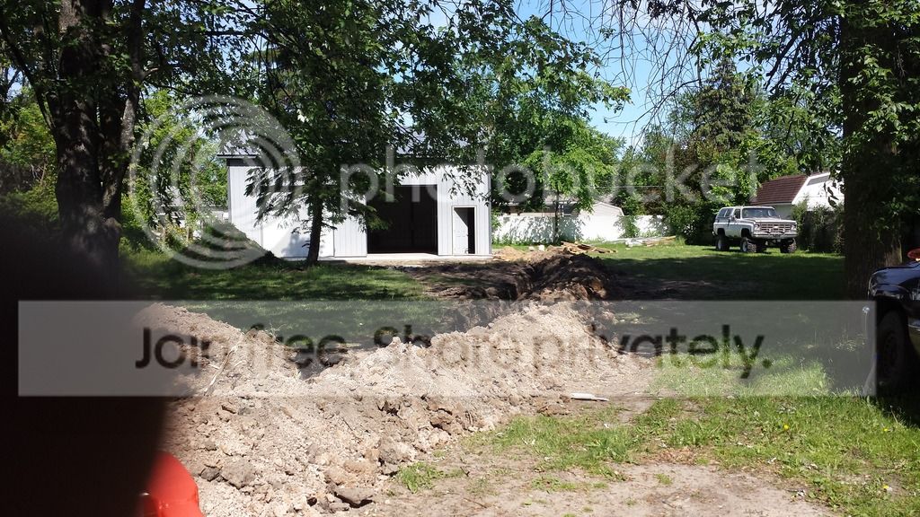

Little over half way done. Ran into some roots between the tress. Little tractor dug them just fine.
View from the edge of the patio. Used the 4wheeler and a box spring to knock down the high spots and smooth it out. Need a good rain and then I'll hit it again.
