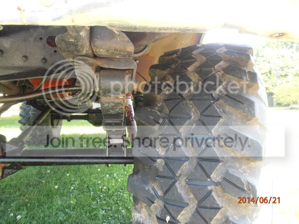

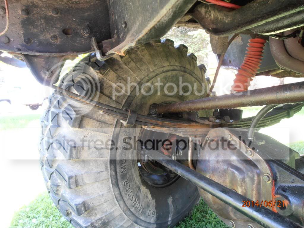

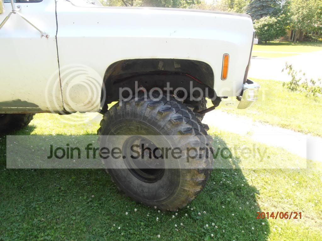

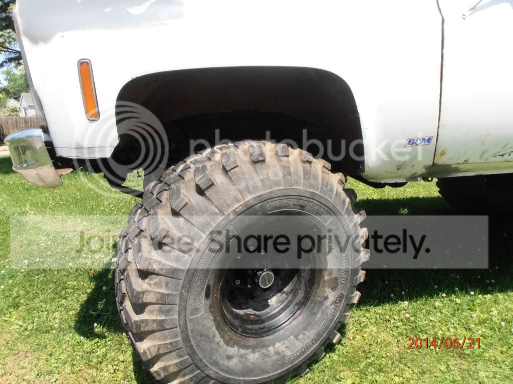

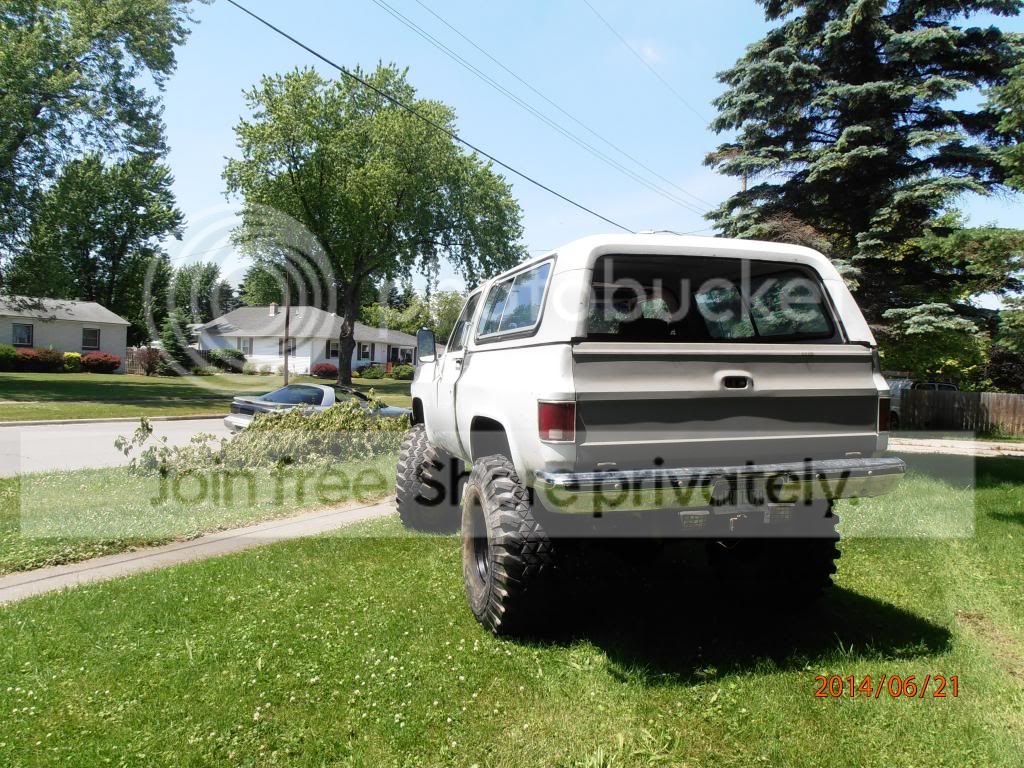

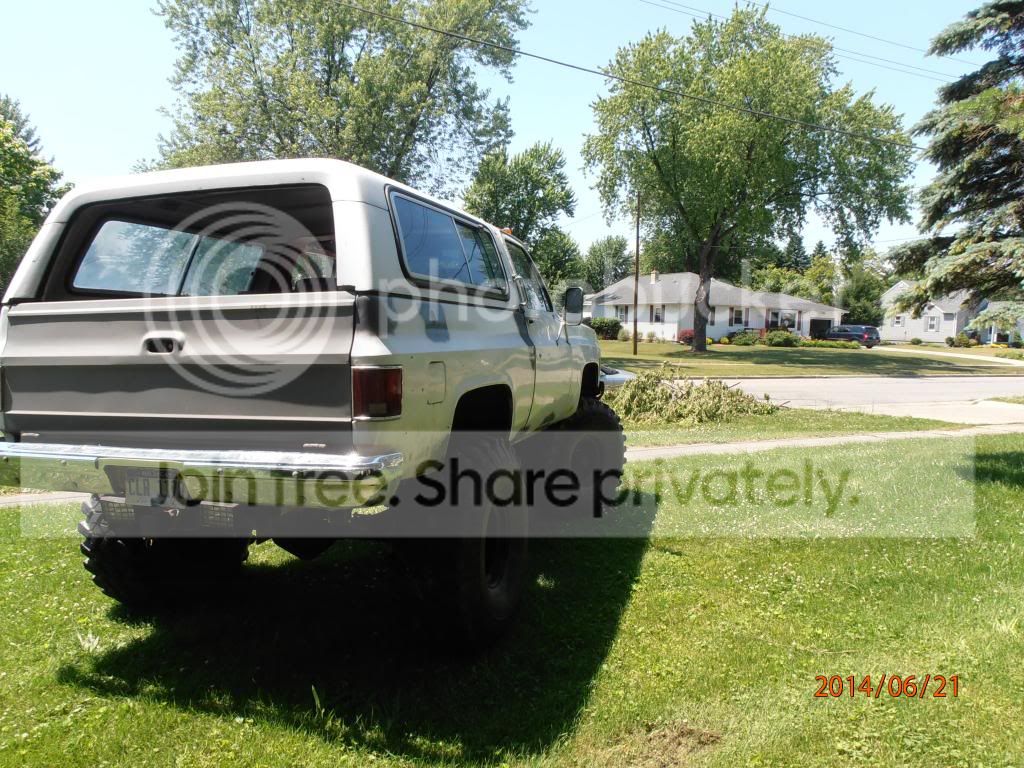

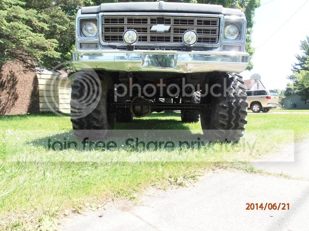

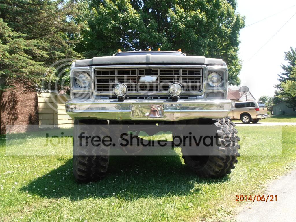

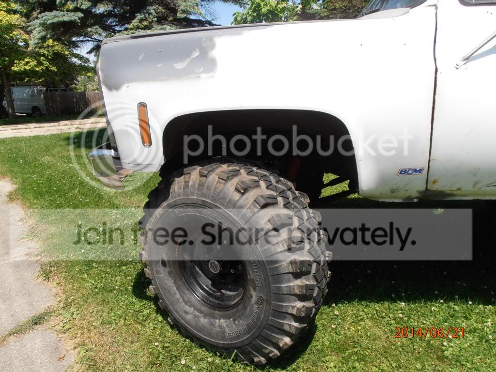

Front fenders are trimmed in the front. Got my front drive shaft built and in. Brakes are bled too. Saturday I should have time to go around and tighten everything and take it for a test drive. Have to find something to flex out on to see exactly how much I'll have to trim the rest.

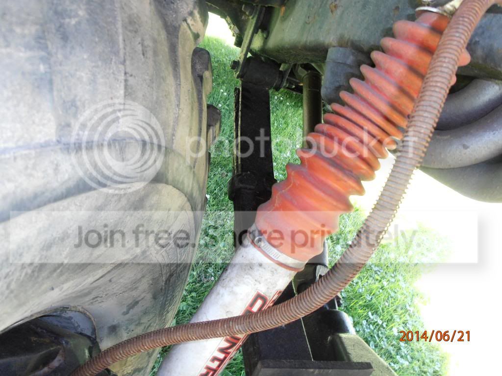

Everything is tightened down and went for a test drive. Still have to cut the rear of the front fenders and do the rear quarters. Found my steering box leak...the seal at the sector shaft. Need to adjust the drag link, turns farther to the passenger side than the drivers. Also need to get a steering stop on that side, I can get the tire to hit the spring at full lock. Crossover steering is sooooo much nicer than the stock setup. I can turn the wheel with one finger on pavement where I had to really muscle it before. On the hunt for a box brace now. Brakes need bled again. First couple stops sucked after they pumped up they were ok.

They actually ride fairly well. I'd say as good as my 38's or slightly better. Was a bit surprising. I expected them to be out or round/balance. I won't be running them on the road so ride quality isn't a high priority for them. I did pick up a set of stock 16.5's to mount the 37's that I found.
The 44's have got some weather cheacking but I've run worse. They have a decent amount of tread left...and have been grooved. The insides of two of them are chunked up where they've hit sheet metal before. Should work fine for what I want to use them for. I did a couple 2nd gear 5,000rpm clutch dumps in the backyard a few minutes ago and they hooked up awesome. Hookin-n-Bookin!

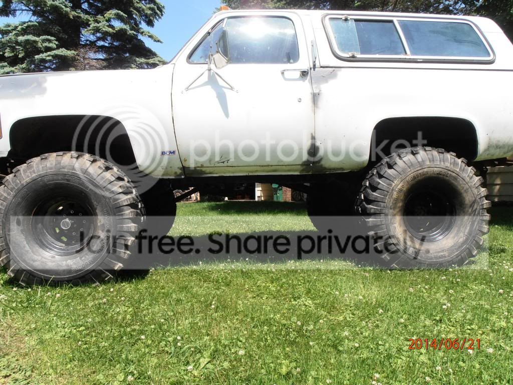

I plan on it. Have a few set of caps I've saved from parts trucks. Did that on my old 87 K5. 37" military tires and stock wheels/caps.

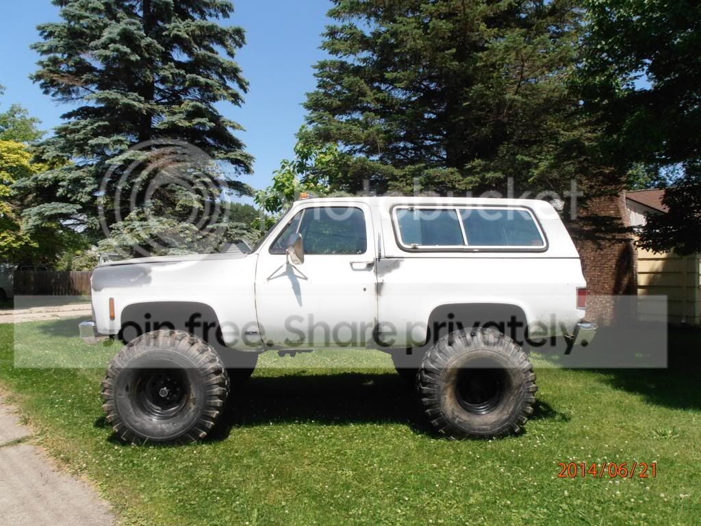

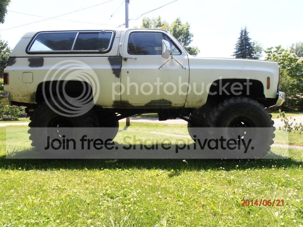

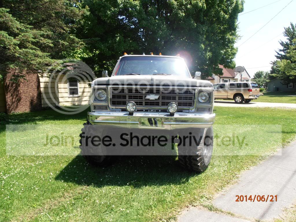

That is looking pretty good. I even like the paint. Has that little bit of attitude about it.
Thanks! The grey areas are where I wheeled some of the rust off and hit it with whatever rattle can was close. I think it helps break the white up a little. Makes it look less like a rolling refridgerator.

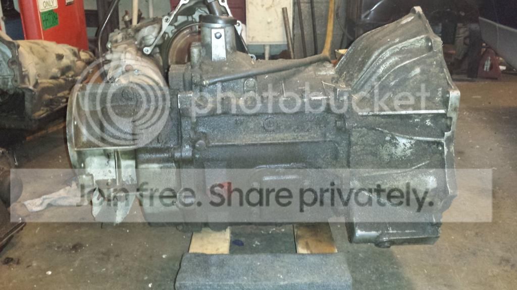

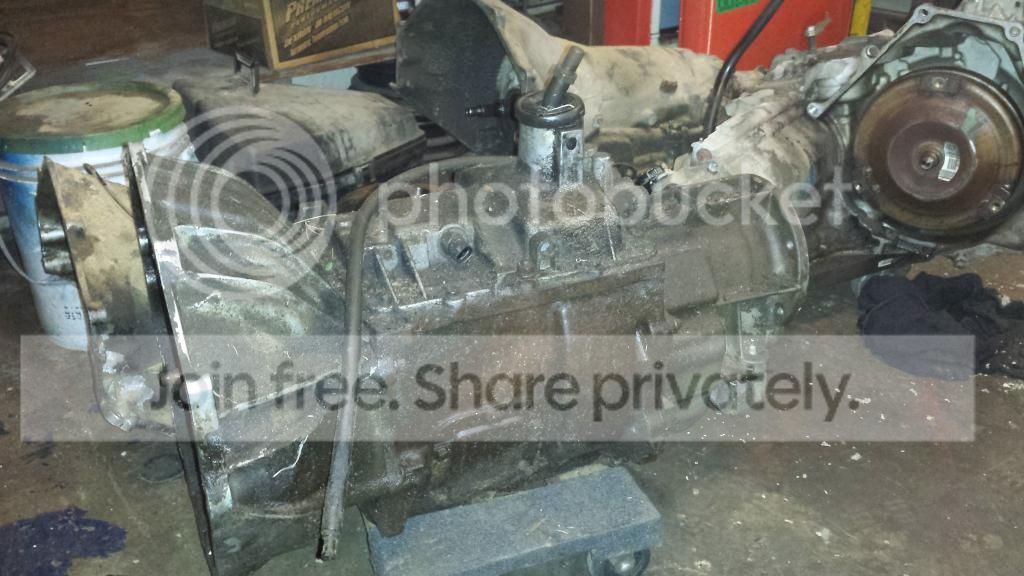

Now, the real updates. I got a line on a Nv4500 for a good price. $550 for the trans, bell, pedals, master/slave, 2 clutches and a few other small bits. Not sure what year it is, but I know he was gathering parts to put it into a square body, so at least the pedals are correct hydro parts. Will need to find a 208/241. Probably need to modify the driveshafts too.

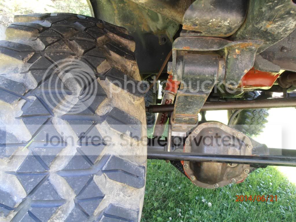

Other things to address. Steering box still leaks, from around the sector shaft. I've got another one to put on, but my is drilled for hydro assist....which I'd like to do in the near future. Somehow the nuts on the pass side of the diff came off. Not sure how, but they're MIA. Need to either find new ones or pull the studs and run some bolts. Still haven't gone to disc's on the rear, even though I have all the parts sitting in the garage.

I was under the impression that the guy knew what he actually had. Turns out, he didn't. I went to look at it and knew right away what it was. He had an NV3500/241 out of a GMT400 truck. After arguing with him for about 15min I finally got it through to him what I was looking for. He made a few phone calls and surprisingly enough was able to find one in about 10minutes. It's out of a 93 one ton.
I'm not sure when I'm going to swap this in. Still need to come up with some hydro pedals or decide if I want to mod my current bell to work....or buy the AA bellhousing. I know where there is a round pattern 205, I sold it to the guy a few years ago and he still hasn't used it. Might be able to buy that one back, or hunt for a 208/241.

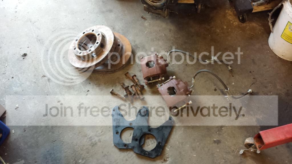

Finally getting around to doing the discs on the back of the blazer. The calipers/lines/pads are new, just surface rust from sitting. The rotors are off the 10B I took out. I've got all 16 dually studs....just didn't include them in the picture. Sometime in the middle of the week I'll pull the K5 up and switch things around.

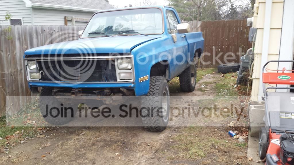

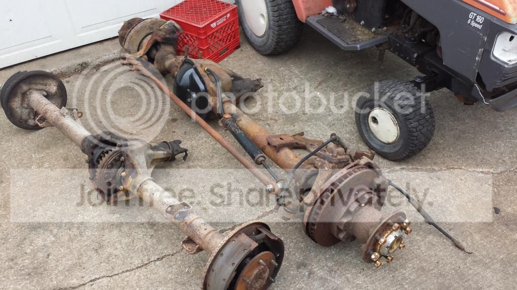

In other news...I'm working on my cousins truck, swapping in a D60/14Bff for him. I sold him this truck a few years ago and it just sat. He drove it maybe a month before breaking the rear axle. I've been pestering him to buy it back, even offering more than he paid. The axles he got are from a dually (where I got my studs for the discs), so he needs to track down some SRW hubs for the front. But for $600 it wasn't a bad buy.

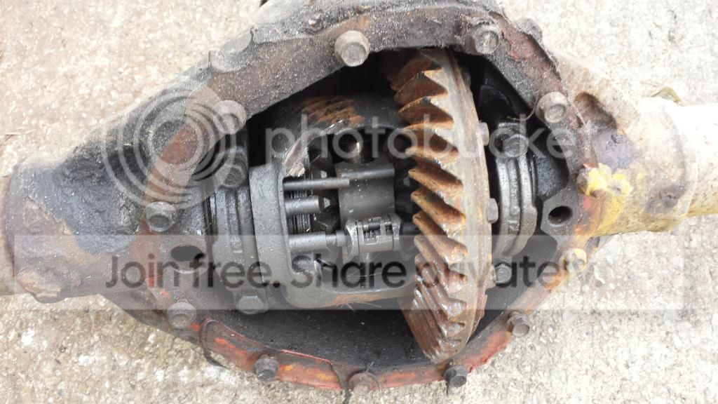

I already swapped the rear axle in this picture. Had to move the perches. You can see how far the wheels are in, the stock wheels don't help either. On the plus side I'm getting the 35" BFG Mud Terrains on the hurricane wheels as part of payment.
Broke 12B. He pulled the cover about two years ago to see what was wrong, never put it back on. The passenger tube had also broken it's plug welds and was starting to spin. I welded the tubes on the 14B while it was out.
Dually D60.
