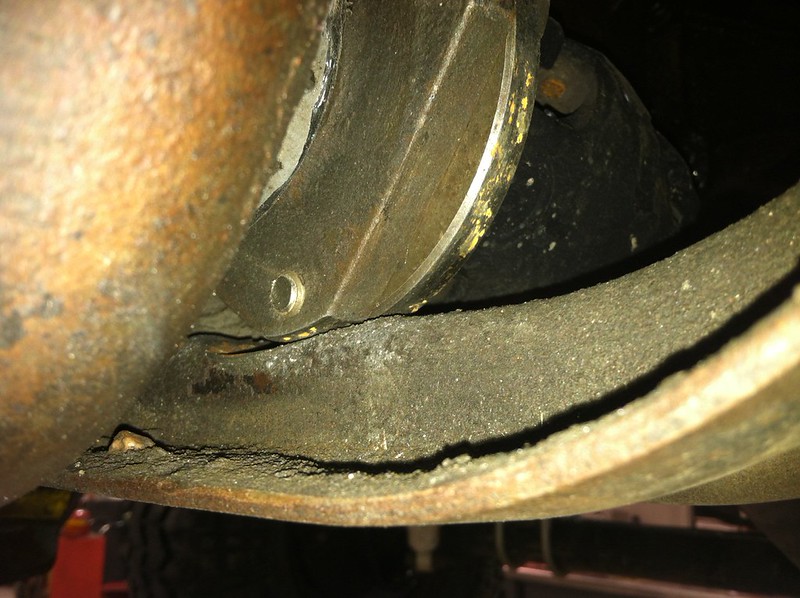

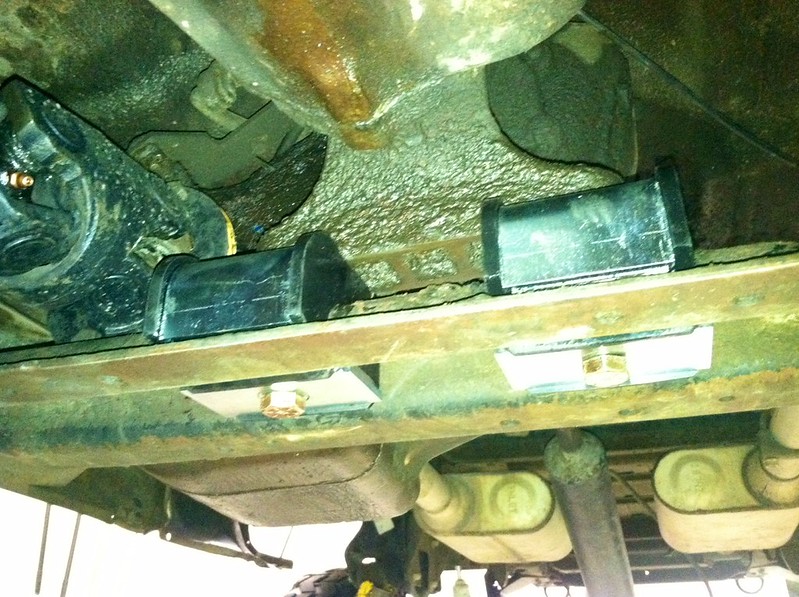

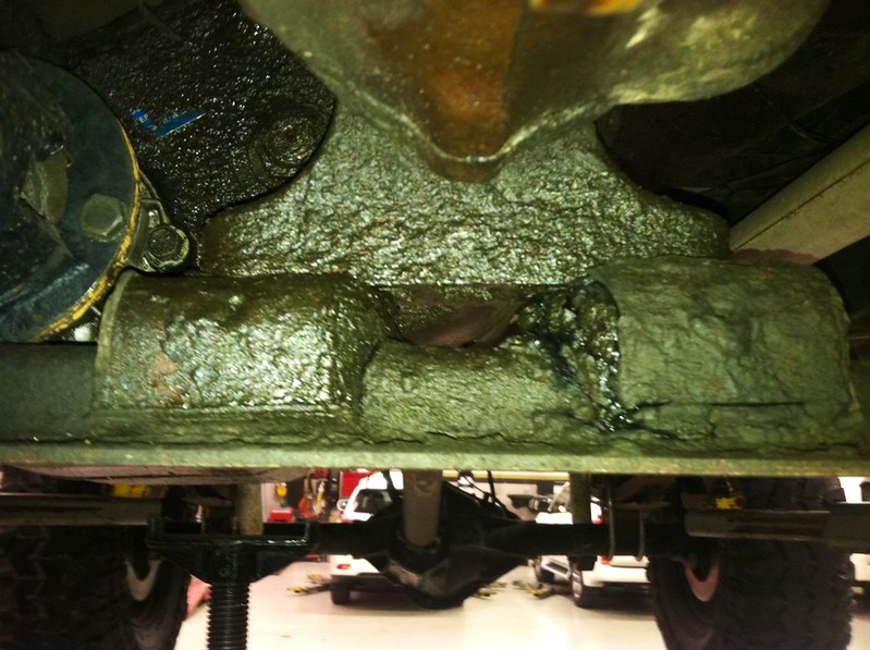

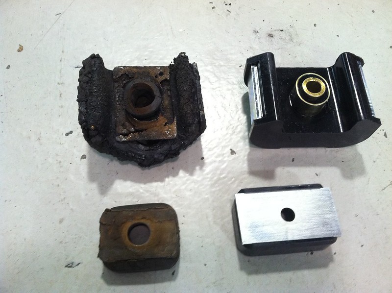

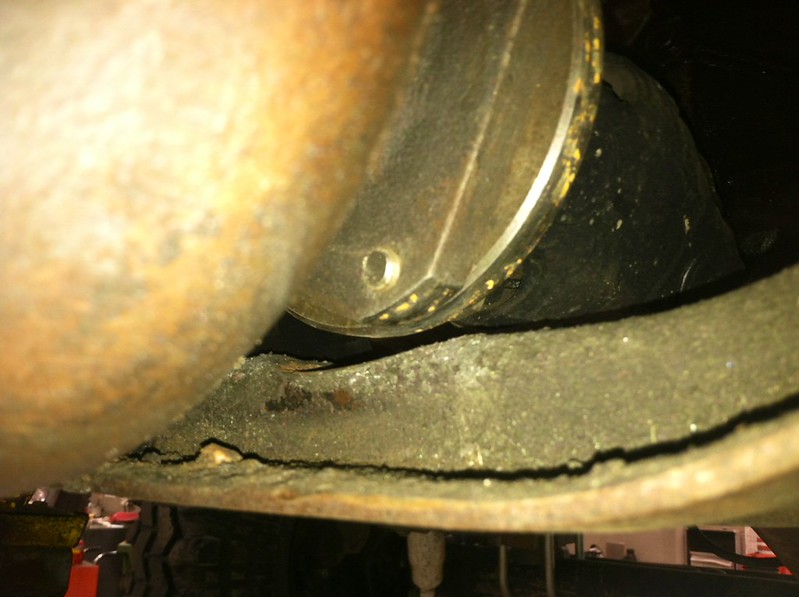

I finally replaced my tcase/trans bushings and I can't believe the difference in how much more solid it feels when driving now. The old ones were completely blown out and there was only 1 side bolted to the cross member. I tested it out in 4wd and the front driveshaft doesn't bang on the cross member anymore, so that is really nice.
Old blown out oily bushings
Just a nut hair of room between the shaft and cross member
I think they over-stayed their welcome
Back together with new bolts
Much more clearance now

That's exactly what I need to do. Where did you get them? What brand?
What's this I've heard about it not being a good idea to use poly transmission mounts with rubber engine mounts and vice versa? Seems like I've read on this forum that if you mix the two, something will break. Don't know if that's true or not. Are you running poly engine mounts as well?
Or those rubber mounts and I just don't know what a new rubber mount looks like because the only ones I've ever seen were old and crusty?
I got them from Offroad Design cause they were the cheapest I found and could get them here the fastest. They look identical to the Energy Suspenson ones so i'd guess that's what they are.
They are poly mounts and i've never heard anything about that. So if someone who reads this knows more than we do, chime in.
Im really glad I replaced them though. Night and day difference.
I run poly tcase mounts and rubber engine mounts and never been a problem. Honestly my engine mounts the big bolts don't even go through the sleeve, just slide in a gap between the rubber and the shell. Frame was bent and they wouldn't fit. Ran it like that for years and never had a problem except some vibration in the steering wheel. And I'm currently fixing that as we speak, as getting it stuck and yanking on it with a trackhoe bent the frame in the opposing direction, allowing new motor.mounts to finally fit.
Yeah I'm kinda thinking that someone somewhere may have had a motor mount break on them and thought that maybe it was because they had poly transmission mounts and then someone else heard about it and told somebody and then they echoed what they'd heard and then before you knew it, everyone was accepting it as the gospel truth even though they had no personal experience and were just going by what they had heard somewhere. That's why I kinda hesitated to mention it at all.

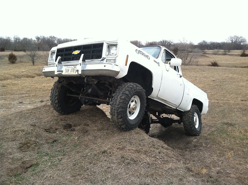

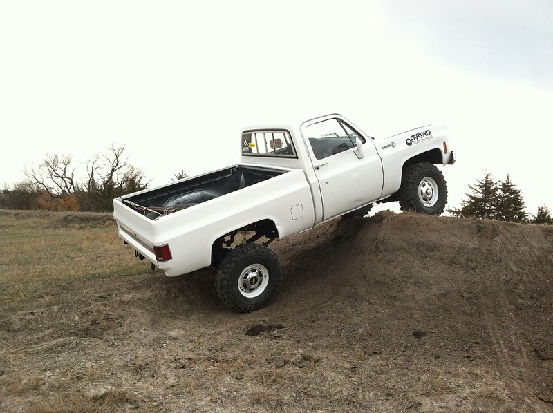

Nothing new here, just a little pic whoring from yesterday.
Once I parked it on this ledge, I let my buddy take the wheel for a bit.
He thought he was going to roll it here
He took the easy way out
The good side
Before I had a locker in the rear and a carb that worked good, these two spots of this big ledge were impossible. Now, i'll let the very short videos do the talking...
