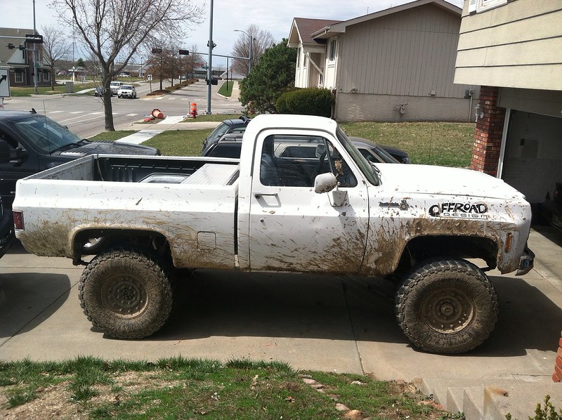

Took the K10 out to my buddys farm this weekend for some testing. Found out my front driveshaft is too long and bottoms out sometimes, so that has to come off and get shortened. Yes I have to shorten my shaft. The truck is a new animal though, holy crap. Just crawls up anything in its path (unless there is mud/clay in the tires) :doah:. Can't wait to get it to Tuttle again.

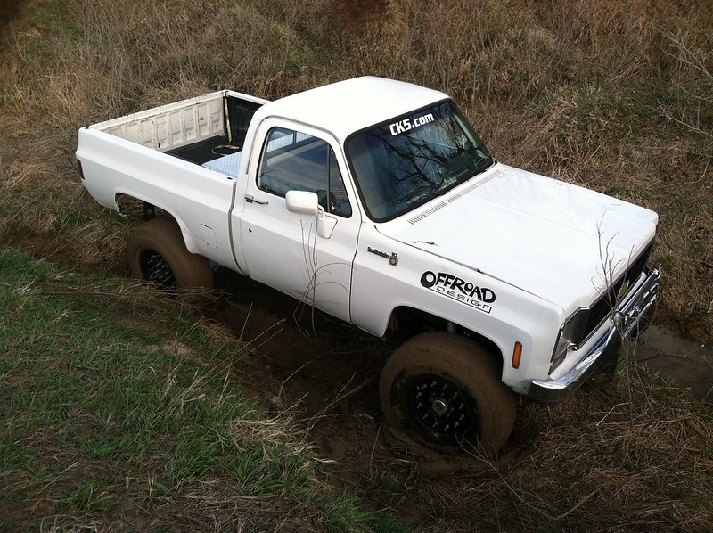

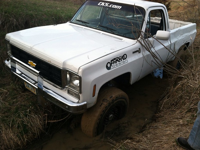

So here I was driving along the (what I thought was dry) somewhat dry creek with no problems until I park the 60 on this giant mound of dirt I didn't see coming.
After that, it didn't move an inch without a tug from HINZ28's Duramax.
I finally get out of that mess, and continue up where I was headed to get out of the creek. "Hey you should go through it again, but the other way" OK.
This was the nastiest clay mud ever. It just packed everywhere and didn't clean out. I have spent 12 minutes at the power washer and its not even close to clean yet.
I HATE MUD
Beat the crap out of it and the only thing that gave was my front push bar.
Marty will be happy about this, although I'm happy I took it off. It looks so much better.

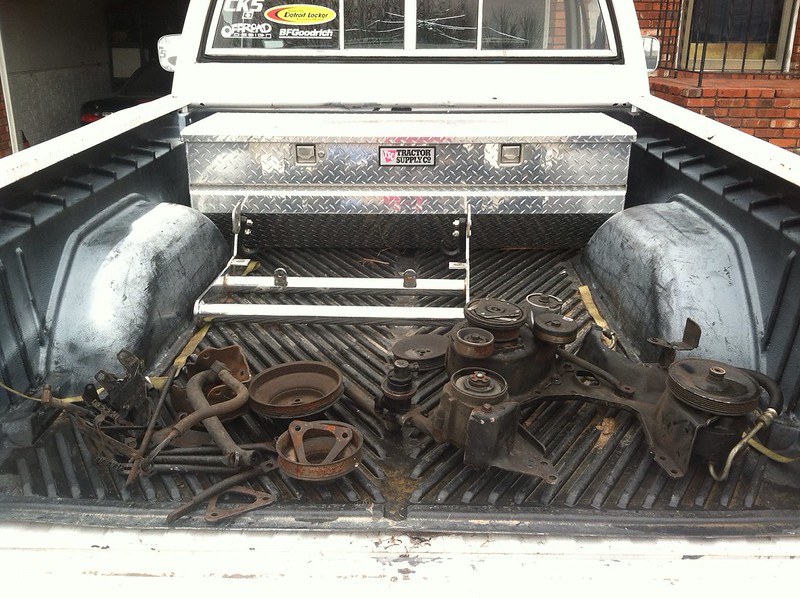

Got this for $20 including a alternator. I'll get around to it.

Who's spring plates are those on the front, and info on the serp setup ?
Can't tell you how much I hate mud after this. Power washed 2 times and still caked plus it has started to take new paint off :(.
Spring plates are from ORD. Serp setup is off a TBI engine and should be a direct bolt on.

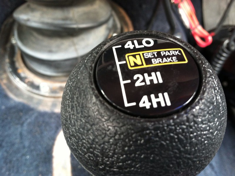

Also got this NOS 205 shift knob.

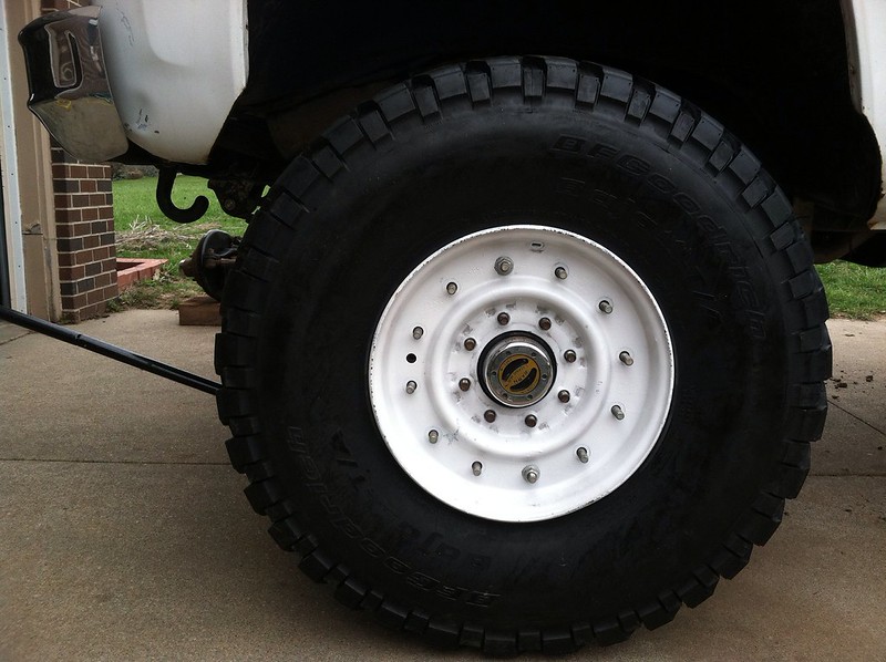

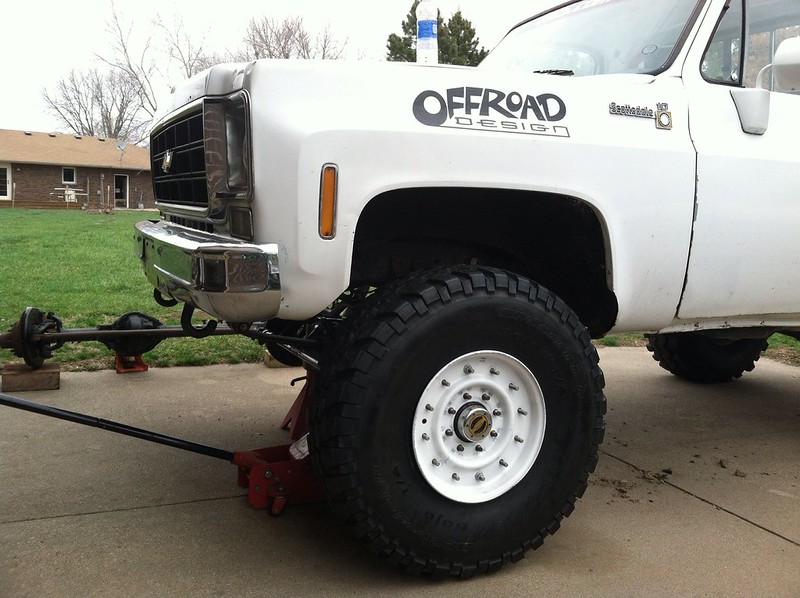

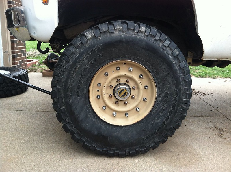

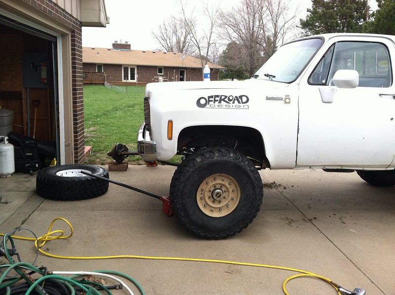

Now I want opinions cause I can't decide between white or black. I have pics of the tan, but it doesn't look right on a white truck.
The new bolts are black so that might look weird on white too.
White looks sweet, but black looks tougher.
