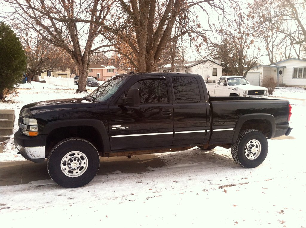

Got me a new tow rig/daily, 02 Duramax with 105k miles :D. Haven't touched the K10 in weeks... been too cold to mess with it.
How the fluck did you find a Dmax that clean?!?! *jealous*
I've been sorta looking for the right truck to come along for a while now. This one popped up on Craigslist and within 24hrs it was mine. I had to jump on it quick cause there were people in line! I am really happy with it so far.

Nice score :waytogo: looks really clean and low miles !!
Now set up a trailer and tow the K10 out to MI for the summer dune party :)
Good looking truck dude :waytogo:
Agreed on the trailer thing, but come this way to CO and come wheeling with me :D
