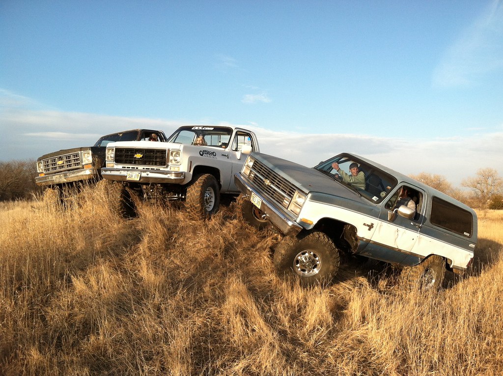

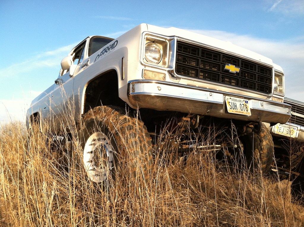

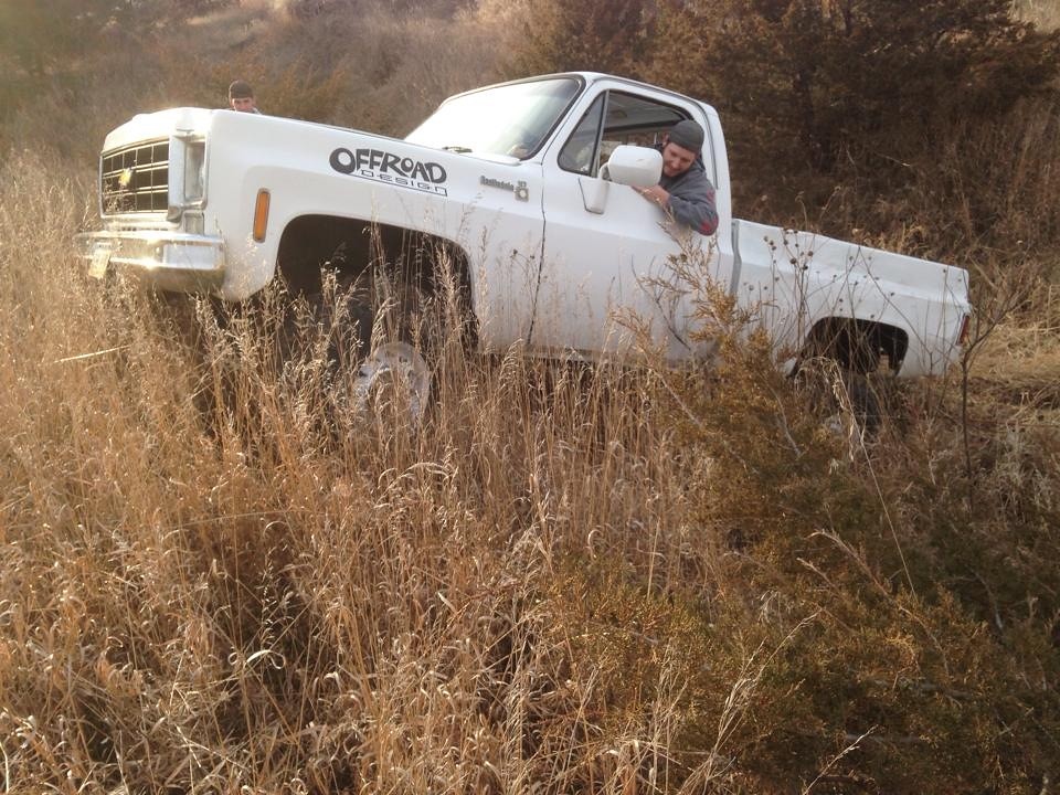

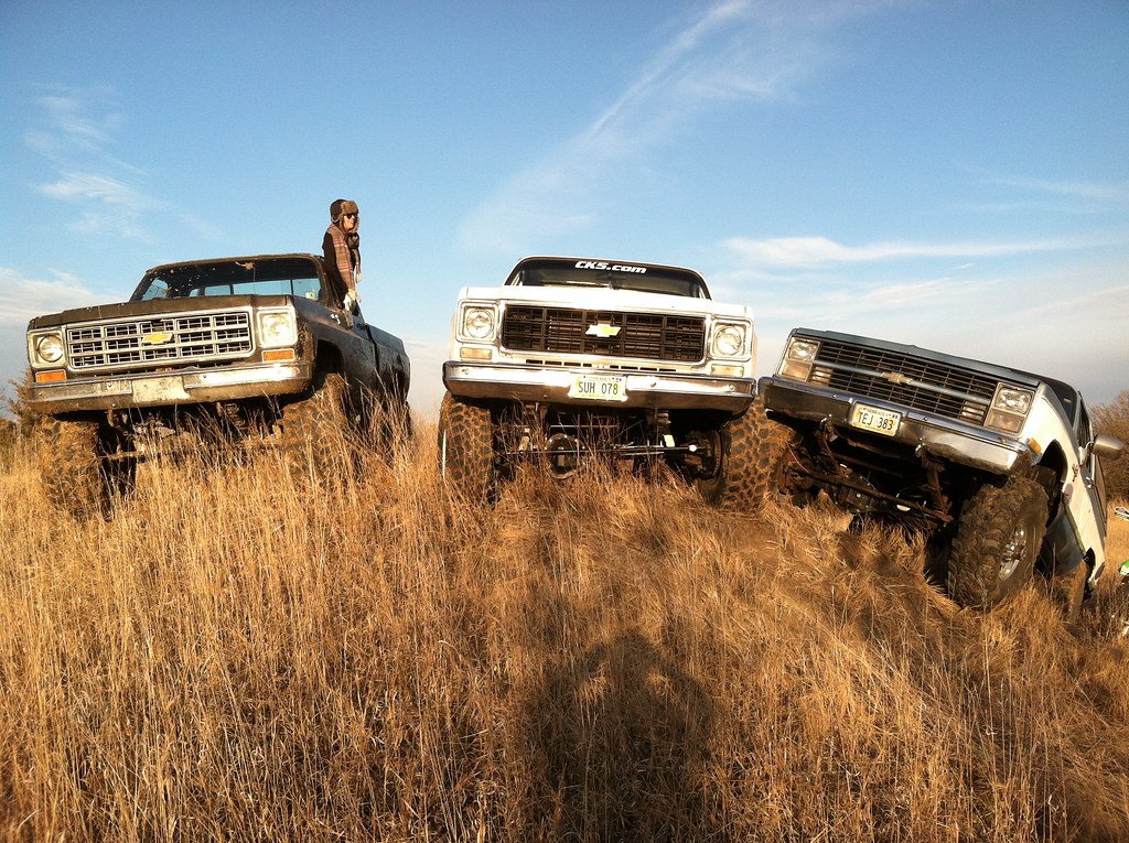

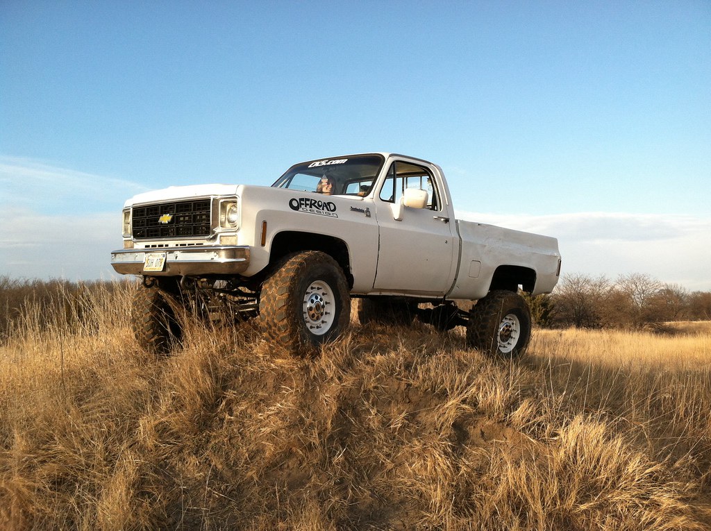

I guess I should update that the truck ran really well yesterday on its first offroad adventure since its been back together. I am really happy with the TBI and hydro clutch.
Few pics but some are the same as in HINZ28's thread.
Hard to get action shots out there.
