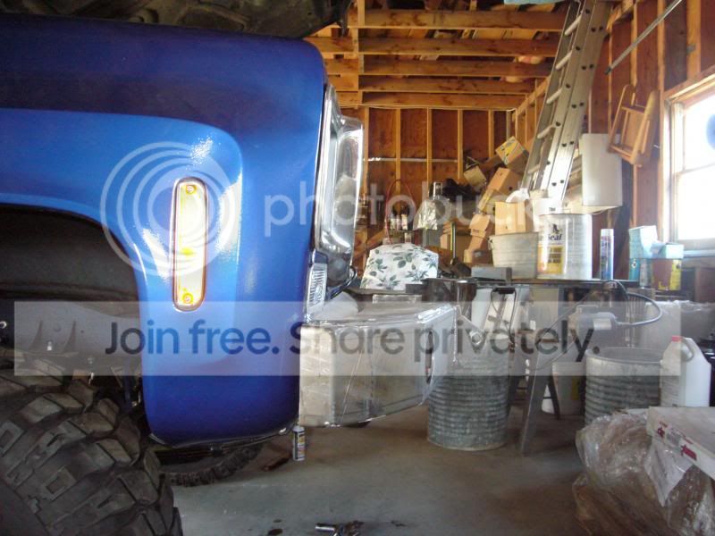

I'm guess from the pics that you used projectors with the HIDs? If so, any pics of the retrofit? I'd like to put some projectors on my truck one of these days.
That front 60 is pretty sweet, too. I imagine it wasn't cheap, though.
Thanks! Front axle wasn´t cheap, that is true, but there is a reason I went with this axle instead of rebuilding a GM D60. The high pinion has something to do with that.. more on this later in the build.. you´ll ahve to wait and see! ;)
As for the HID, NO RETROFIT!! These are factory HID units from Hella. They come factory assembled like that. (The Rolls royce Phantom uses the same lights). this is a totally legal, factory HID light, so no retrofit in an existing housing. The "cup" around the 90mm projector lense is a stainless steel bowl I modified to close the gap between the headlight bezel and the projector.

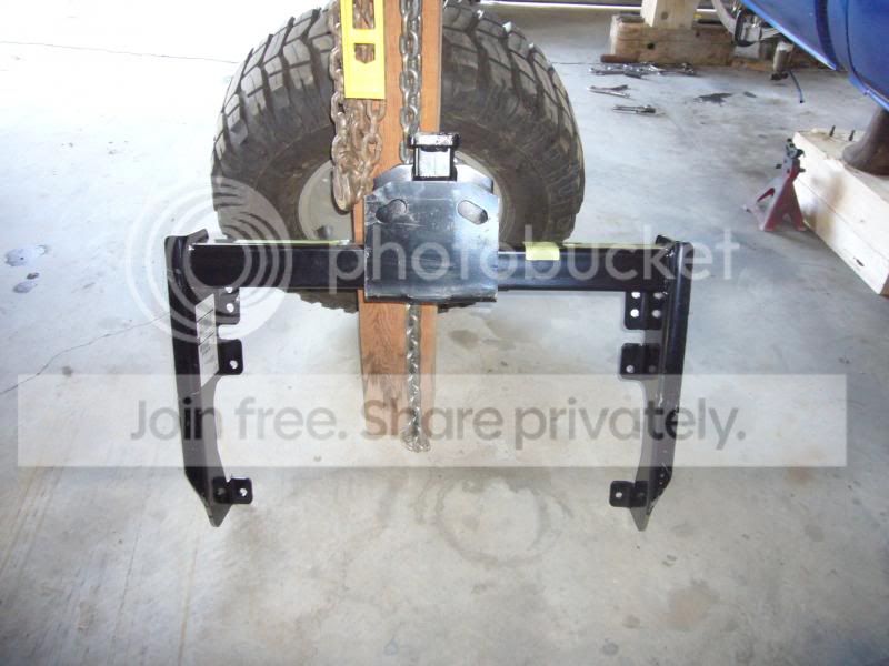

And the class V hitch that will be going on soon, together with a skid plate to protect the new rear mounted aluminum tank...

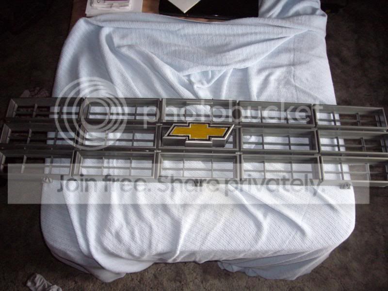

Sweet grille you gonna leave it grey? Or paint it black ? Either way gonna look good on the beast
My original grille is silver, but I always liked the dark grey ones. (it looks light compared to reality in the picture). It is too nice to paint it, besides, I like the grey myself...
I like black grills, mine is, but it would be a sin IMO to paint an nos grill....
x2, hard to get a NOS grill preiod, so I would never paint that, if I wanted to get a black grill, I would have just painted my original one.
