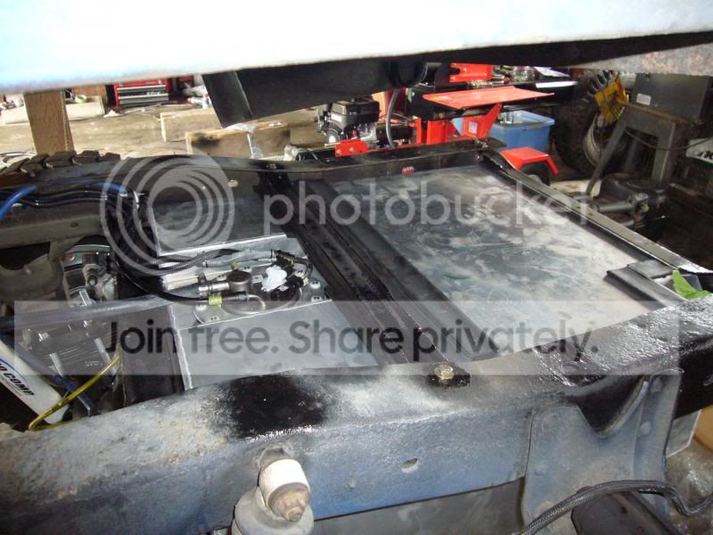

Here is the tank installed. However I might have to move it back a little because of clearance issues with the Mag Hytech diff cover and the tank at full bump.

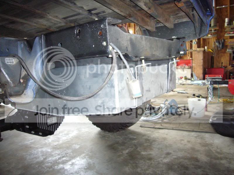

This is how the tank sits now. But I have to remove everything again and move the tank back to the very back of the frame rails in order to clear the mag hytec diff cover at full bump. The way the tank sits now, the cover will hit the tank about half way through bump travel.
The thing hanging on the wire is the rear ultrasonic load leveling sensor for the adaptive headlights.
I´ll also replace the aluminum tank straps that came with the tank with some stainless steel ones.
