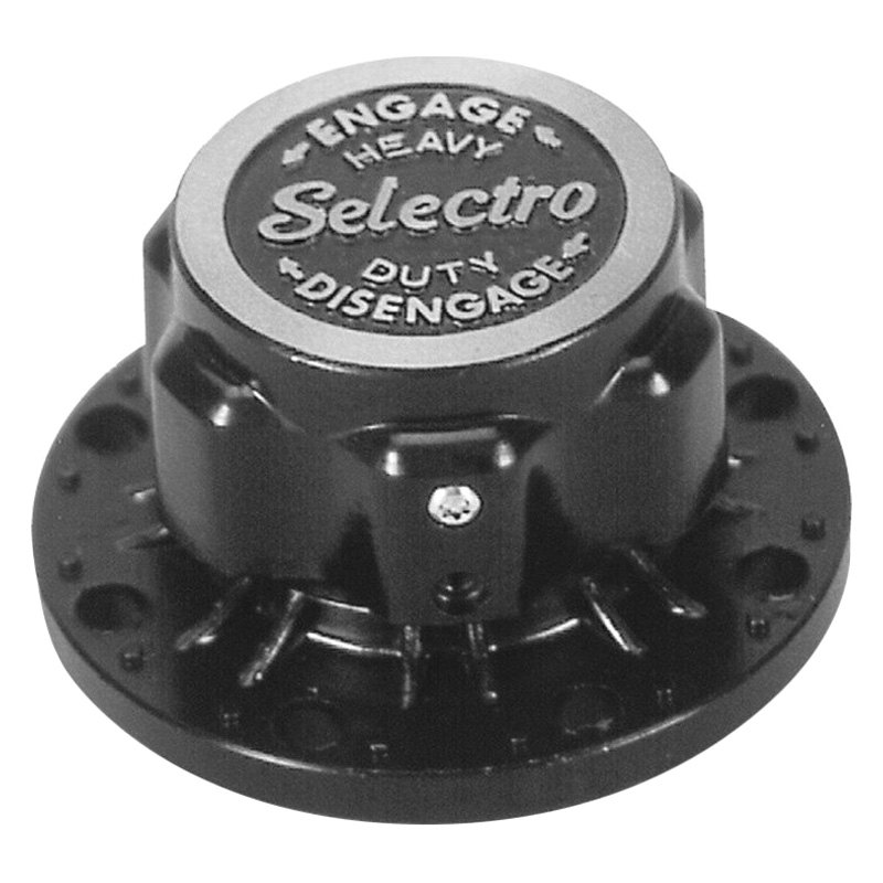

The locking hub diagrams you posted are for the external style, you have internal.

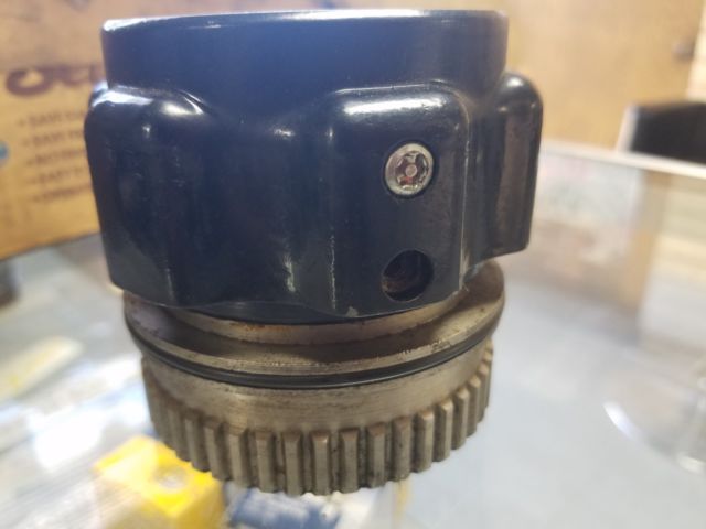

The D60 set is it own size, and is a separate tool from the 14bso its cruddy in there... I'm going to clean it out.. and repack. how much grease do you put in there? and just plain bearing grease?
also only cuz I haven't done one...
after I get that outer ring out and pull inners out.. I'm guessing the double nut and lock ring is in there? what size?
ive got the one for a D44 and 14bff... that is it... I'm guessing the D60 has a different one or does the 14b one work?
When you say repack, you're talking about the bearings, correct? I only ask because most of this has been about the locking hubs, they do NOT get grease. You can clean them good and maybe a coating of light oil but no grease, grease is too thick and can prevent the hub parts from moving correctly.
