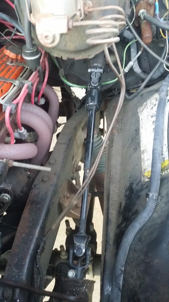

finally got that XJ steering shaft in that I bought YEAAAAAAAAAAARRRRRRRSSSSSSSSSS ago from a member here...
was super easy and went without a hitch...
My chevy had a jeep transplant by Jeffrey Riggs, on Flickr

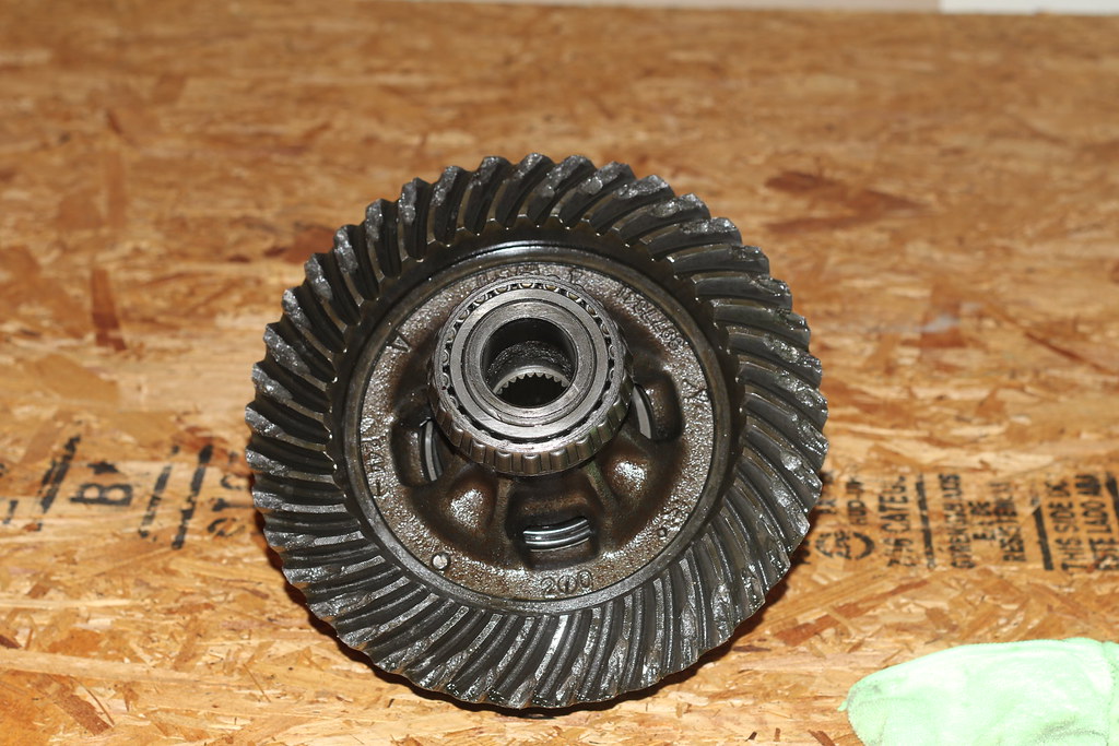

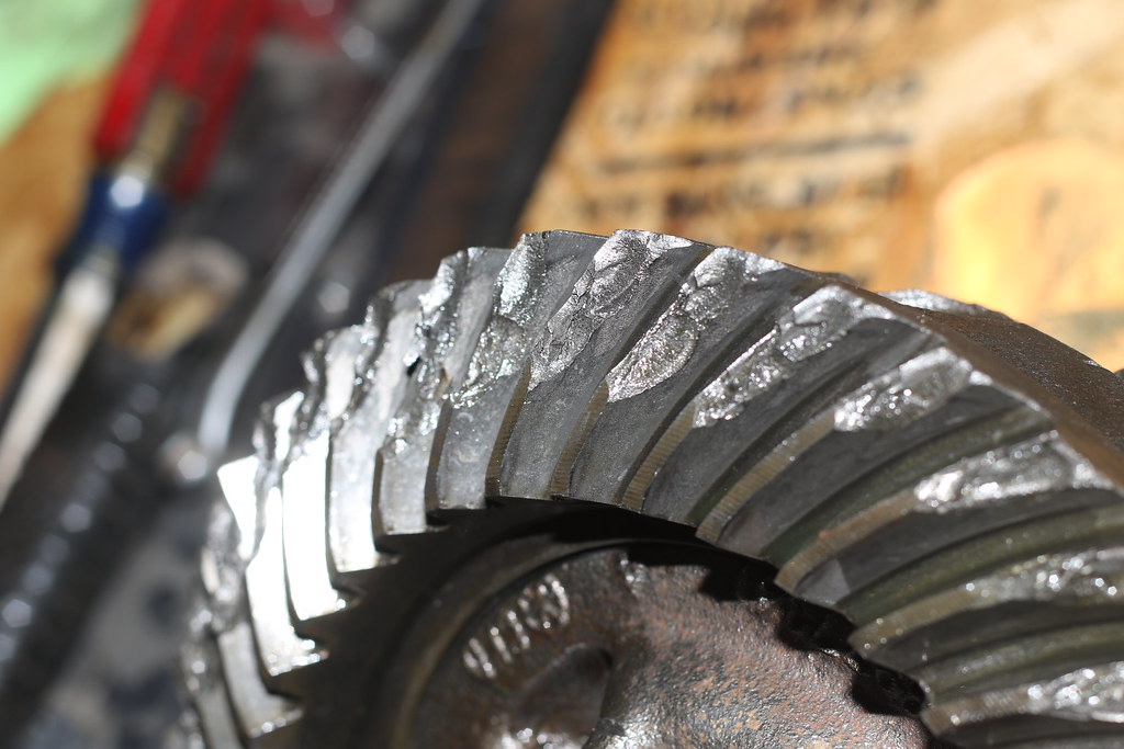

well 2017 and i got a bit done.. so I didnt post in here but I screwed up a while back when i put my detroit in. Lotsa throttle and incorrect meshing of gears grenaded my pinion..sucks..
well its out..
191A9607 by Jeffrey Riggs, on Flickr
191A9611 by Jeffrey Riggs, on Flickr

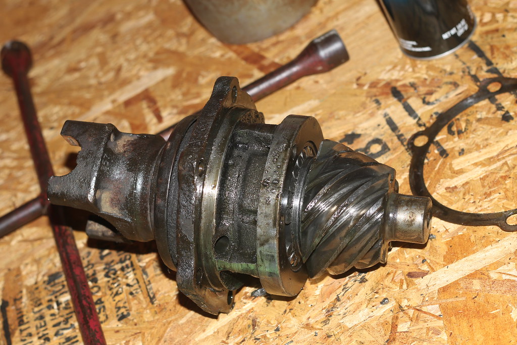

if you look there is bearings missing behind the pinion...
191A9609 by Jeffrey Riggs, on Flickr
