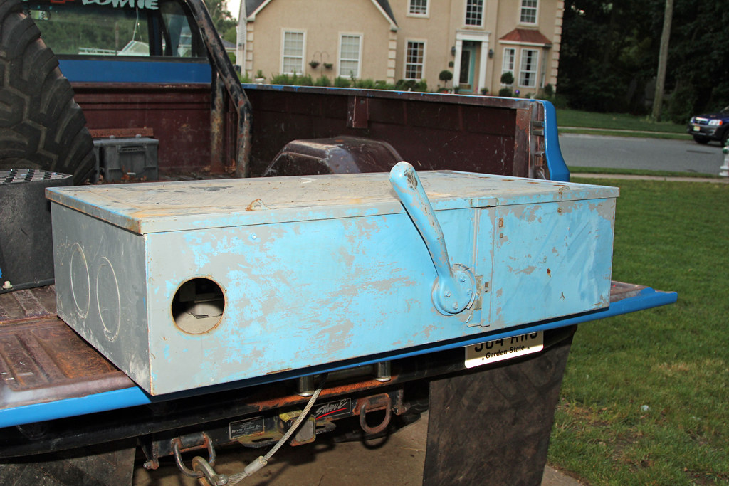

so a sneak peak...
what am i going to do with this????
Teaser by TeleFragger / RootBreaker, on Flickr
my guess is you are installing a cooling tower circ pump in your house :screwy: :dunno:
battery box for the 8D's?
good to see ya driving it..
WOW YOUR GOOD!!!!!!!!!!!
gonna fit the batteries in there... and cover up the winch hold.. broke a solenoid once.... plus make a shorter run of cable from batteries to winch....
also give me a space to moun the battery shutoff and ANL 600A fuse...:woot:
