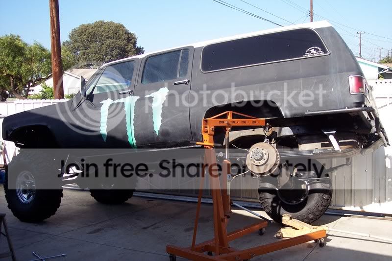

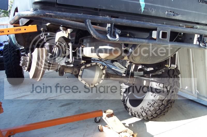

Well here is the current status but first some back yard poser shots cycling the suspension and measuring travel.

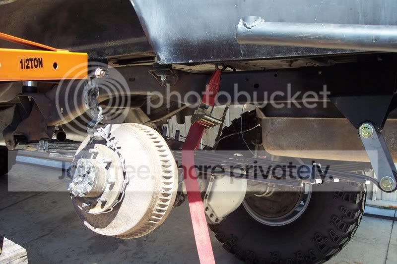

Rear bumper is 63 inches off the ground and 3 tires are still touching i got scared to go further but she had more in her.I removed the overload and turned it up side down helped with up travel and negetive made the rear softer dont know yet if too much.
I had to strap it to get the spring to reverse arch.
Measured about 6" of up travel and 9" of down on to the fun part more tear down and hack off.....

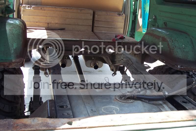

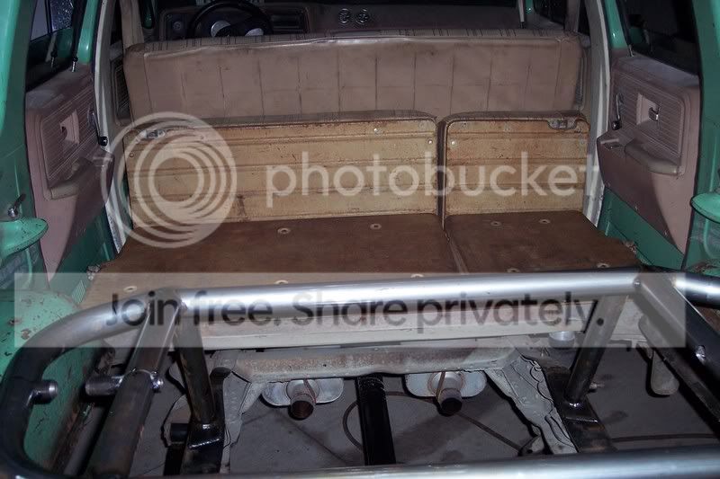

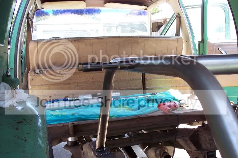

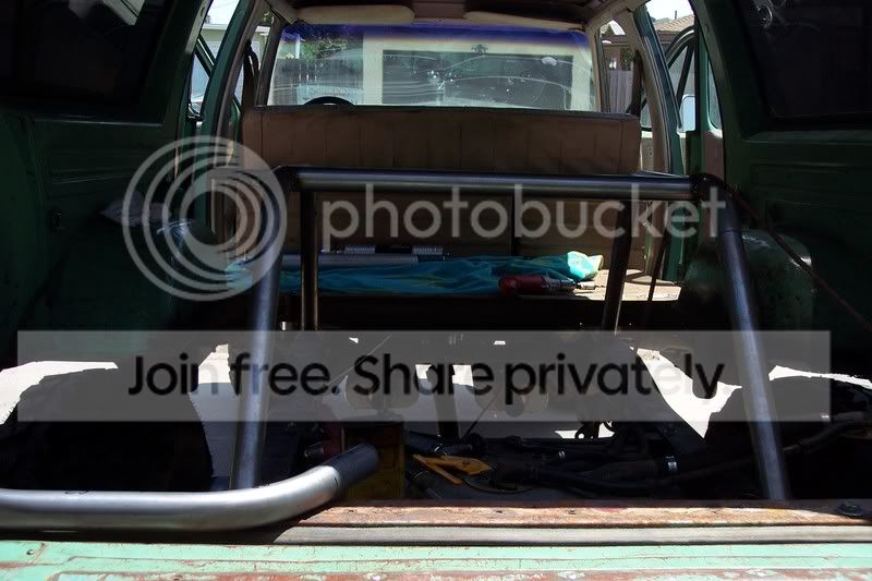

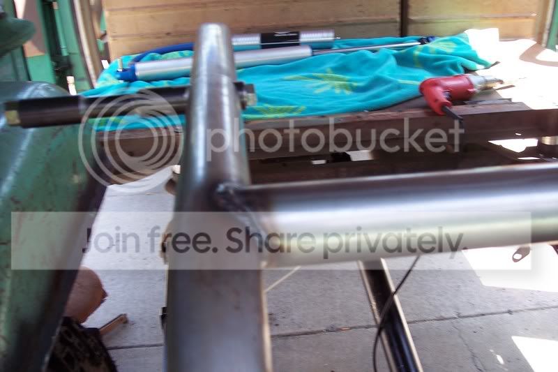

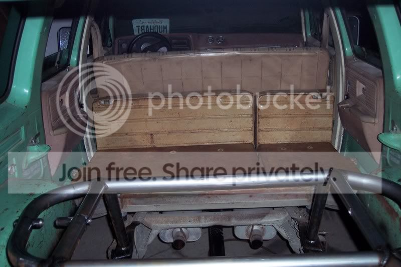

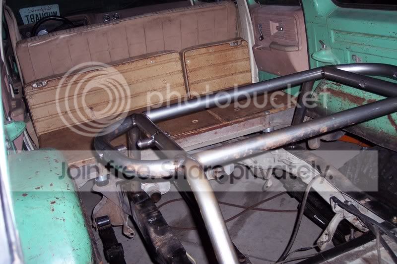

Recap hoop sits about 18 inches off frame if i remember correctly,

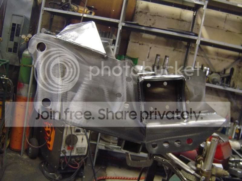

shocks are being mounted to top of spring plates the bosses where to short to make up both sides so having anothe one machined and will probably finish the bosses and weld them in and get the shocks bolted up by this weekend.

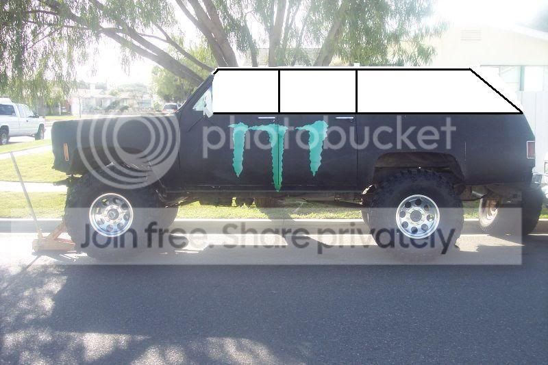

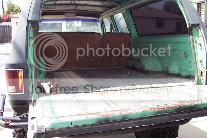

Then i got to figure out what i want to do for a floor?? Thinking of going full convert like a 73 and dzusing the quaters and door skins on with tube doors and going full cage and tube back half.. Just dont know if i want to take on that much right now.
Some thing like this rough drawing.

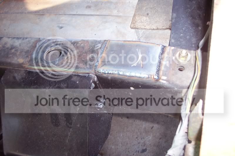

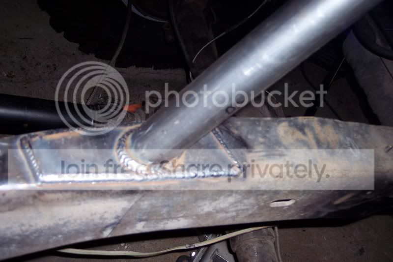

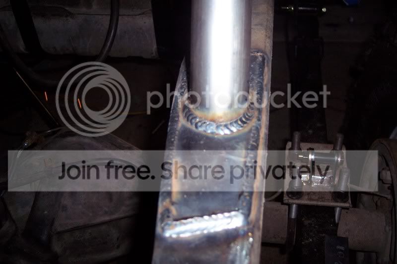

It's always nice to see a rust free vehicle for a change. You are doing some amazing work on the burb. What kind of welder do you have? You obviously have alot more experiance than I do. None of my welds look anything like yours. Keep posting please.
Thanks guys but i cant take credit for the welds its a friend a fabricator builds sand cars for a living at a big shop.My design and concept will se where it leeds.

Shock pic the new ones only have 3 or 4 inches more travel.
2.5 16" travl extended length of shock 42.43 and colapsed lenght 26.50 so you can do some figuring

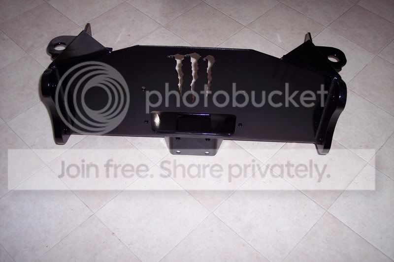

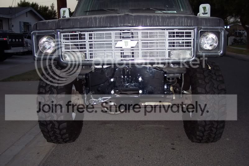

Have not got much done well anything been waiting on the fabricator and other things but a teaser pic i recieved cant wait to get it.. Thanks kirt diy4x rocks
Nice work man. I respect the extra effort you put into cleaning everything up and doing it right
yo matt, i like the A-bomb, that thing looks beefy.
i have a D60 with drw hubs. if you find one with srw hubs, i'd be willing to swap, if you still plan on going that route.
ya for sure i let ya know i found one just saving the funds 1200 bones..
nice meeting ya today thanks for the comp on the a bomb kirt ereally came through cant wait to get it on..

1.finish shock's and hoops
2. get quarters cut and installed
3. maybe the inner wheel well mocked up.
Well still waiting to finish shocks and hoop maybe next weekend.

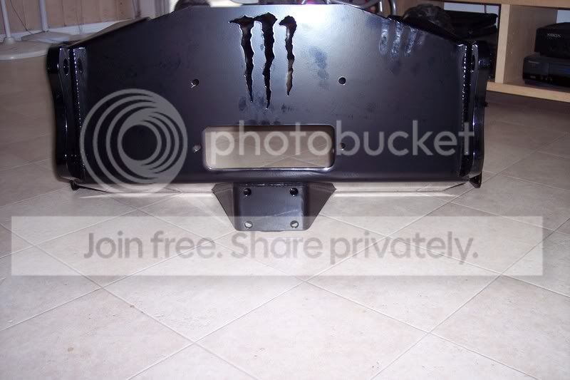

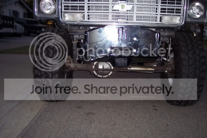

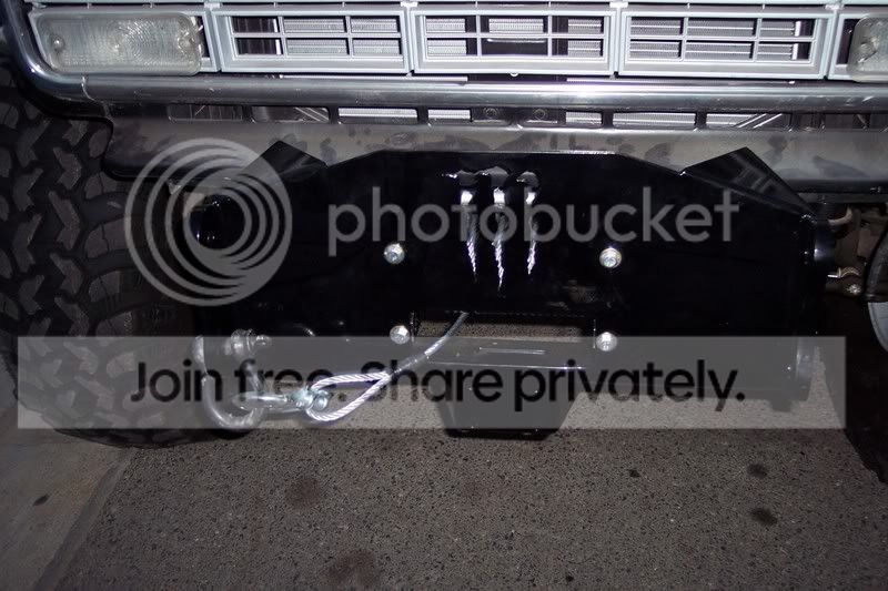

Got the a-bomb powdercoated (kirt thanks again awsome fab work) and installed.
