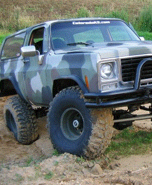

That use to be mine long ago. I sold the rolling chassis to some kid in central NC back in 2007 ( I believe). It looks like those rock sliders we built are still on it. They aren't going to move :D

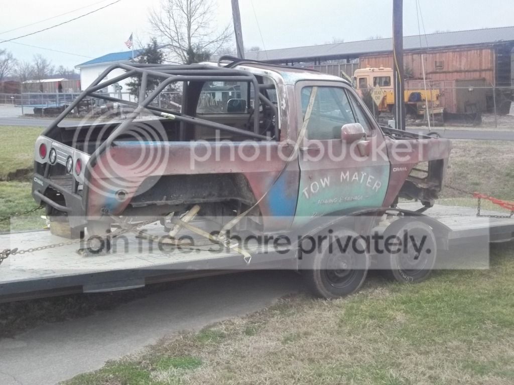

Well I am still going through some old pics to get some up here, but today I am going to pick up my motor that my other buddy had stored for me. But until I get that here and actually get started, Here is the blazer when it got home.

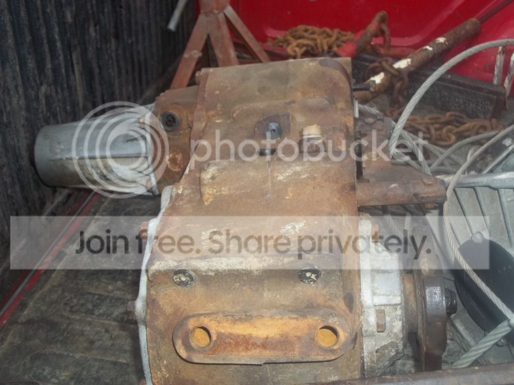

Picked up a 32 spline NP 205. It came with a slip yoke eliminator as well that I got to install.

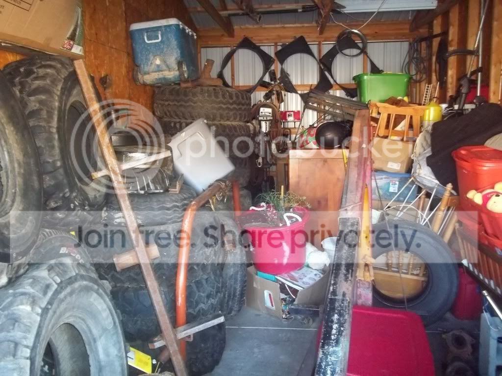

This is how everything was stored while I was gone.

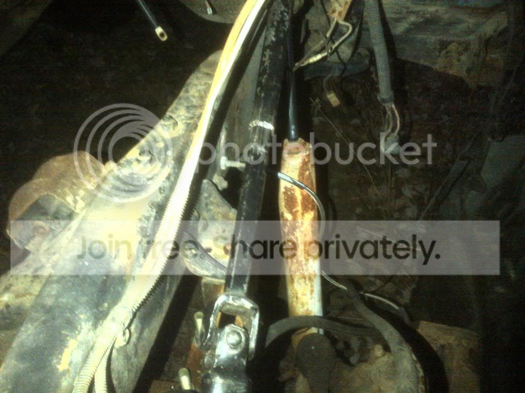

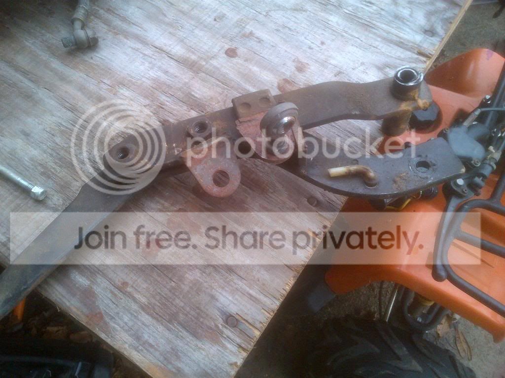

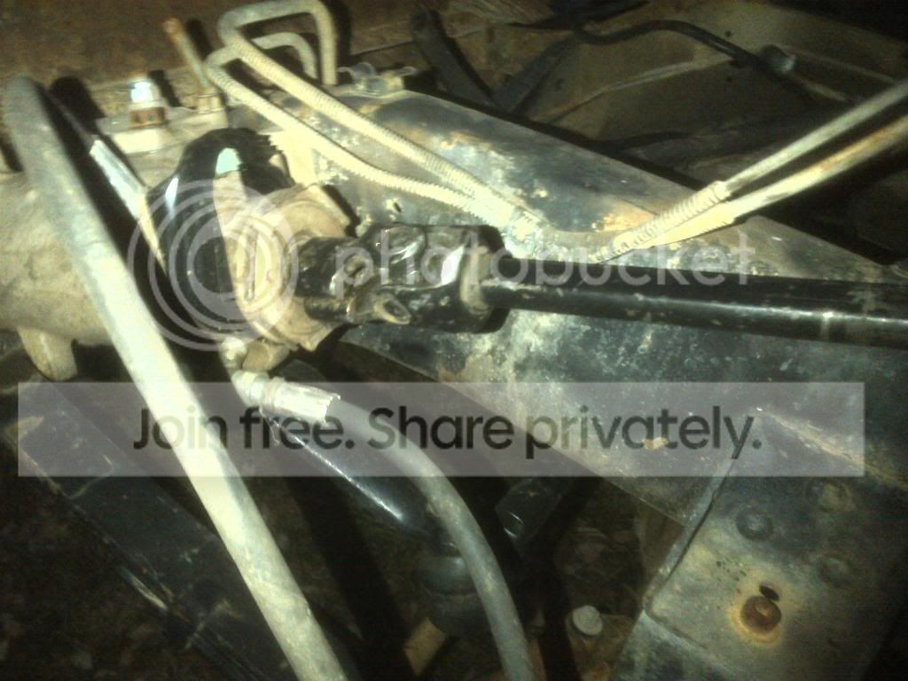

Things have been going slow, but I have gotten 2 things done. I swapped in my XJ steering arm, and my hydraulic clutch pedal assembly.

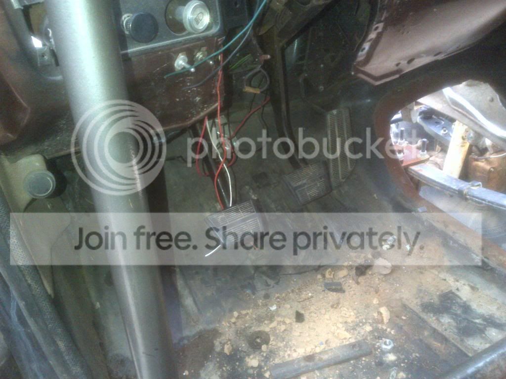

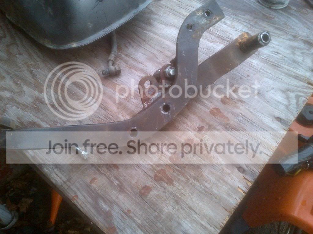

Anyone want to guess what the PO had in mind with this pedal deal going on? This was the clutch pedal that was in it, I have no idea what was happening.

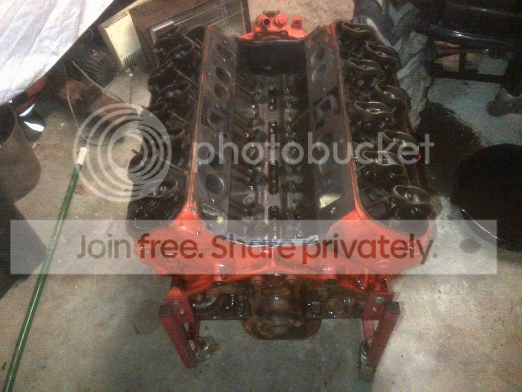

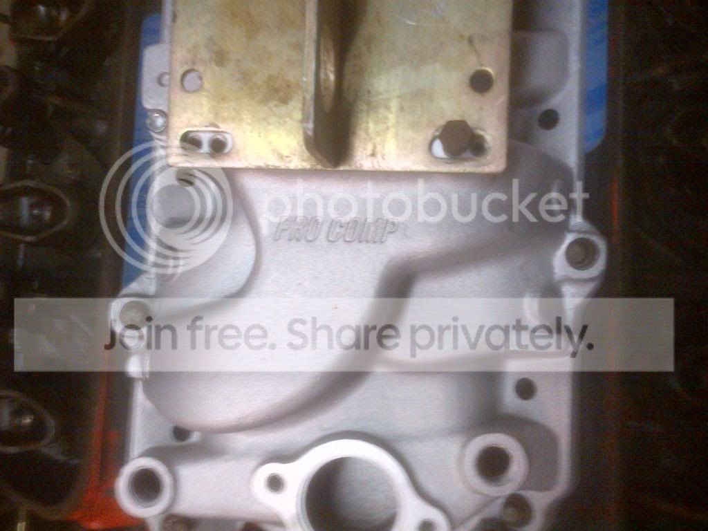

I have also been getting my motor ready. I am now read to buy some motor mounts (when money allows). I left the peanut port heads on my motor for now, but useed a pro comp intake for oval port heads. I have a set of 049 heads that I will be using later on, thats why I choose this intake.
This has really turned into a buget build since my newest son has come along, but I am still going to try to splurge where I can. Sorry about the crappy pics, they are all taken with my cell phone.
I'm no motor expert but you might hold off on installing that intake on the peanut port heads. Iirc, the intakes ports will be a good bit bigger than the heads, seems like I've read this overlap can cause the fuel to puddle around the head ports.
