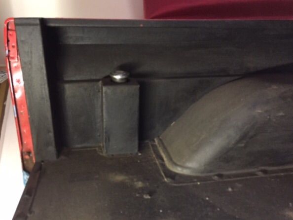

Actually going to pull the fill neck to the side of the bed like a factory fill?
Nice to see you on here man! It'll be easy to stay up to date on your truck this way.
Haven't decided final product yet. I'm still undecided on bobbing the bed and I would hate to put it somewhere Id have to cut it out again. The plan as of now is to do something like this, only executed a little better. Preferably in a location that wont get loaded with a ton of crap so I can get gas without having to move stuff.
