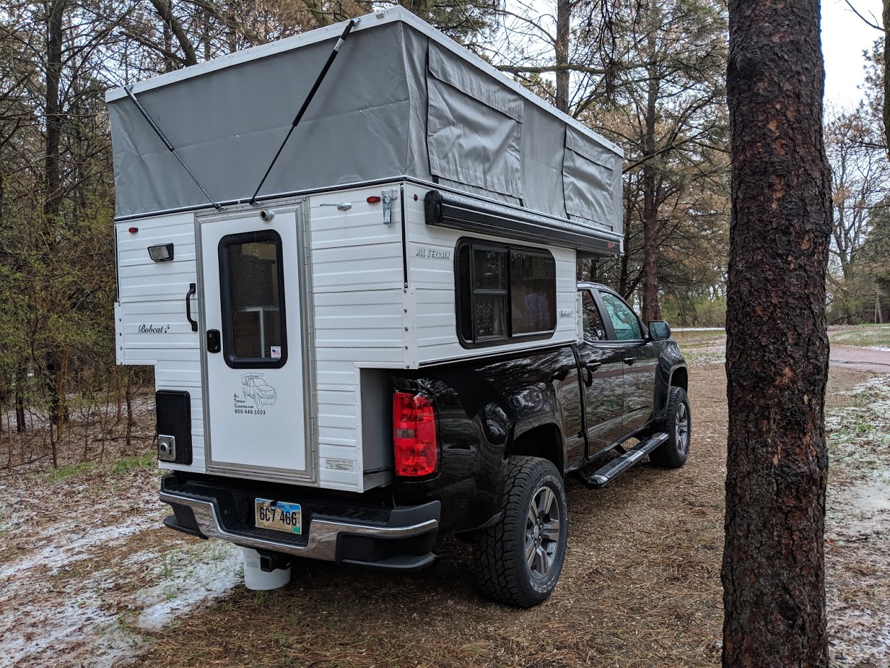

Side note: See the ref pic. ATC doors look exactly like my original FWC door, but they open the opposite direction.
