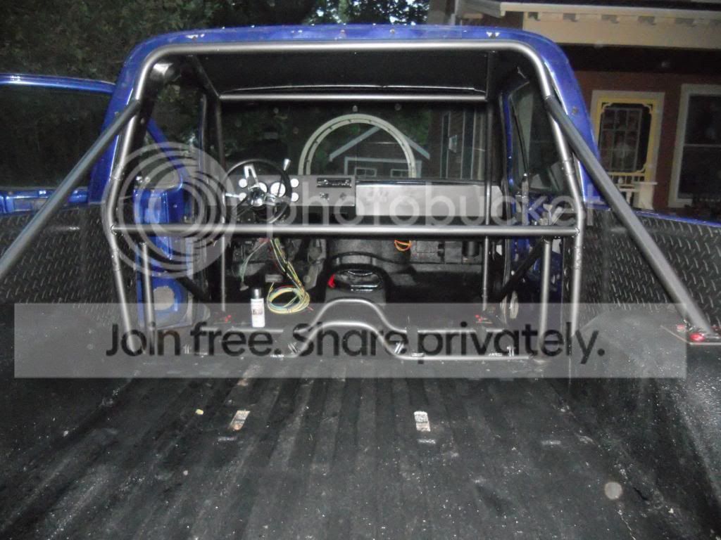

just for another picture heres one of mine, it came out good but i probably had to work harder then dueling to get there because some spots flaked off and i needed to clean it up again and repaint it. once i did that it stuck good and i hit a few spots with a hammer and chisel and it didnt wanna come off so im glad about that
Edit: and i also dont use carpet, i just see carpet as something to absorb water and form rust underneath, but i also use my k5 as more a toy so i dont car how loud the interior is because for me thats part of the fun.
