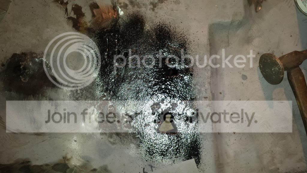

just for another picture heres one of mine, it came out good but i probably had to work harder then dueling to get there because some spots flaked off and i needed to clean it up again and repaint it. once i did that it stuck good and i hit a few spots with a hammer and chisel and it didnt wanna come off so im glad about that

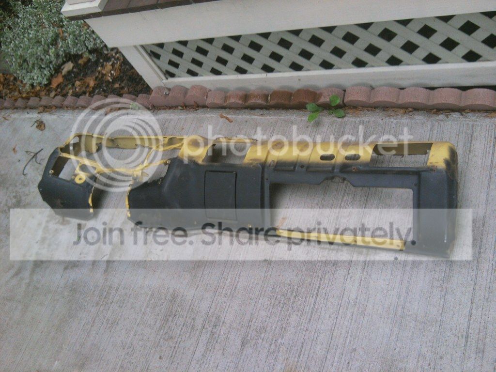

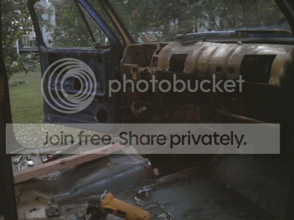

Its a DIY4x dash, got it from kert (cyberfire). It does bolt right in, but you need to cut away the skeleton of the stock dash, ill see if i can find a picture for you of mine.

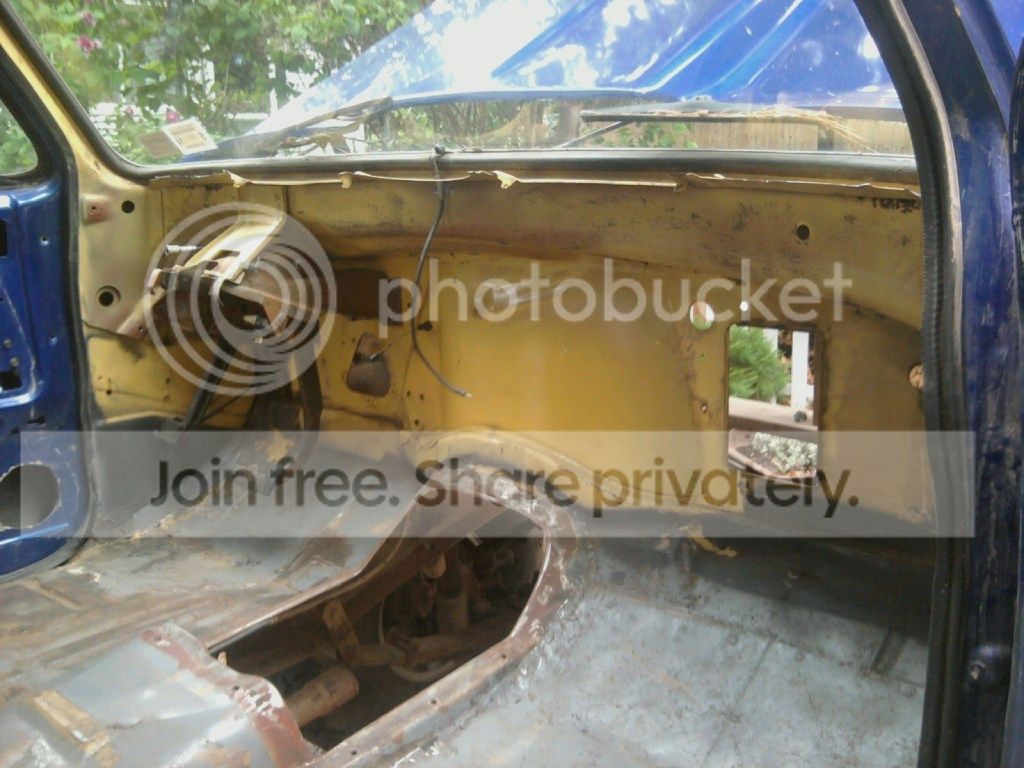

strip dash down to this:
had to cut this out with angle grinder and cutoff wheel:
and this is what it looks like after, from here it will bolt right in using the bolts on the sides of the interior (i left a little lip left of the skeleton so i could attach defrost):

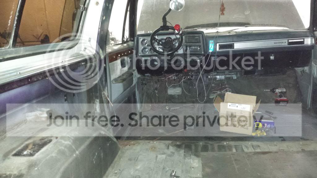

okay finally made enough progress to justify some more pictures:thumb:

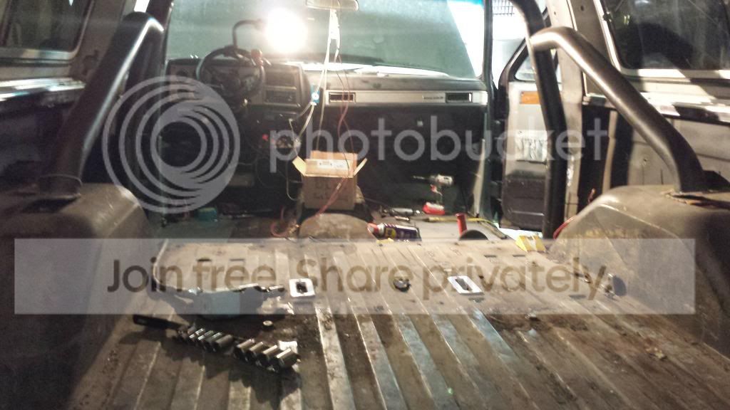

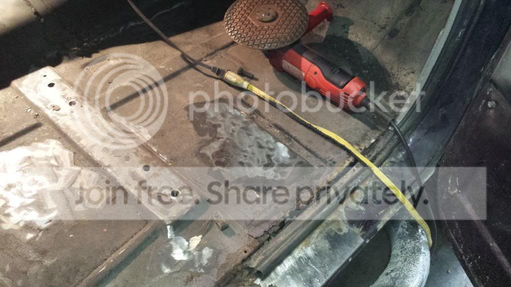

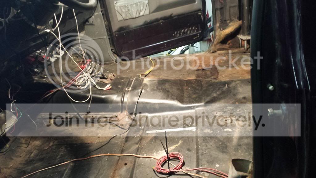

okay got the inside cleaned up a little bit so I can start messing with the rusty stuff

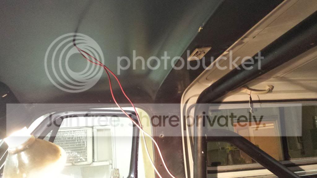

got the headliner and interior trim all out as well

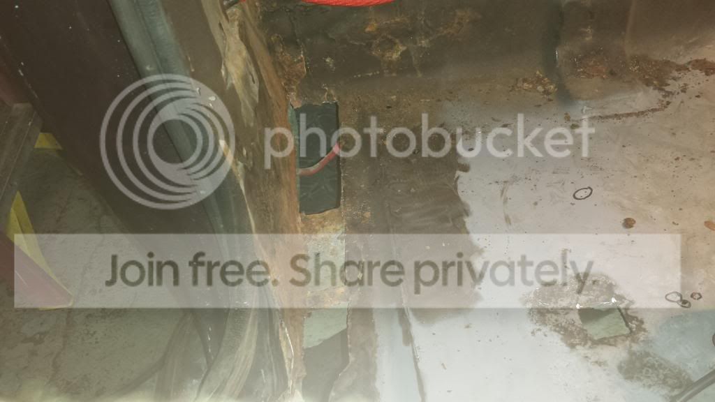

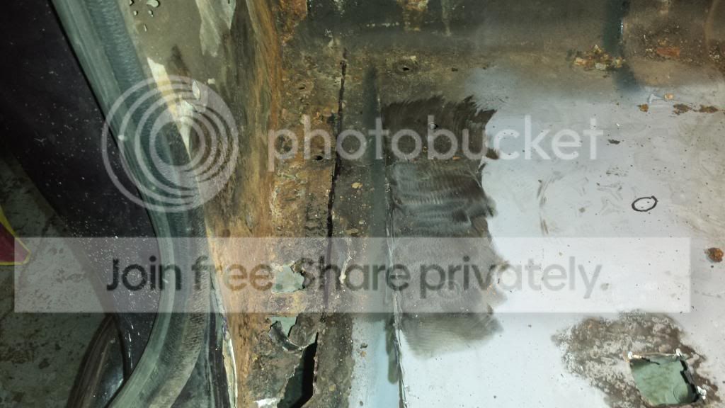

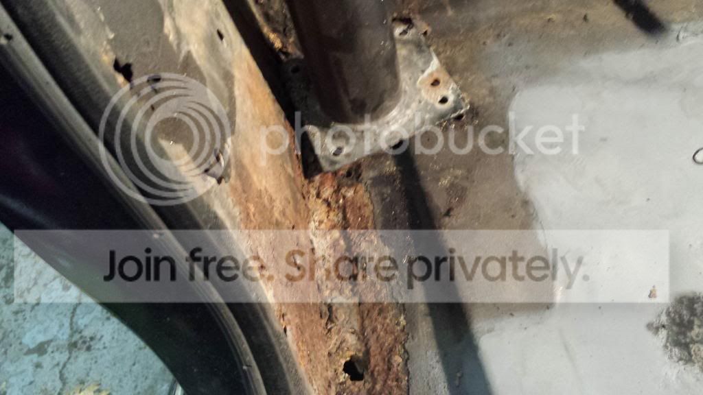

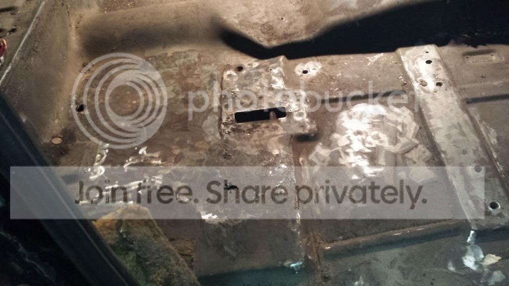

started grinding some stuff and and found a few spots on the passenger side

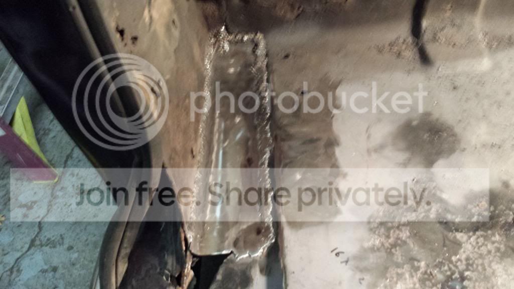

then this really bad spot tried grinding at first but ended up cutting it out
im hoping that the bed liner will hide the horrible welding, for some reason I couldn't find a happy medium on the welder either it wouldnt burn in or it would burn up and eat the floor pan finally found something that worked just took an awfully long time.driver side needs the same thing
then I was hammering on some other welds to make sure they weren't coming out and I missed I wasn't tapping very hard but I found about three other spots that were pretty weak im going to finish them up tomorrow. hopfully finish up the entire passenger side then on to the driver side.

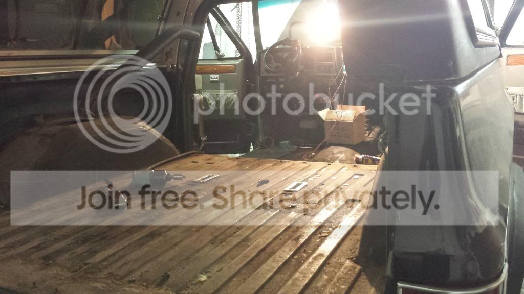

the bed isn't to bad nothing really rotted out, slight surface rust but nothing bad
bed pictures

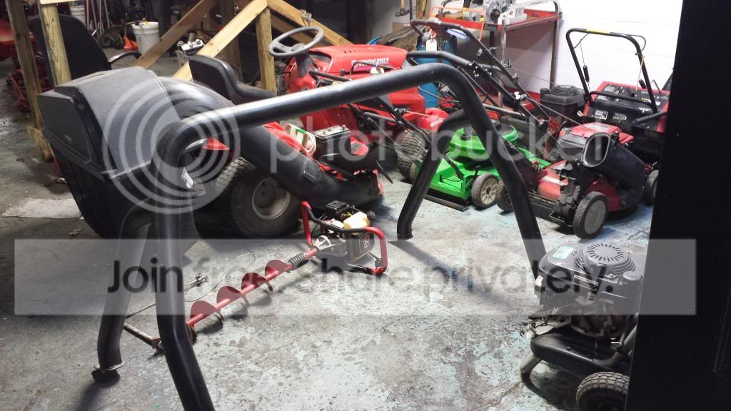

roll bar
