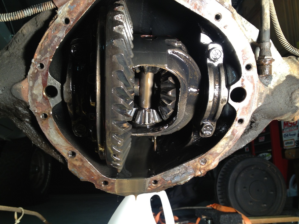

When my buddy bought this truck I was with him, the seller claimed it had 4.10's with a locker in the rear.
The truth

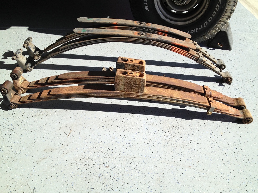

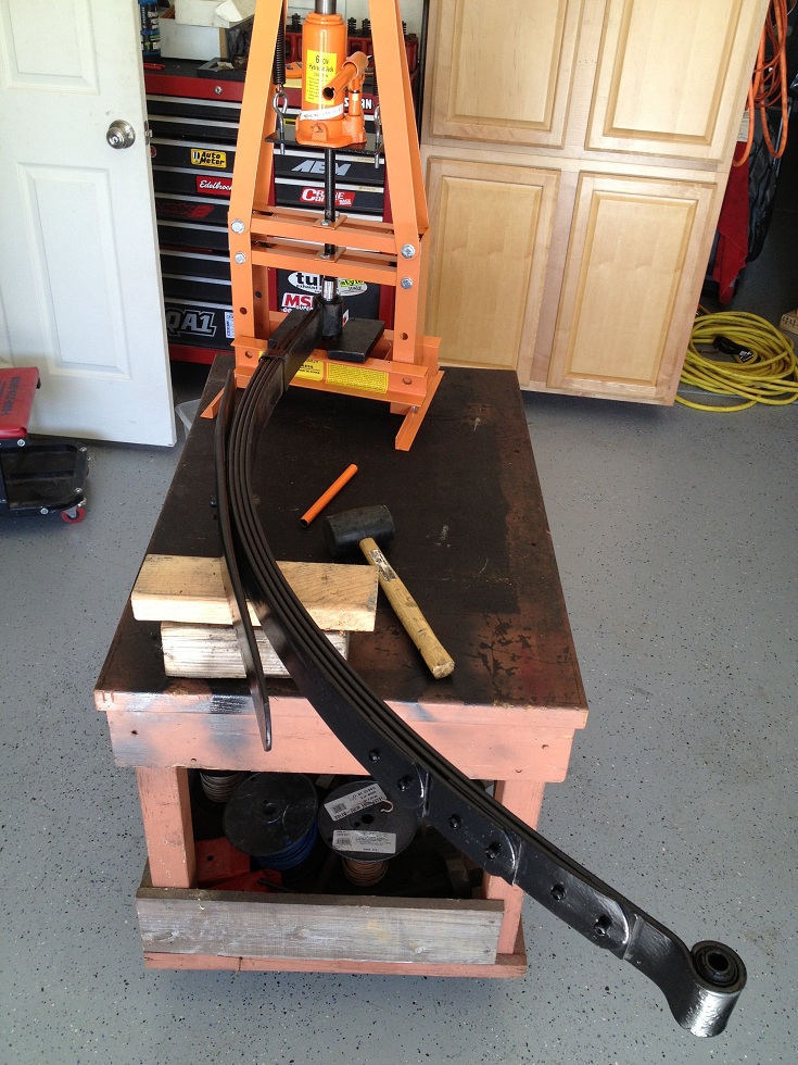

old crusty ass springs vs some F150 57" springs I bought at the local PnP
full

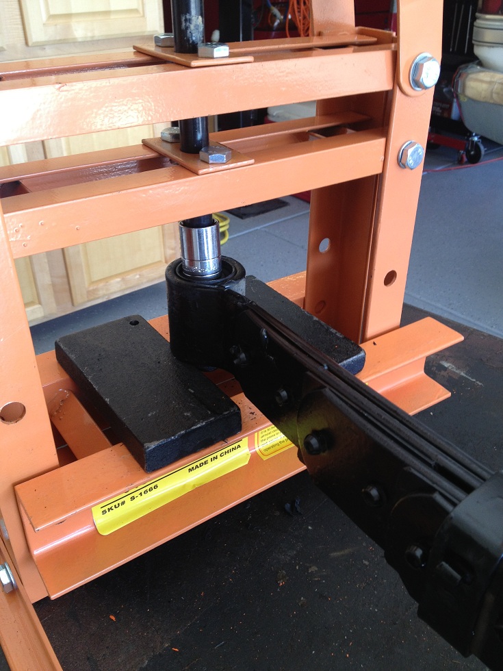

Installing the new bushings in the springs
full
full

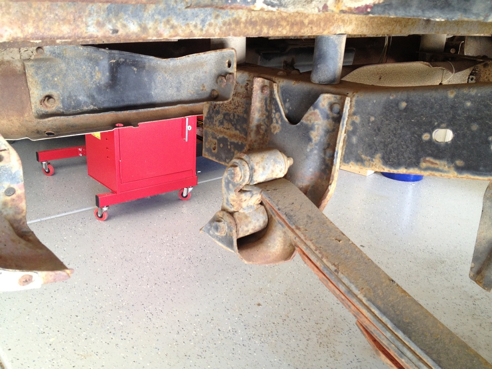

OE Rear Hanger
full

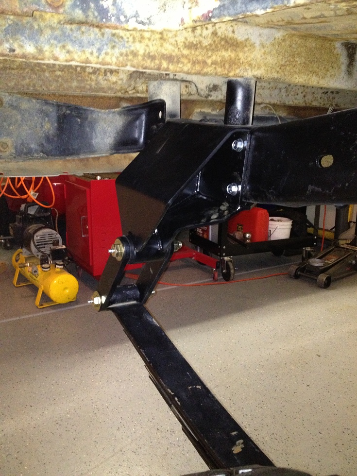

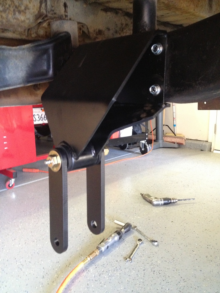

Now DIY4x’s installed
full
full

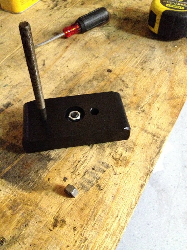

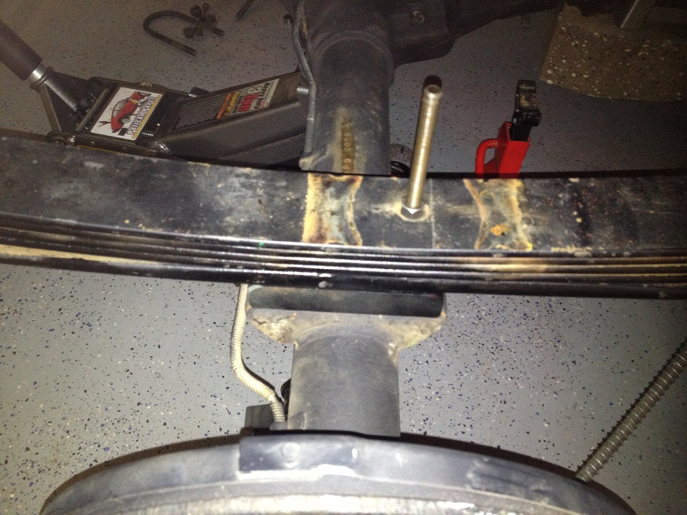

EZ Inch moving the axle back
full
full
RuffStuff is about ten minutes away so I ran over there for some U-bolts, plates and hardware. Gotta love those guys, even open on Saturdays!

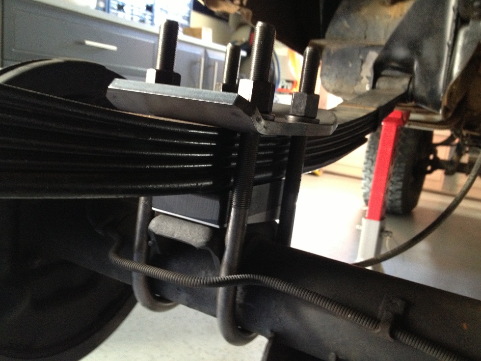

Pretty straight forward install and I was able to use the RuffStuff U bolts, plates and hardware I already had along with the 6 degree shims

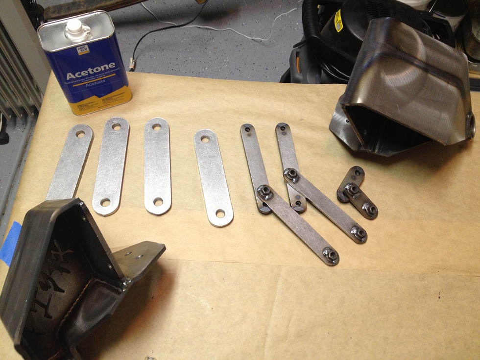

Started to prep the 52’s off the rear of the truck for the front 52 swap, removed all the bushings, cut out the sleeves and then realized a hairline crack
Probably a good thing this happened now rather than later on the trail. Still pissed me off because I had done all that work. The next morning I hit a couple PnP’s and found a set of leafs on the back of a 75 K20 which already had the axle removed. On close inspection they appeared newer, measure out at 52” with no rust so I pulled them and brought them home.
After I gave them a bath I found plastic wrapped around them and a couple part numbers, one of which came back to a Pro Comp Part No. 13311 which are rear 52” leaf springs (2-4” lift). I later realized I was missing the 5th leaf but I wasn’t going to complain at that point.
More grinding, cutting and banging……
Primed and painted all of Kert’s parts

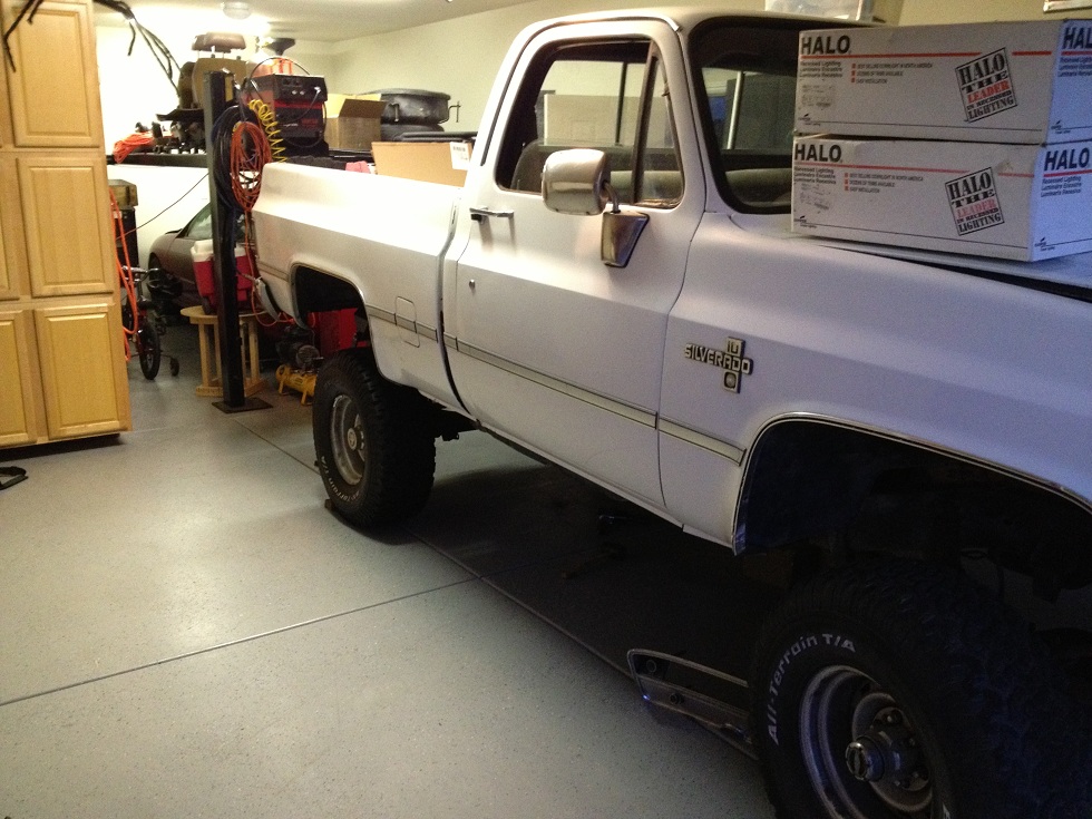

Front Axle rolled into place, with the EZ-Inch in the center position and no shim
Checking the shock clearance, SS 36” brake lines installed
Now with the old shock mounts removed, F-250 Towers installed, new steering dampener, drag link installed.
Then I went and had the two BFG’s I picked up last installed on the front rims and the less of the weathered tires installed on my spare rim.
Picked up some 8 lug rollers for $60 so I could get the truck out of the garage
I quickly realized I had a serious issue on my hands, I couldn’t turn right. The axle location had moved back enough that it had made the drag link too short. I ended up using two of the longer halves of the drag link to make a longer link so I could turn right.

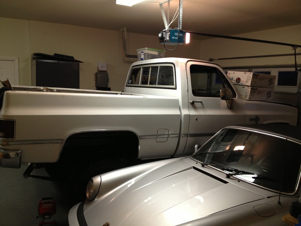

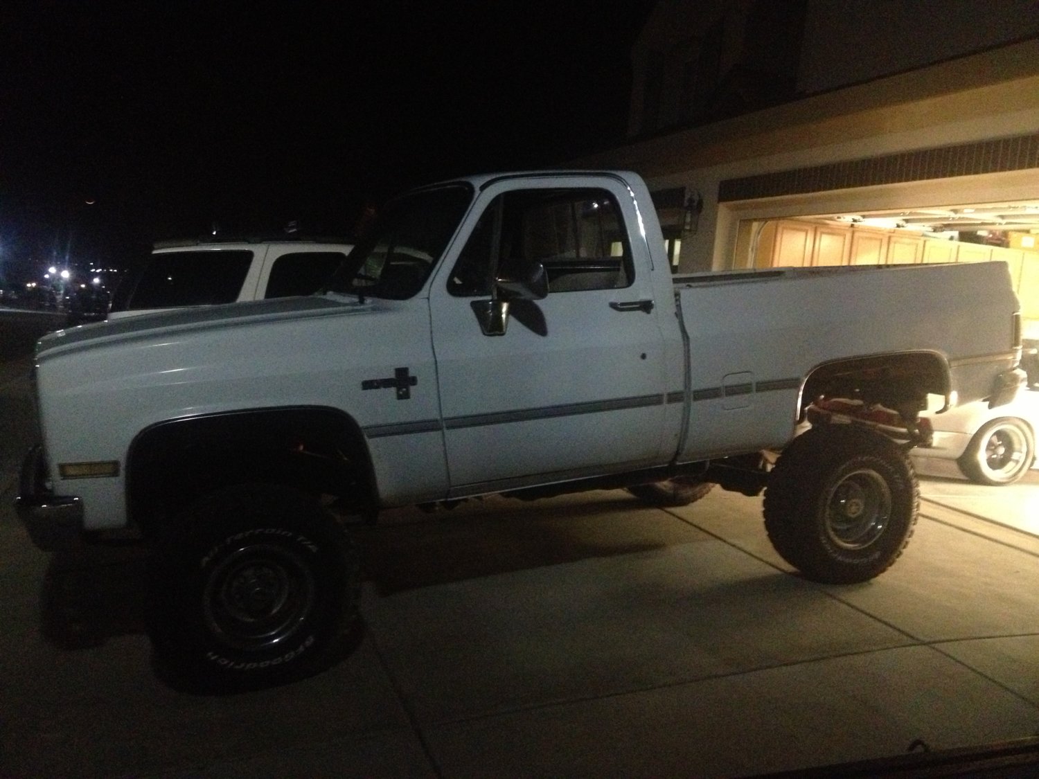

As it sits now….
Clearly need a crossover setup for this truck, this push pull crap is for the mall crawlers. Also need to figure out what I want to do with the body. It’s a 2wd cab so I can’t drop the body all the way down unless I cut the floor. I’m thinking about running the 1” ORD pucks. A serpentine belt setup is also on the to do list, nothing seems to lineup right off the crank pulley on this engine.
