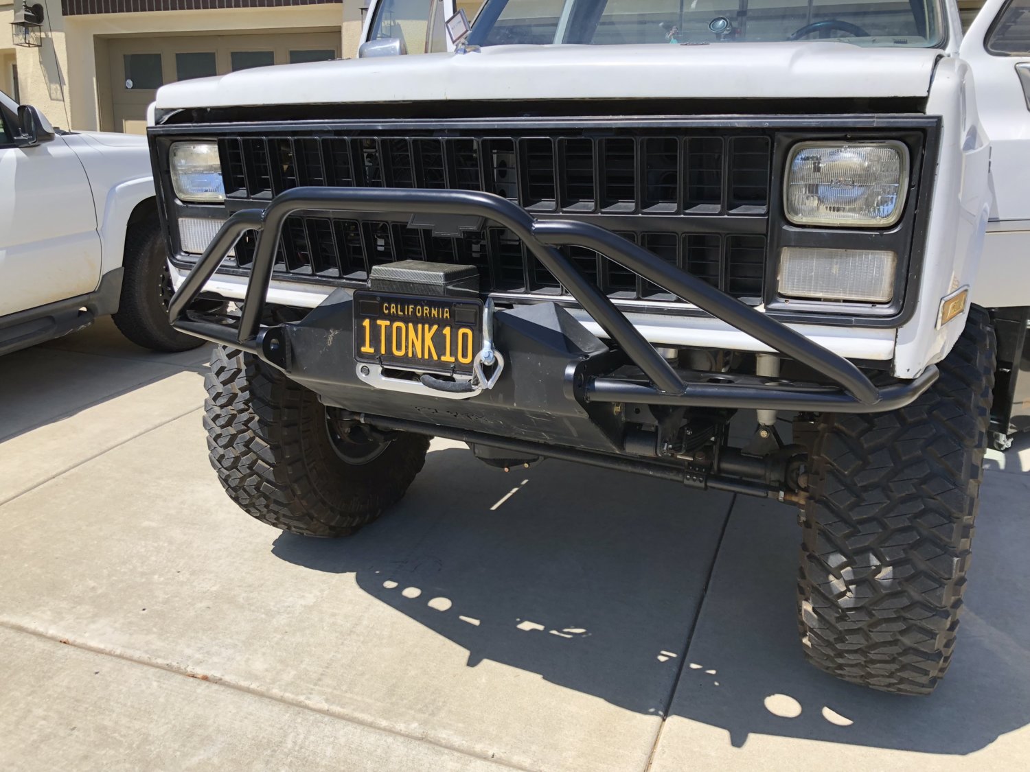

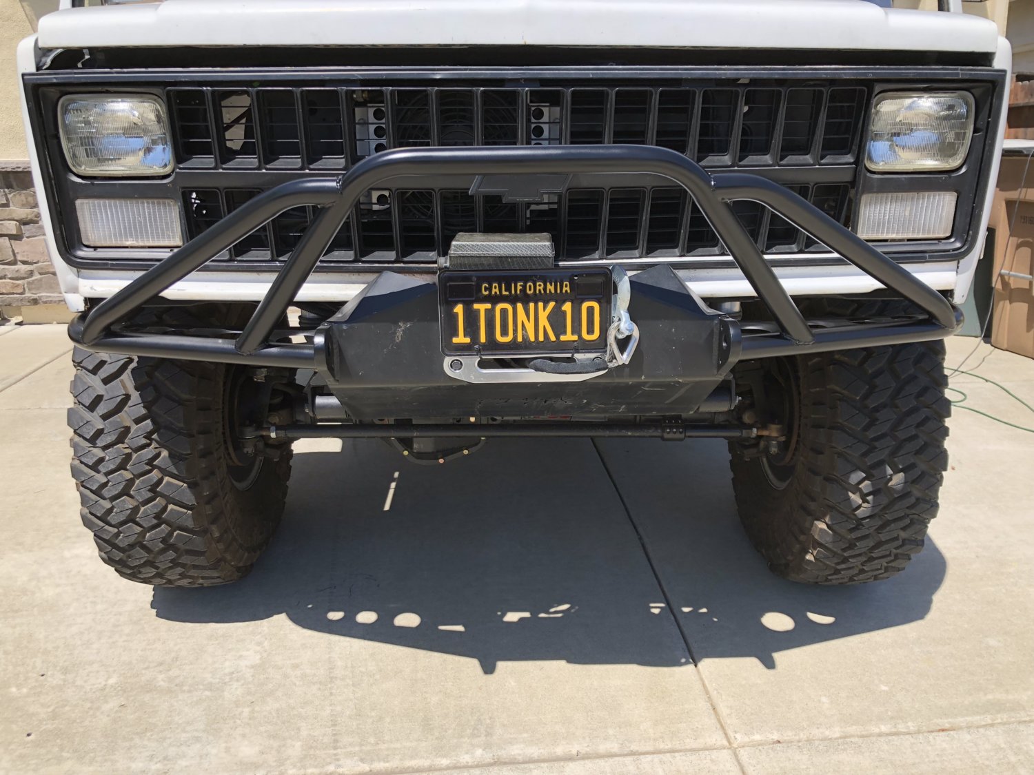

making some progress today.
caped the exposed ends on the bumper and squirted some paint on it. Grille is loose, still need to mount my sidetracked 6' LED bars

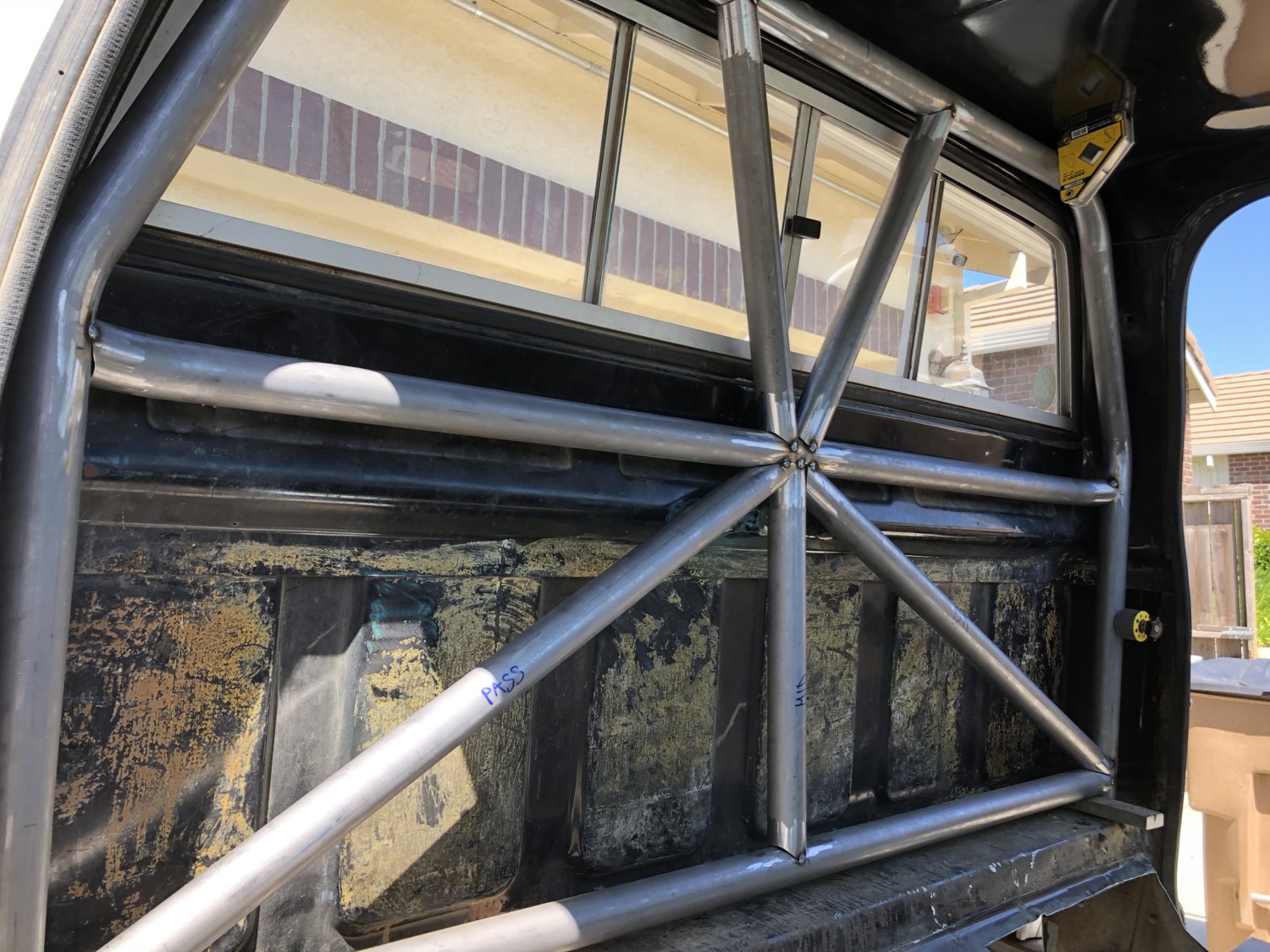

and I have the B Pillar supports tac'd in

Right on man! Looks GREAT!!! I’m just going to have to bite the bullet and go for it with mine. About how much tube do you have into the cage? I need an estimate to give to my wife. Lol
Wow some terrible that is just going to get used against you
I've used about 35' so far.
Thanks guys, I feel like I'm starting to make some progress.
I’m going to have to do some shopping for DOM... I have a feeling it’s going to be ridiculous here in town. Welcome to small town USA.
I paid just under $6 a foot. Ruff stuff was sold out, they’re usually $4 a foot
I bought a couple hundred feet a few years ago to get a price break. Think it may have been like 600' right at $3 a foot delivered. Of course it isn't US steel, not sure if yours is either, but there's no way in hell I'd pay $6 a foot for 1.75 .120 DOM.
Btw, i kept 200+ ft for myself, a buddy took 200' and I sold the rest for more per ft than I paid to reduce my cost even further.
I bought a stick of 2” 1/4 wall for a customers rig in 2009 and I think it was $18.00 a foot. I still have about 10’ left on my rack.
