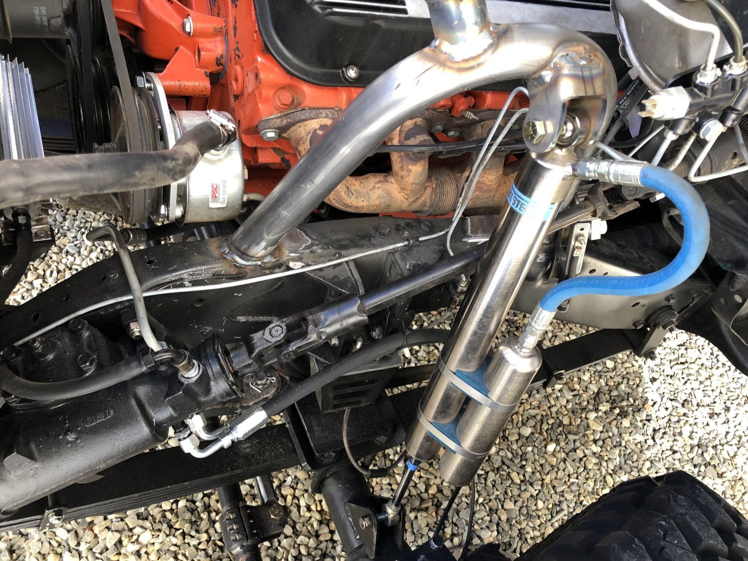

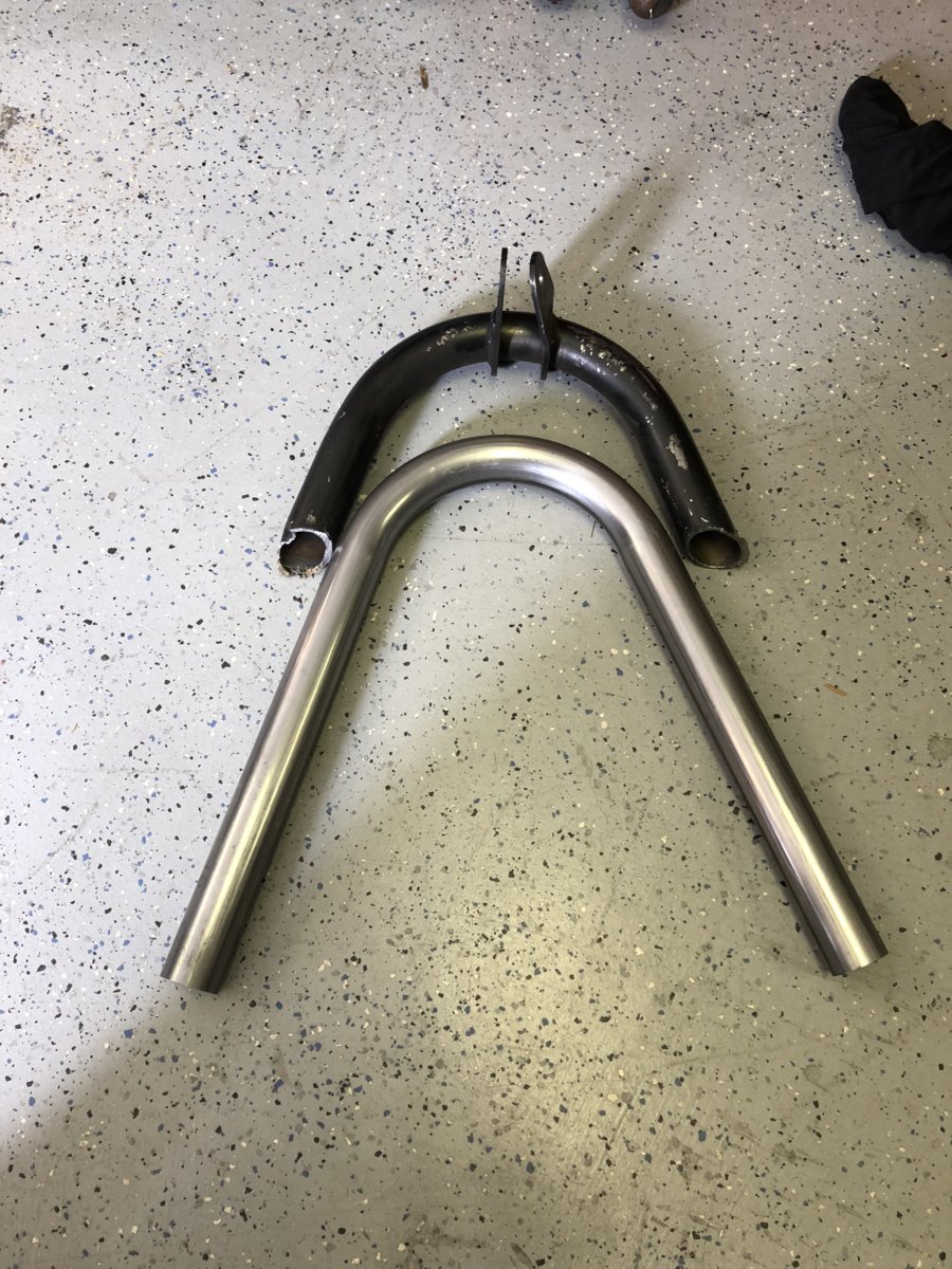

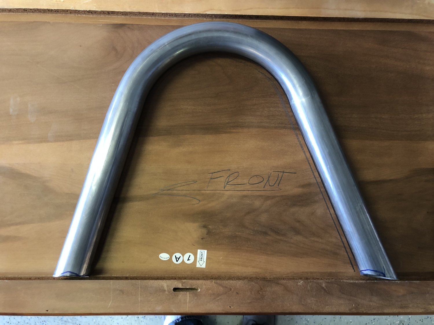

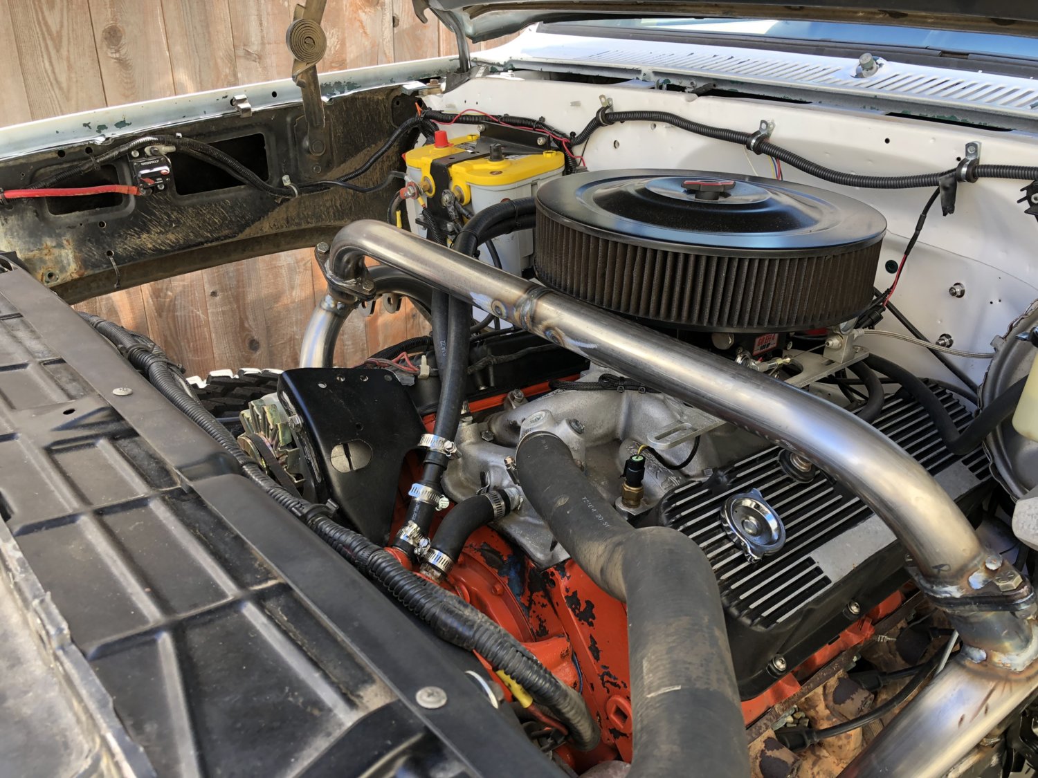

When I built the hoops the first time I based them around the pro comp shocks I had with the idea that I would upgrade later. I ended up scoring some Bilsteins from @bmxbryant9 a while back and quickly realized the body of a 14" Bilstein, King or Fox shock was 1.75"+ longer than a procomp so I would need to modify my hoops to accommodate a couple more inches of bump travel that I needed. After a couple beers and some head scratching the saw zaw went to work, the original hoops were simply too short. Next I bent a couple longer hoops at 145 on the bender and started to trim until I had one fitted with the 6" of bump I was looking for.
full
Traced the hoop on a scrap piece of wood so I can duplicate it for the other side.

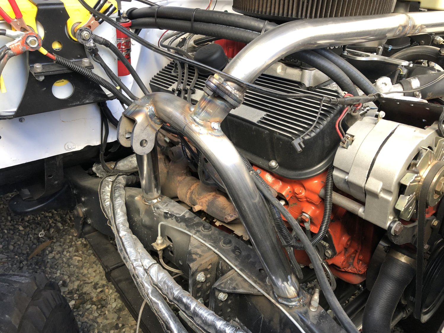

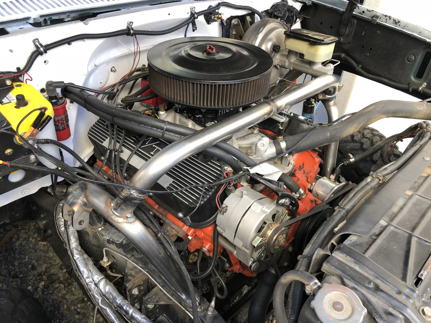

I used a Bilstein for mock up since it's within a 1/4" in dimension to the Fox's I'll be running. You'll also see the removable crossover bar I added so the hoops are tied-in.
full
full
full
full

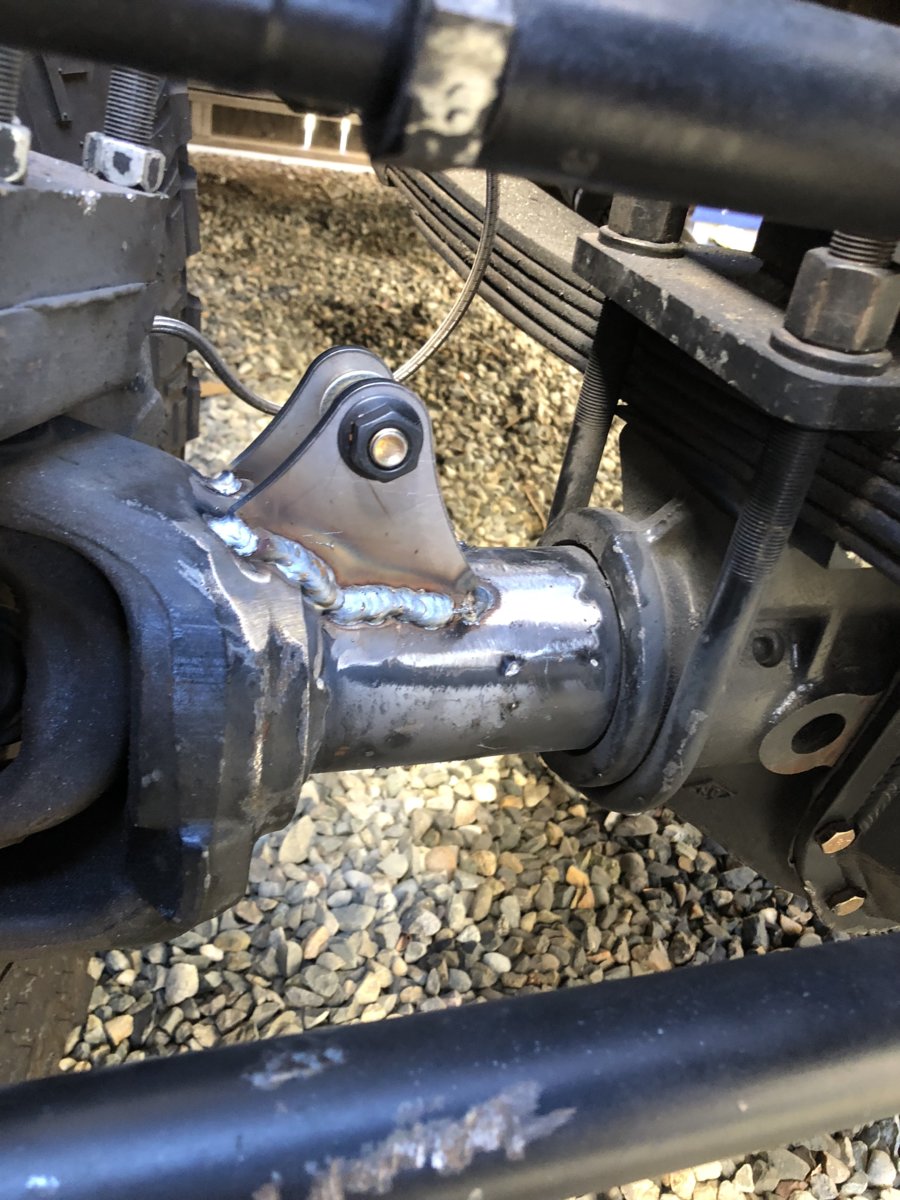

I must have had a couple too many beers when I welded the lower tabs on the passenger side since they were clocked about 5-7 degrees more forward than the drivers side. I didn't want the shock busing to bind in those tabs so I ran over to ruffstuff and picked up a set of D60 tabs and redid that side. It was cold and windy yesterday and a bitch to weld that outside.

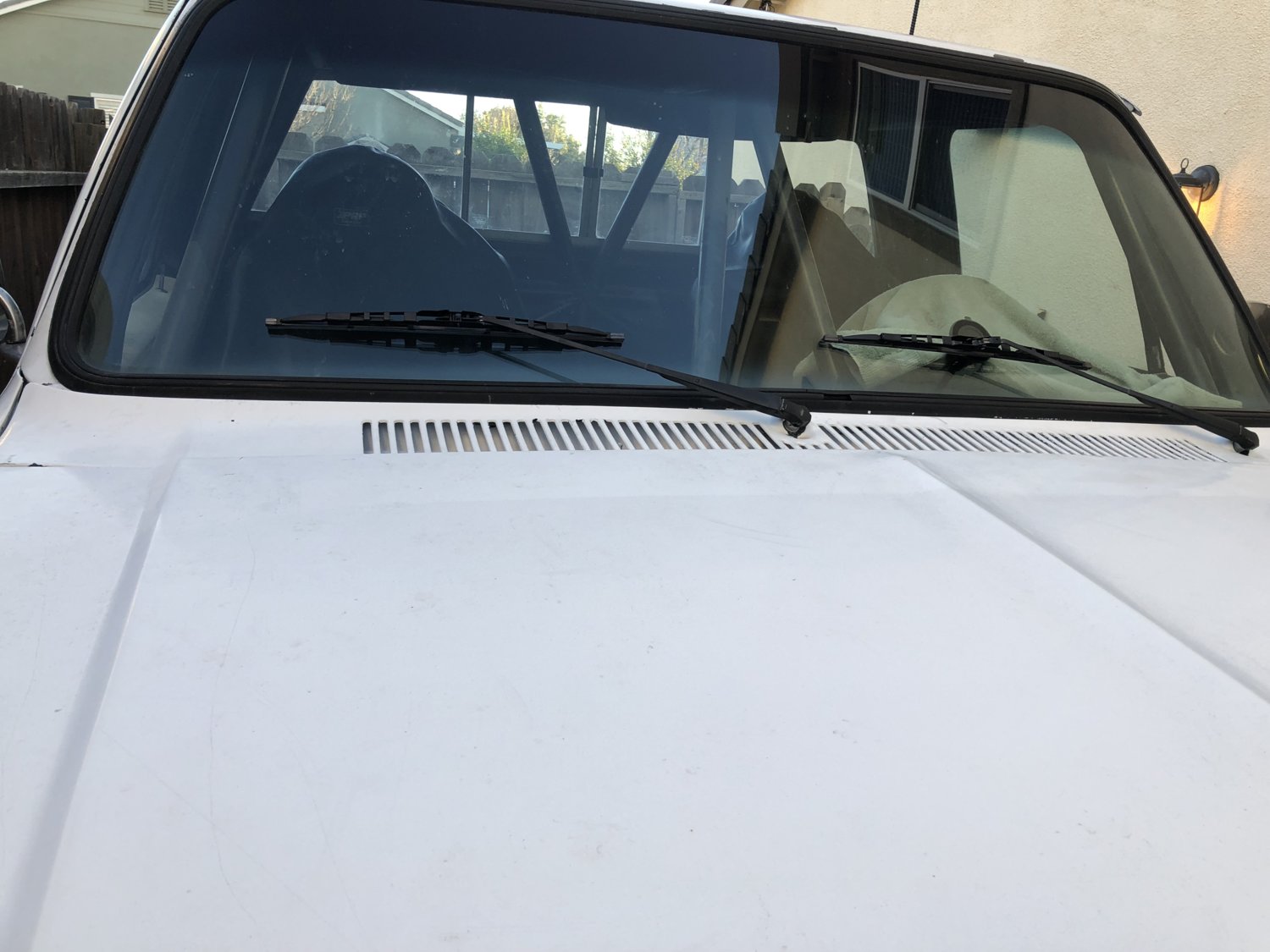

also got the wiper linkage back on and mounted the wipers.
