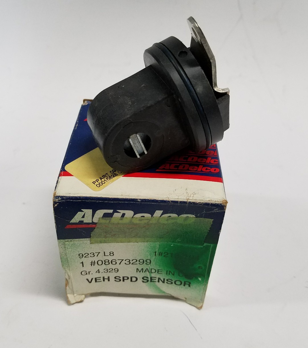

Ok... so tonights defeat comes from ebay.. I bought a VSS 241c bearing housing and it arrived, I got the reluctor gear on but the bearing housing does not line up. I discovered this after 2 hours of grinding the notches for the oil pump... soooo.. During some research I realized the speedo gear assembly from the 241 is the same as the unit the th350 uses.. I have a mechanical speedo.... hmmm the 700r4/4l60 has a 90 degree VSS... This might just solve my problem. At this point what do I have to loose, another 30$ aint gonna change a thing considering i wasted 100 on this bearing setup which I did get the reluctor gear from so it wasn't a total waste. I have to imagine that the spacing should be close enough to work.. thoughts?
