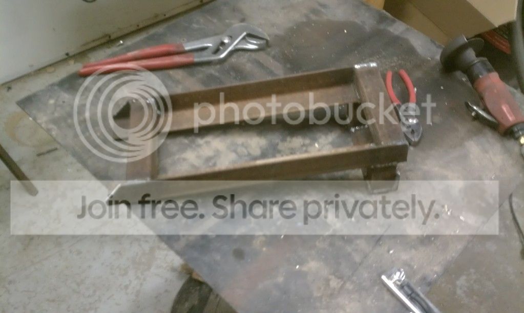

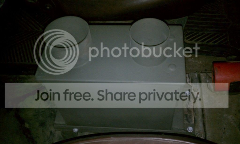

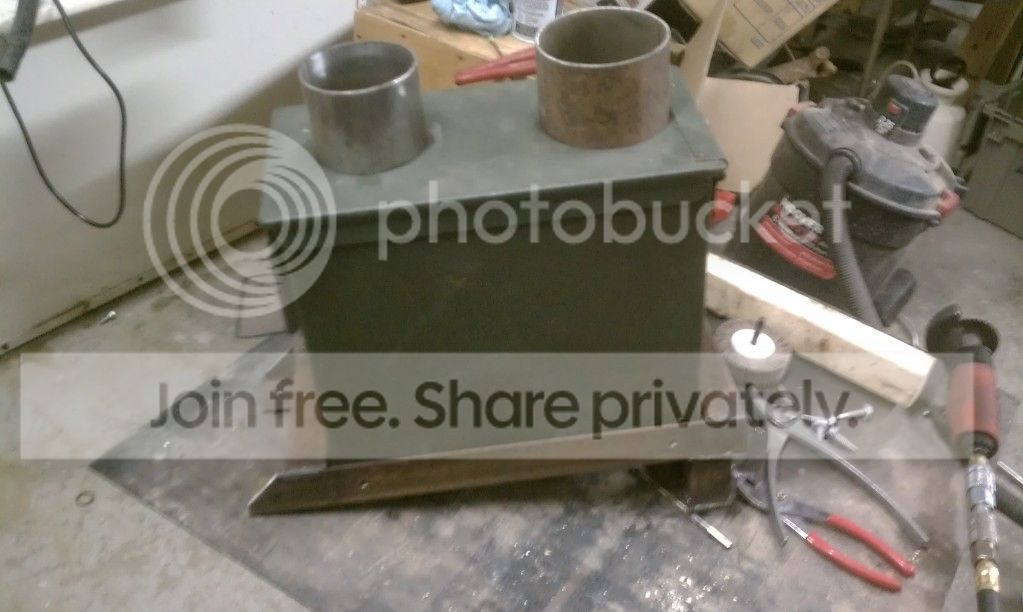

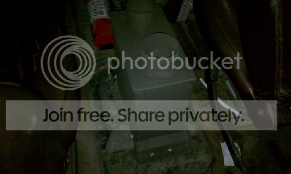

Built an ammo can center console,complete with cup holders.

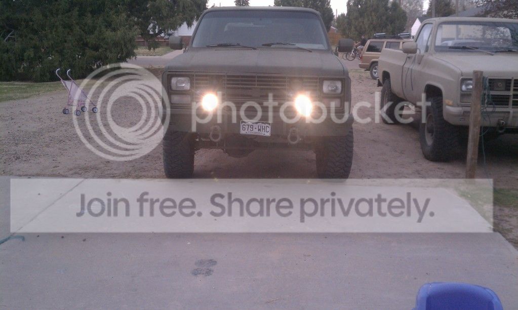

Added some driving lights

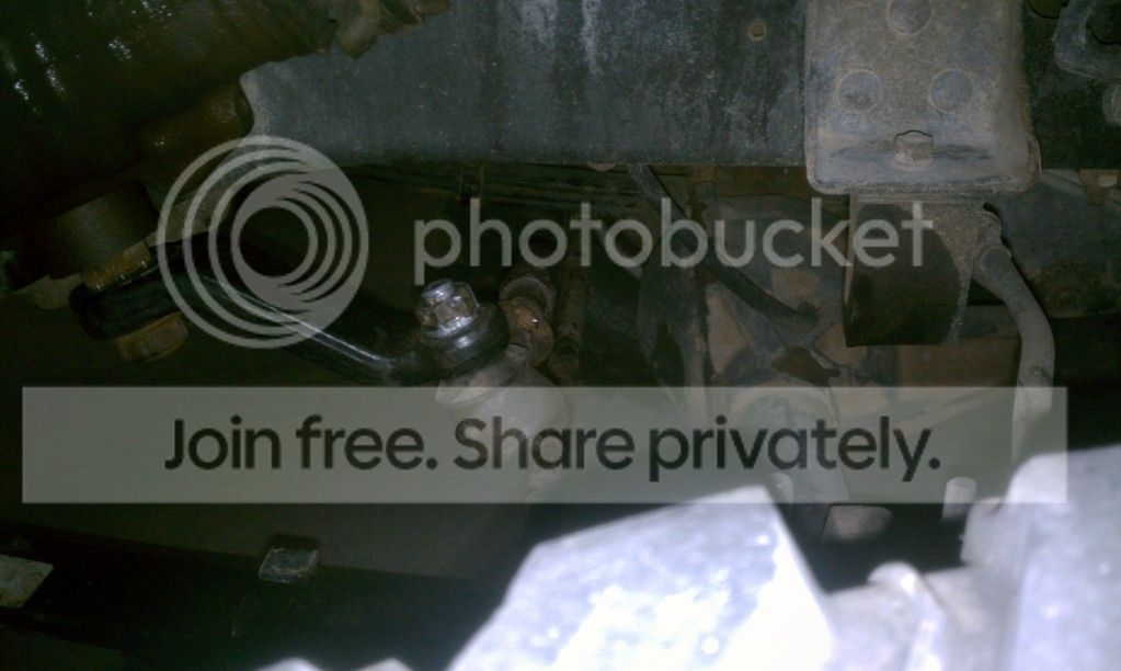

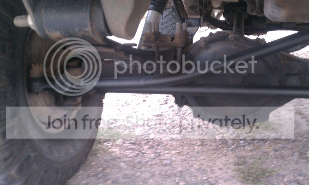

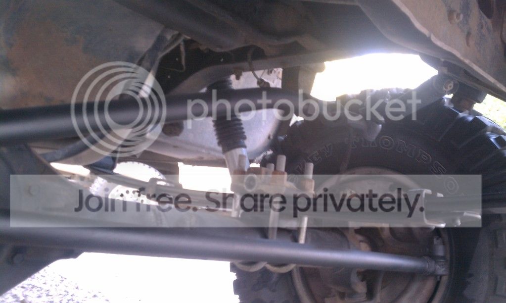

I got tired of the massive bumpsteer so i gave Norcal Chris's crossover steering idea a shot. It works pretty well,still has a little bumpsteer but it is night and day better.

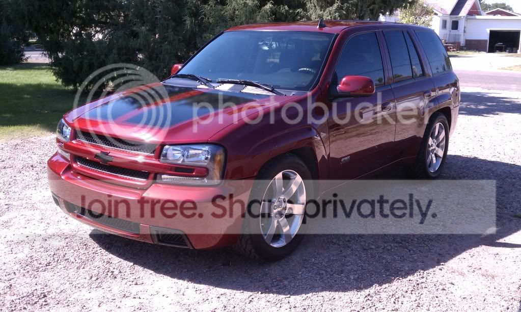

Here is my baby that soaks up most of my mod money.

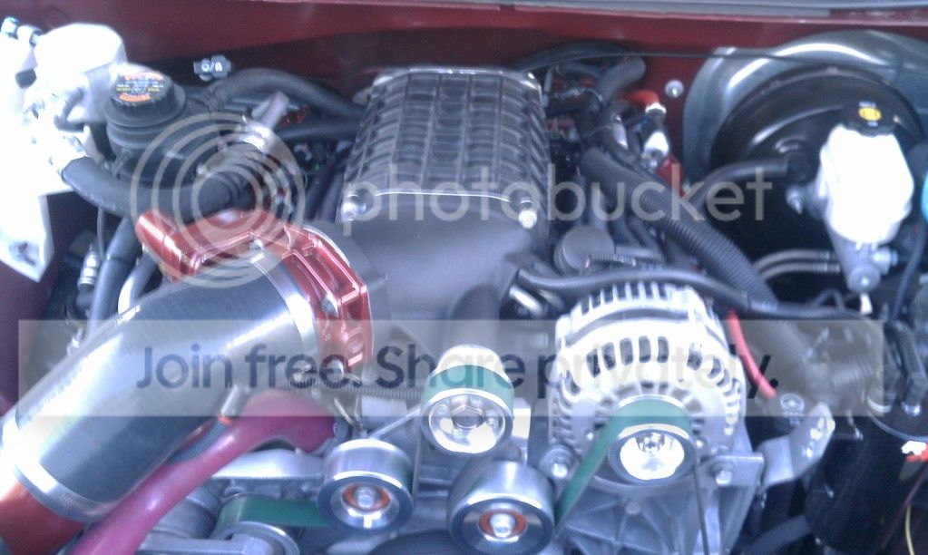

2008 Trailblazer SS 2wd, Forged 365ci Ls2,11.2 cr,custom cam,Tvs1900 supercharger at 11psi,straight methanol injection,all other supporting mods. I have no idea how much power it makes the 65lb injectors are maxed out and it will ignite the tires at 60mph:eek1:

Nice trailblazer :waytogo:

I like it! Never seen that style of cross over steering b4! Very creative! That center console is cool too! Im suprised you did not put 2 of them together.

I have a duel steering stabilizer Kit, tuff country, I'll sell ya. It would Elimate your bumpsteer. $175?

Thanks,that trailblazer is the only vehicle I have ever bought brand new and I love it.
