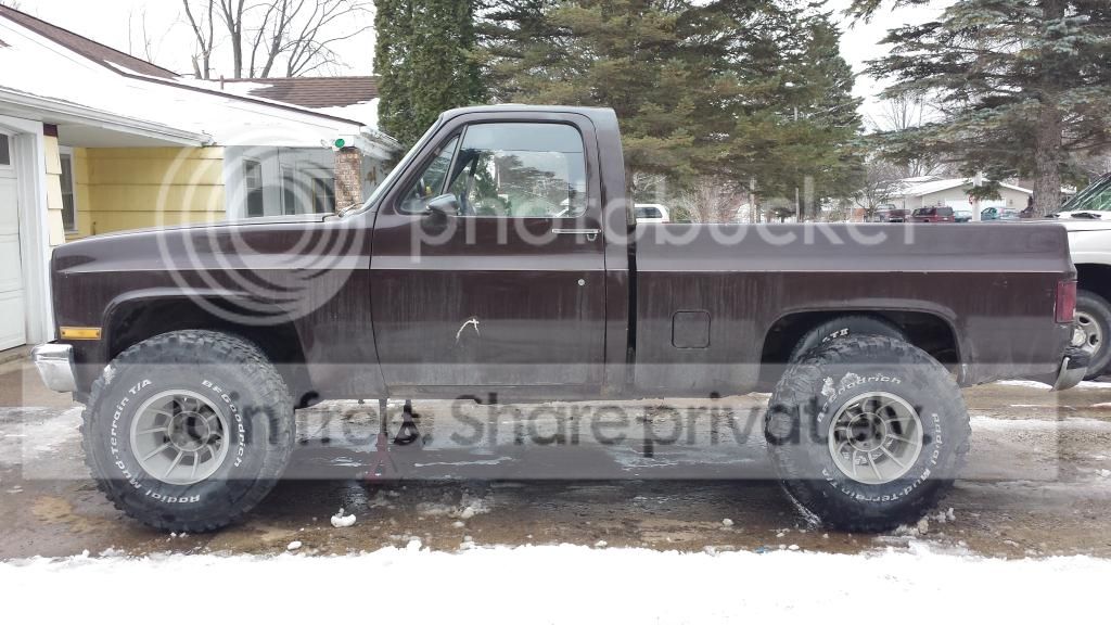

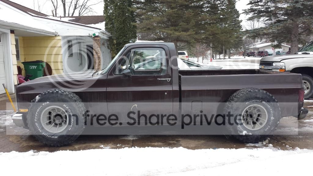

Didn't get the truck in the garage, but I did get a few measurements. Figured out the ride height I want to achieve. I'm thinking that before I can get any real solid numbers, I'm going to have to get the Nv3500/241 in place. That'll let me see where the cross member ends up so I'm not trying to plan my lowers mounting in the same spot.
Took two quick pictures.
This is as high as my small jackstands would go, my big ones are holding up my Camaro. Truck would be 1-2" higher.
This is mostly for my benefit:
Bottom of frame at ideal ride height. 20"
Move front axle forward 1"---wheelbase 118.5
