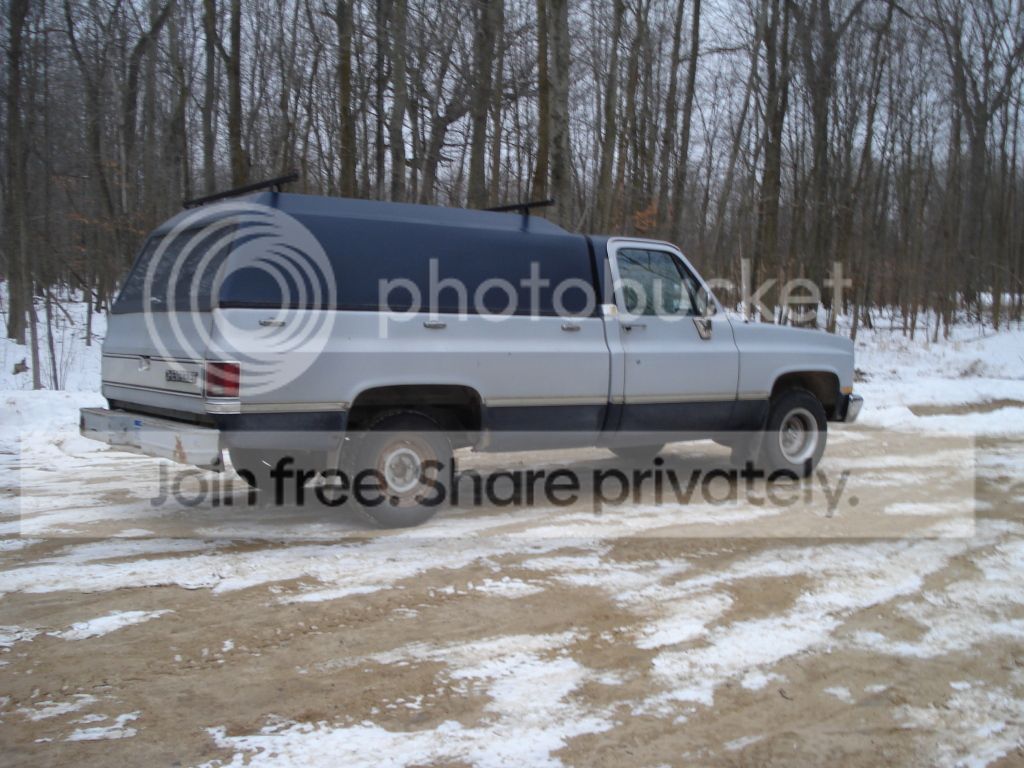

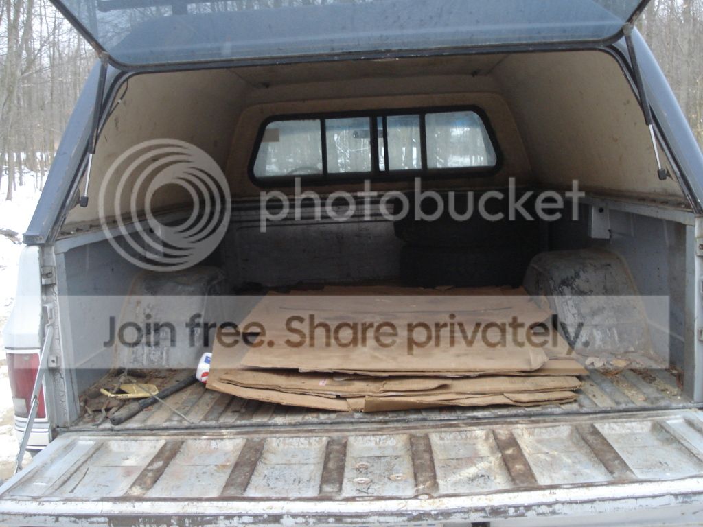

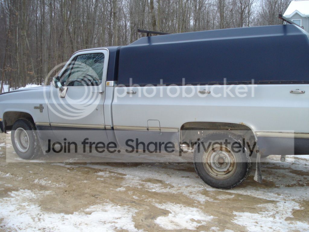

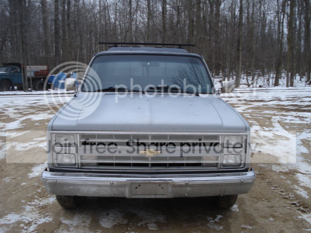

well the burb is gone, i remembered pics of it, but by time i remembered pics of the new truck it was dark. i was having to much fun driving it!! :haha:its an 85' c10 with a 250 straight six and a th350. one tiny rust hole behind p side rear wheel. also came with a grandpa style fiberglass topper. heres the pics of me towing the burb to the guys house.

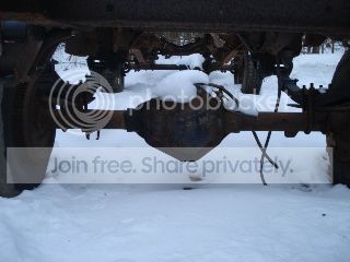

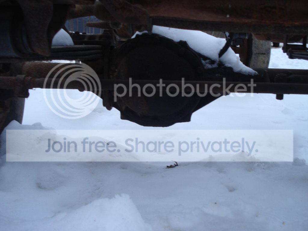

the two rallys for the back, as you can see one had a bad belt so he threw on two others he had

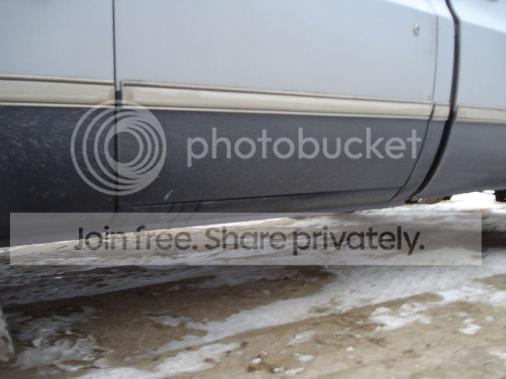

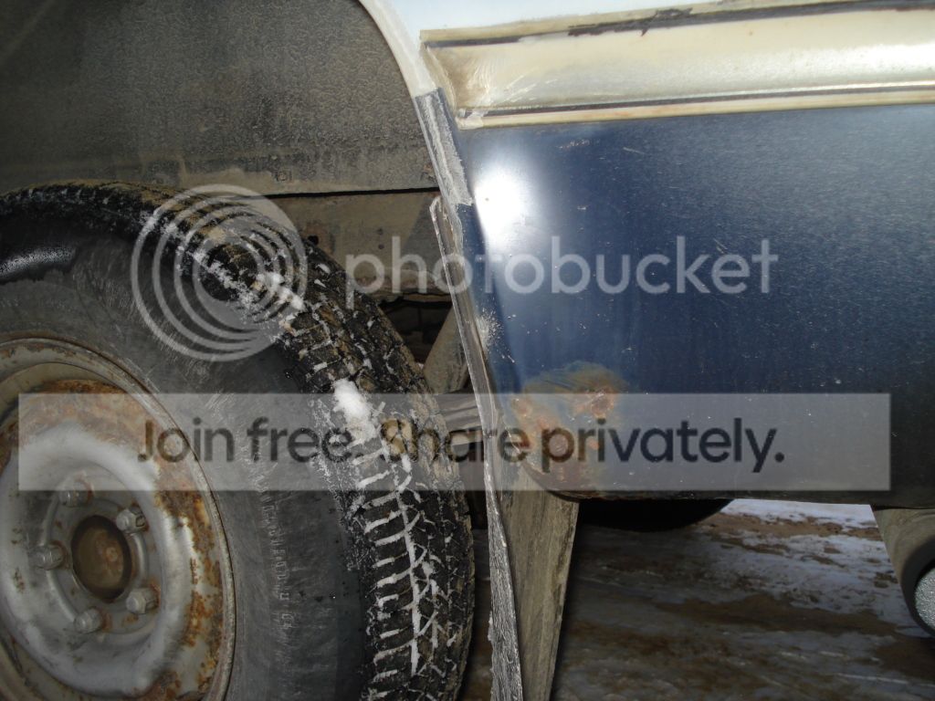

both spot behind the rear wheels were a tad crusty but not bad at all

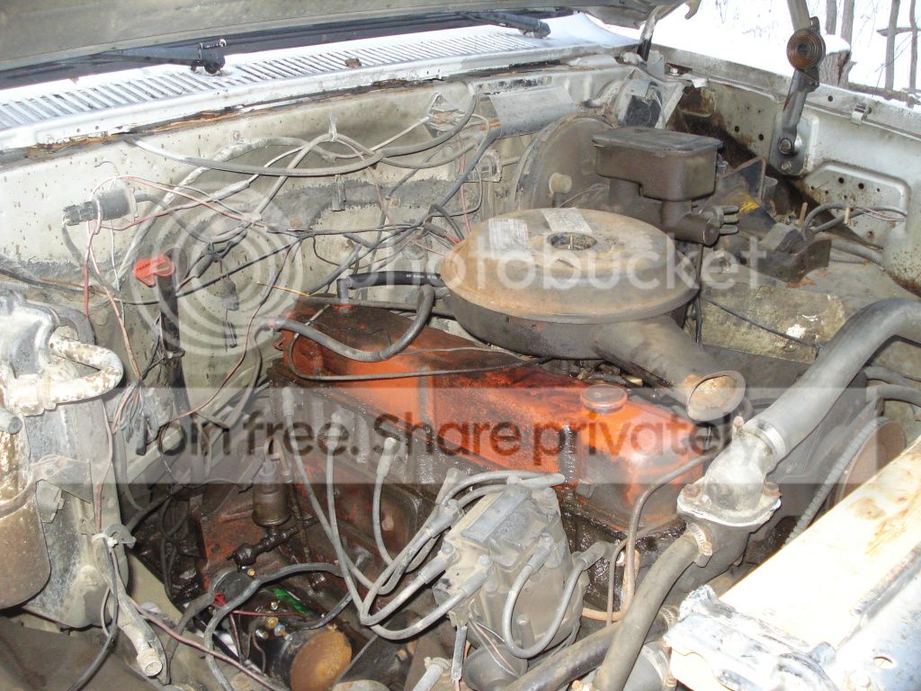

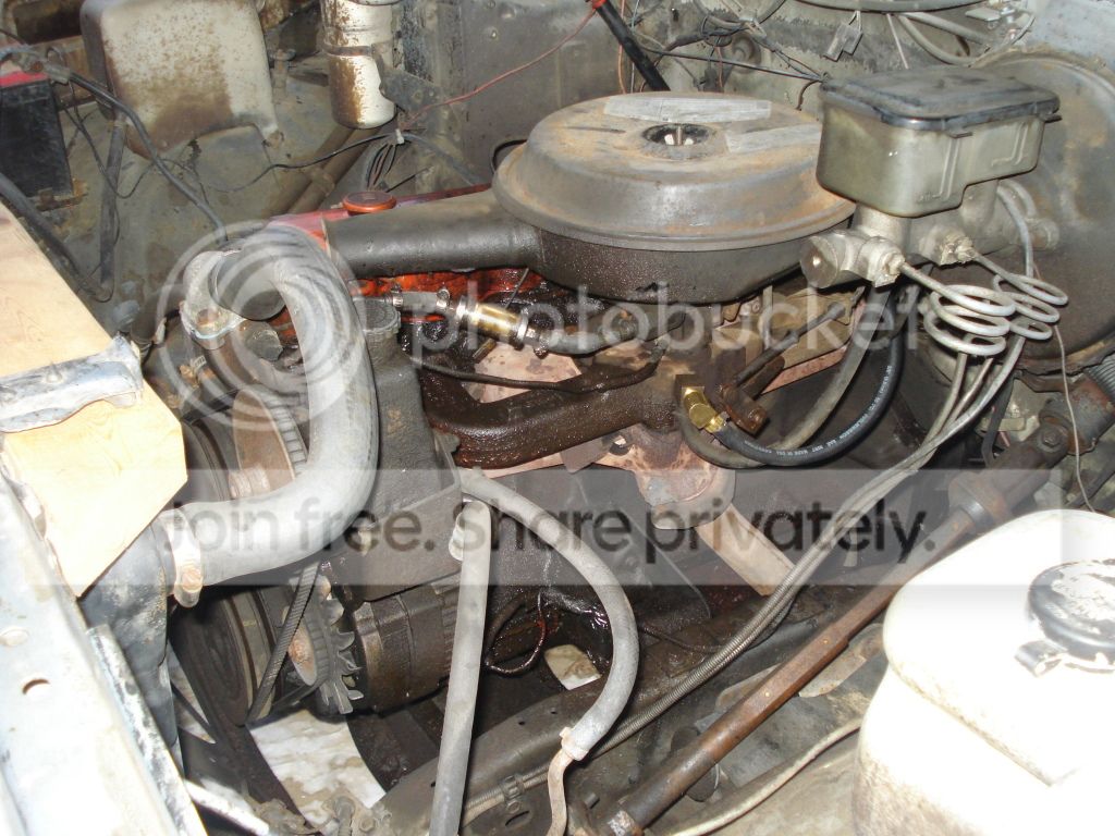

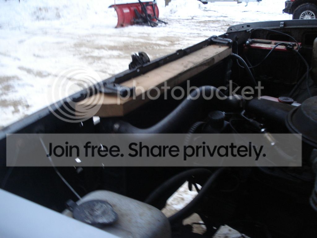

the monstrous 250 inline 6, PO didnt have the PCV hooked up so it kept puking oil out the breather

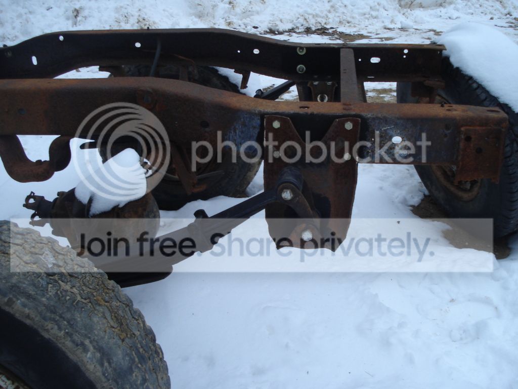

PO was nice enough to replace the rivets with bolts when he rebuilt the leaf packs/bushings

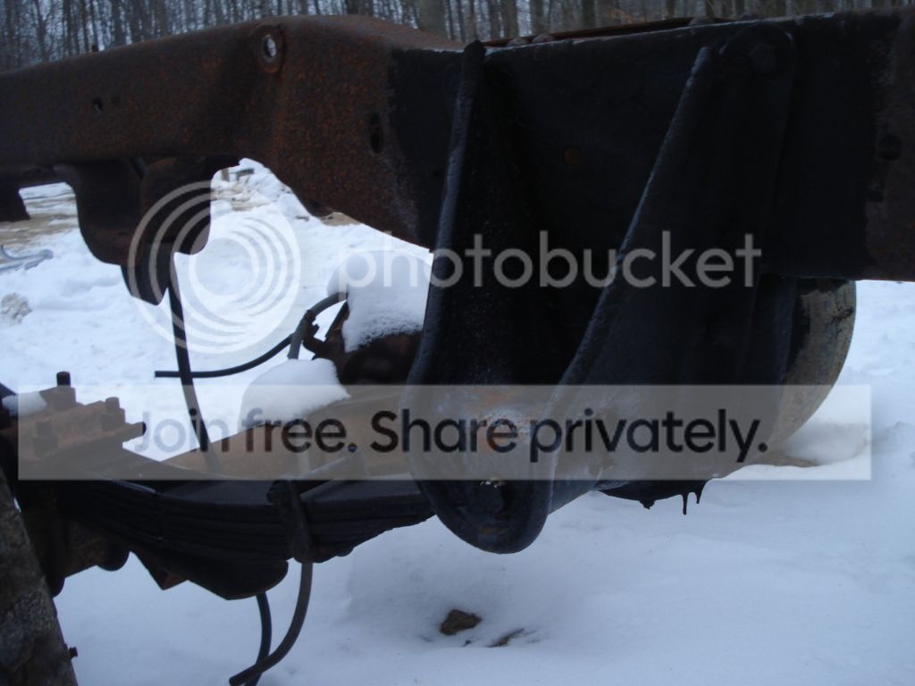

not necessarily a bad thing but he welded round stock all the way around the rear front hanger..

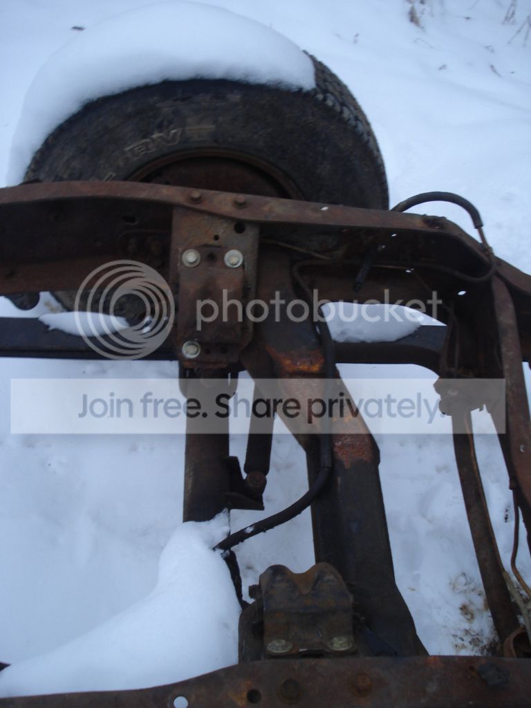

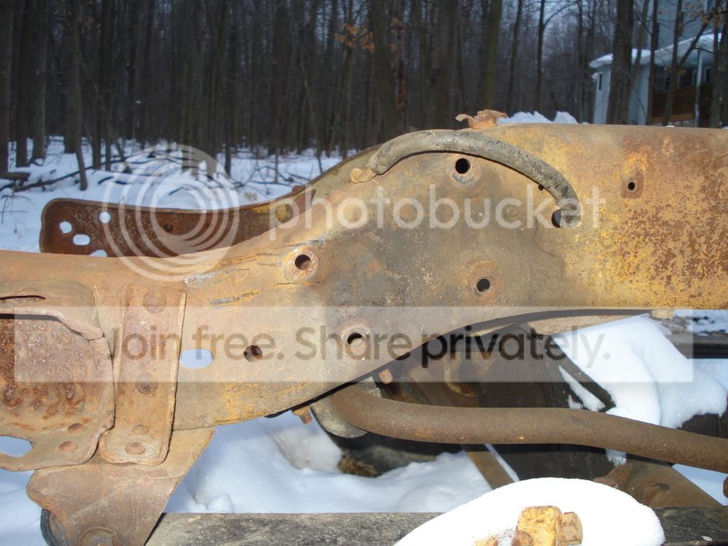

crack free,as you can see the one body mount is messed up
PO notched cross member and moved p side mount forward to fit a 292? i believe it was

The C10 i was told burned/leaked oil and needed to be check every other day...was looking under the hood and they didnt have the pcv valve hooked up so it was puking oil out the breather they had jerry rigged up! fixed that, no more oil problems and it runs even smoother than before. i think the C10 is going to get licensed while i work on the frame. will make for a good parts runner and DD. this things rides and drives like a caddy, to nice to just park until the body is needed.
