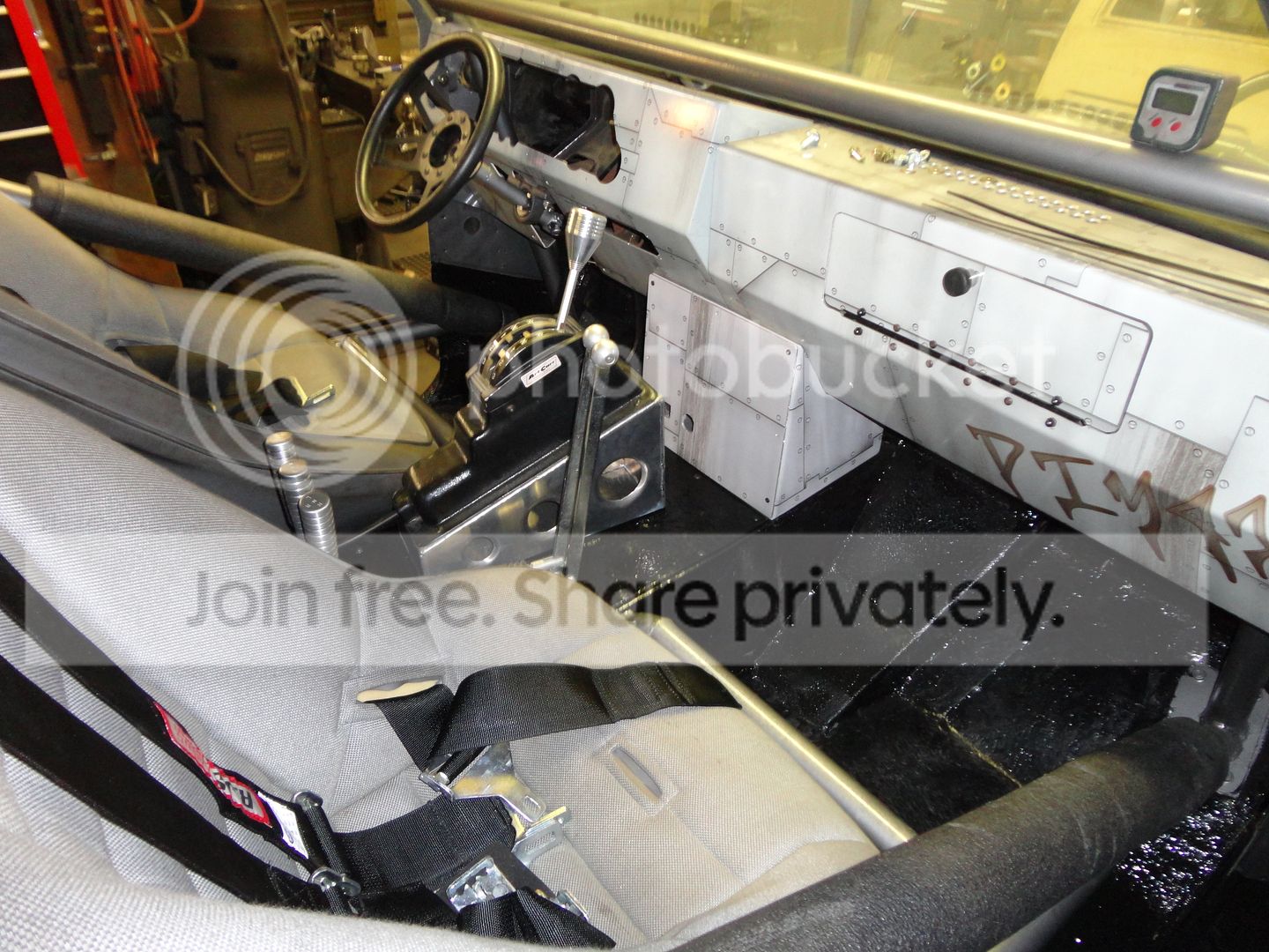

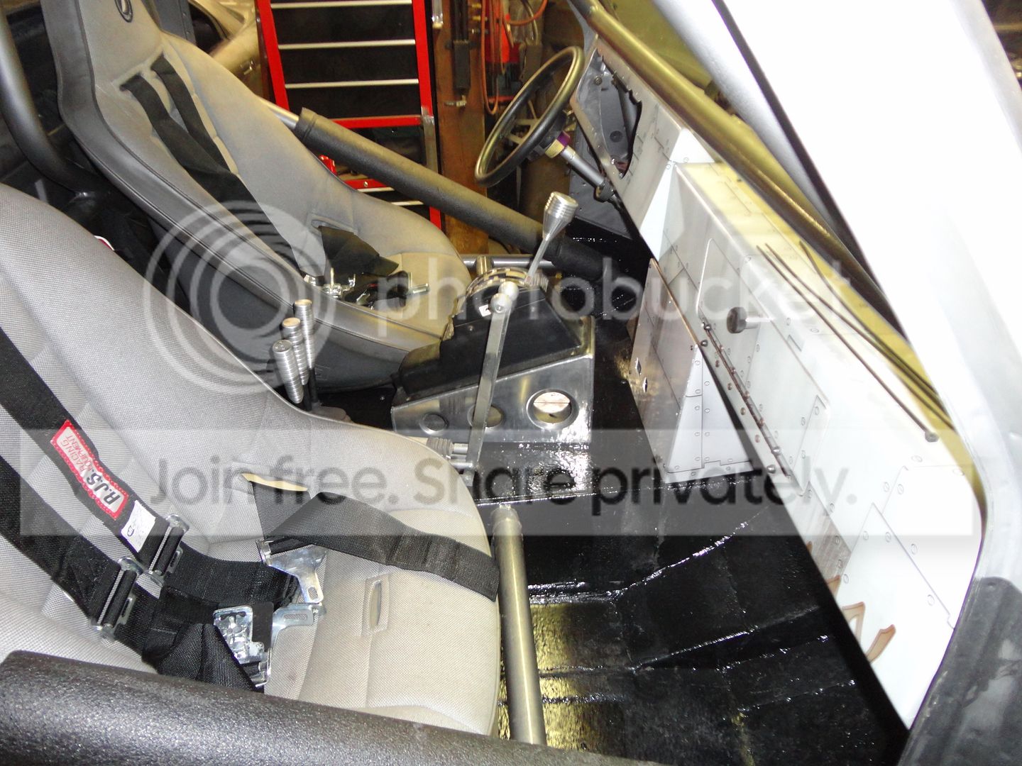

Final mounting. Just need to set the cutting brake in place and put the seats and harnesses back in. Hopefully tomorrow night.
My kids firebird is a success as well. Heads are off. Got to get a couple broken manifold bolts out of the head outside of that, I think he won the day. And they did come out the top.
Seats in, seat belts in loosely.

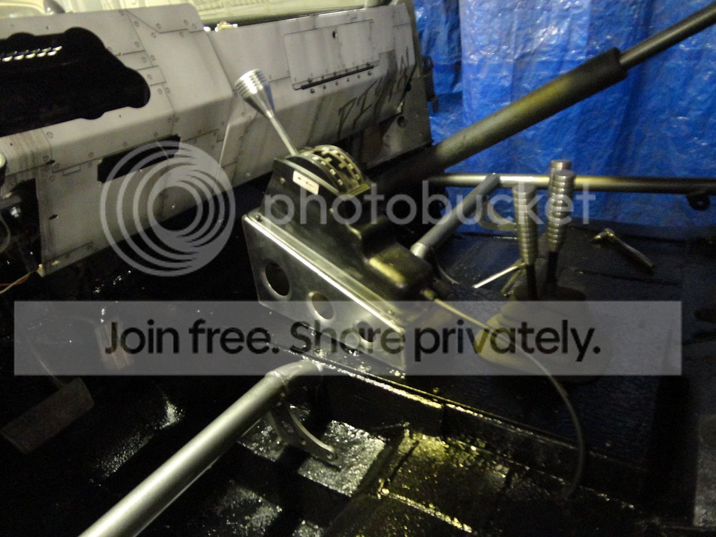

Shifters are in and cable routed and all adjusted.

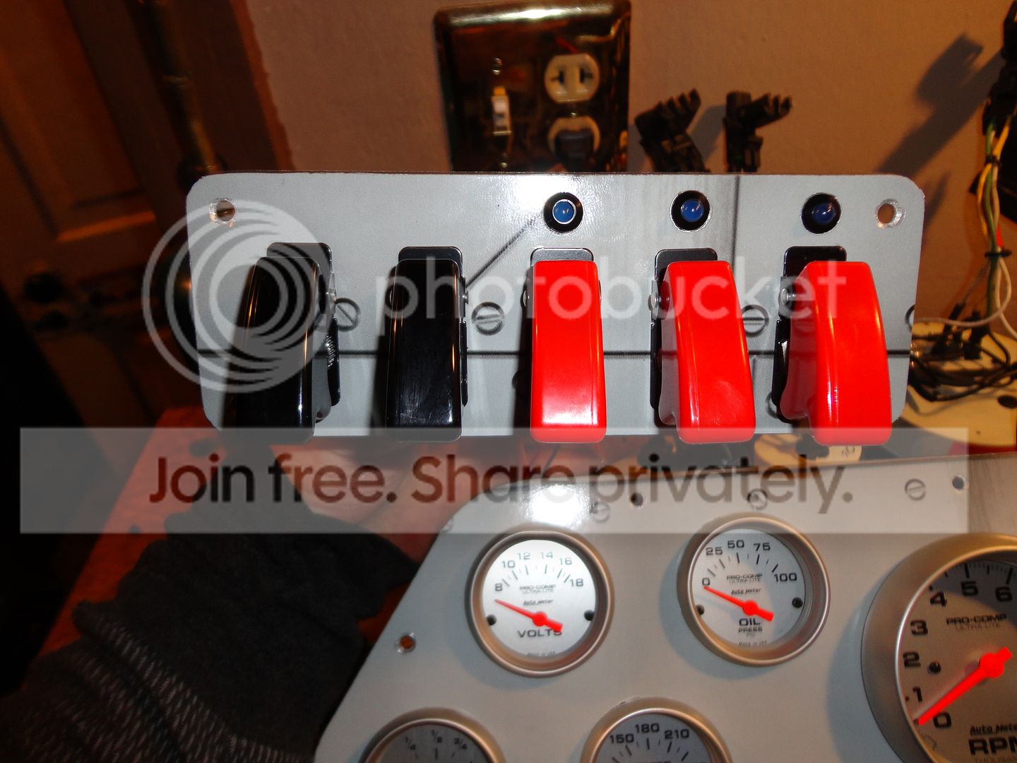

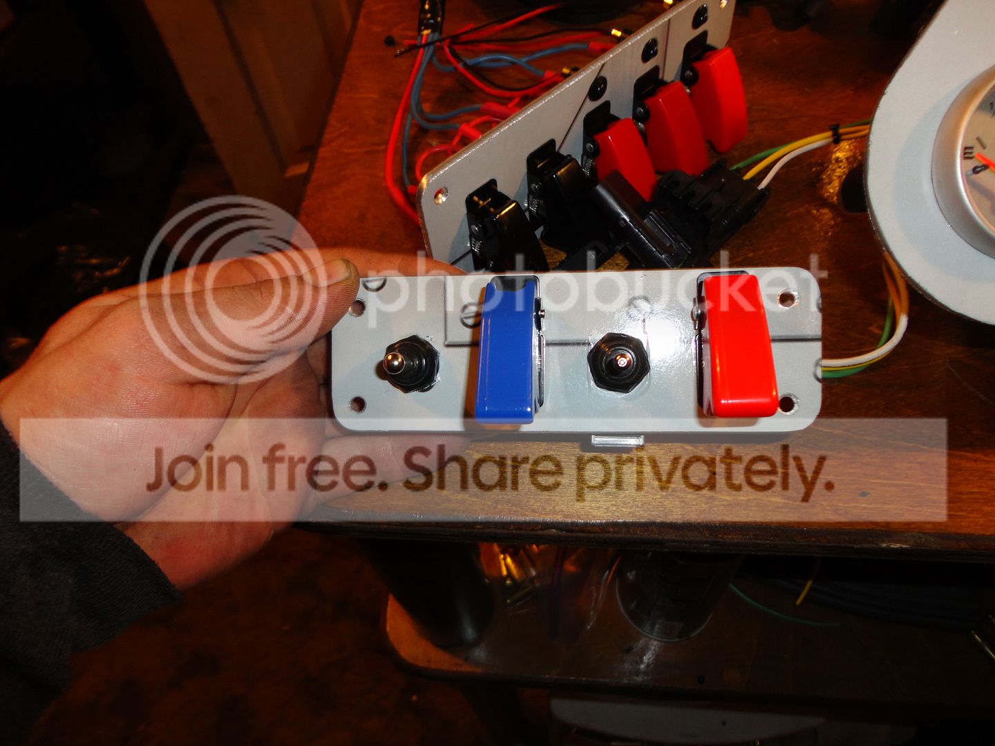

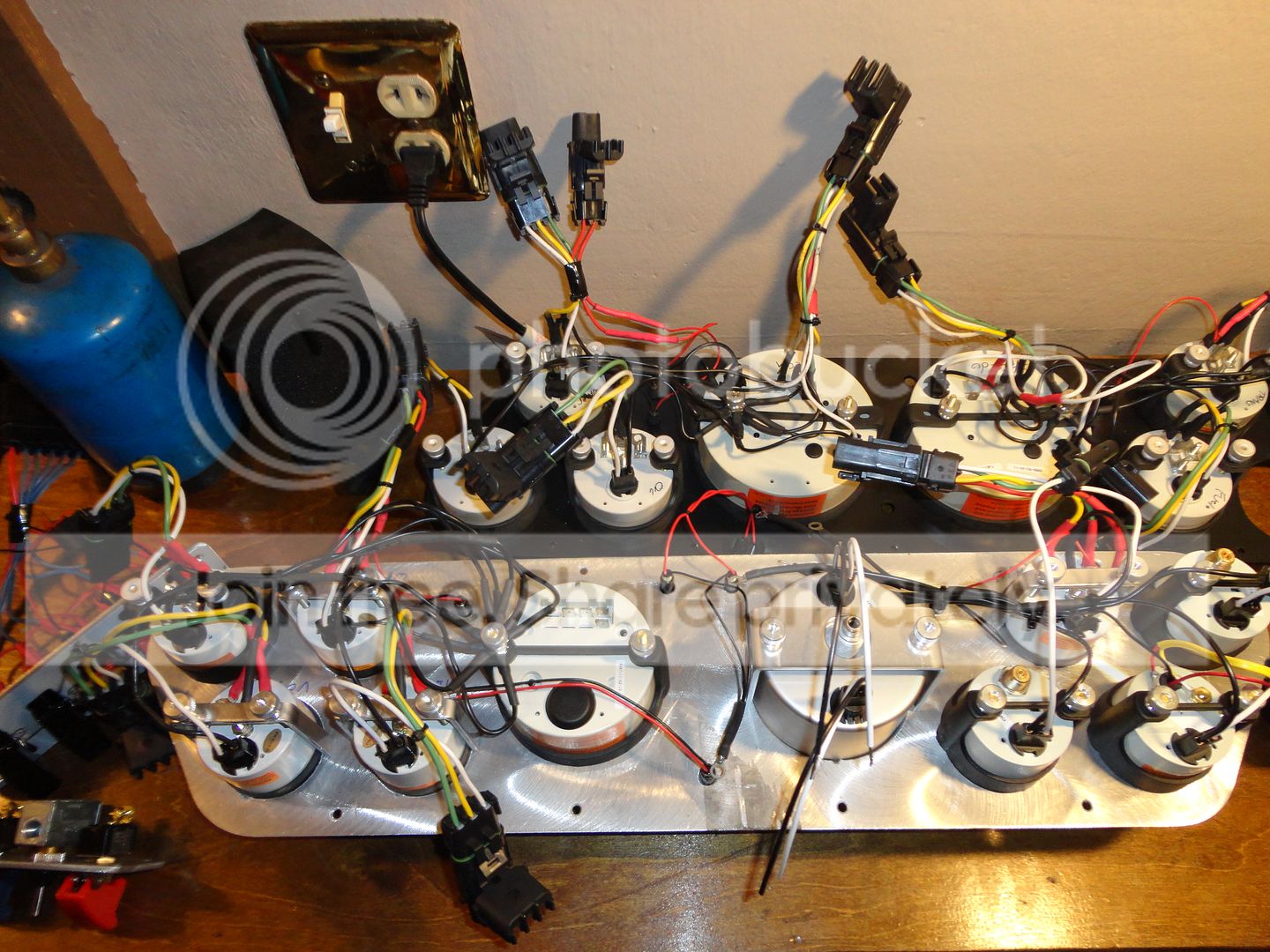

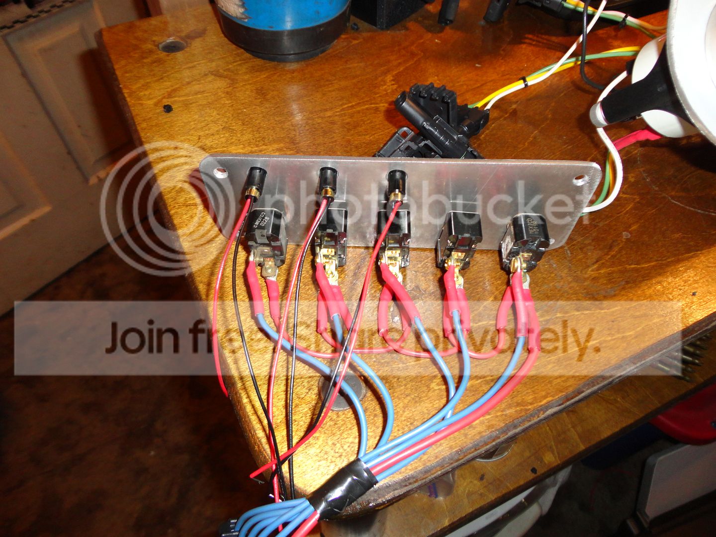

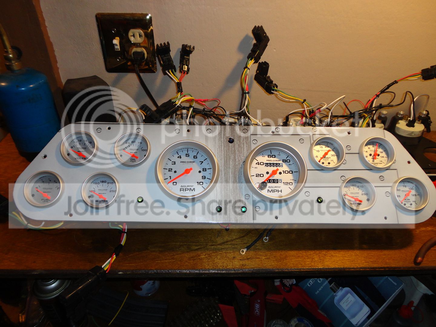

Tonight I'll get the last two gauges in the panel and the wiring for that completed. It's all done with weather pack connectors so it can be easily disconnected and removed.
Same goes for the two switch panels.
For a truck that hardly needs any wiring to run, its still a lot of wires.

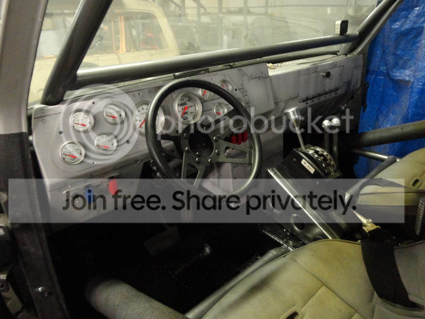

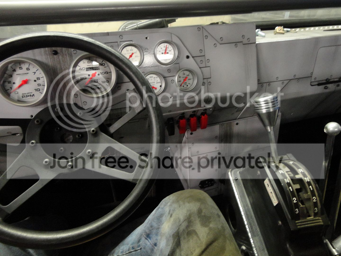

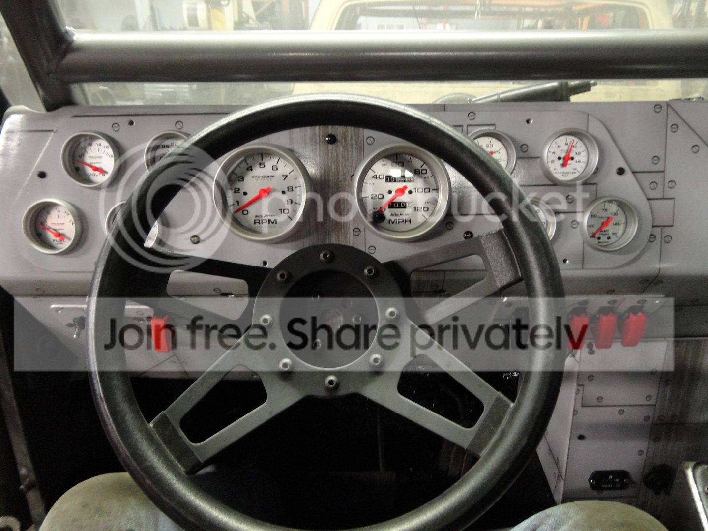

Today I should have pictures of the dash with all the panels in place. At least enough for pics. Wiring is gona take some time to complete but I can set the panels in place and get the full feel of it for the first time.
Gona be a busy day!
