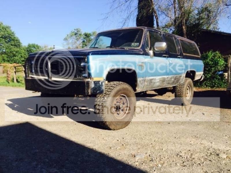

So as advice of some guys here on the forum , they suggested to start a build thread... so here I am ...... here's the specs:
86 chevy suburban K20 3/4 ton
6.2 diesel with banks sidewinder turbo kit
6"lift on 315 Dean mud terrains with tons of tread left. 4 in turbo back straight pipe. 4.10 gears, TH400 transmission with upgraded shift kit. HD front bumper.

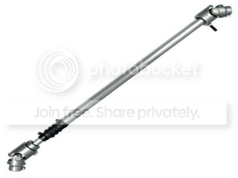

this looks like the fix for the steering ...
http://www.xtremediesel.com/Borgeson-000935-Extreme-Duty-Steering-Shaft.aspx
The Borgeson 000935 Extreme Duty Steering Shaft for your 1979-1994 Full size Chevy & GMC features a heavy duty telescopic design. This shaft connects from factory column to steering box and features an extreme duty design with two billet steel universal joints. A Borgeson heavy-duty truck assembly will fix that loose, wandering steering for good.

In the tech section theres a write up on how to tighten up steering using an xj jeep steering shaft which is essentially what that company is selling at 10 times the price. Not sure if you've checked the steering slop set screw on the steering box yet but that may be enough to tighten things up.

Check frame for cracks around steering box also. I wouldn't mess with the adjuster on top of the steering box yet, do that after everything else is tightened or replaced. Have someone saw the steering wheel back and forth while you watch steering components. You'll find the slop that way. Like said, XJ shaft for sure. Easy and saves you money for all the other stuff you'll need to buy.
