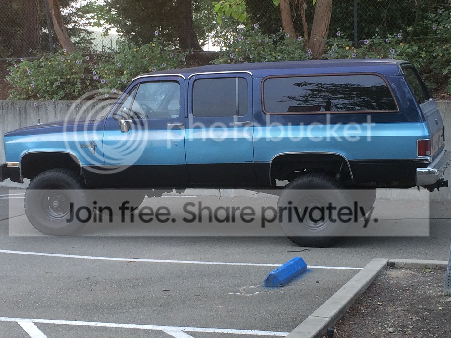

at least it's lookin some better with the wheels painted, lower body panels , etc... but need to splice the e brake cable , need bigger connectors the ones I got were too small ....you can see it hangin in the pic
took the steering column apart and when I got down to the barrel in the middle of the column , it fell apart ... now the steering box and draglinks are bad too ....so as my original statement about needing to replace the steering box and other stuff looks like I was right ... so who has the best price on steering boxes and draglinks.... had to get a rebuilt column for $383...
