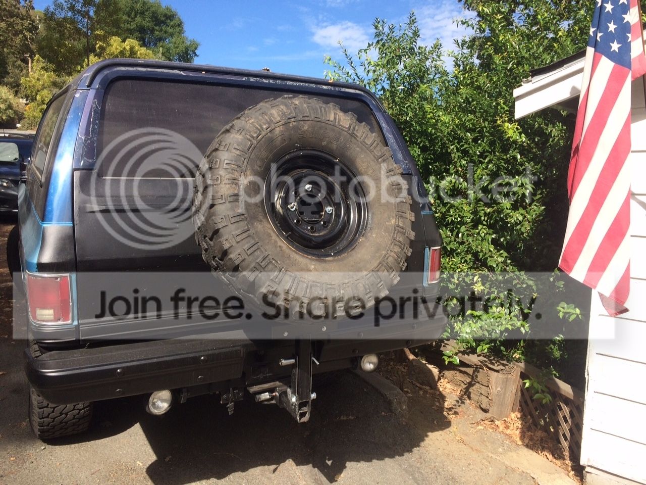

so finally got my home made spare tire holder mounted....
