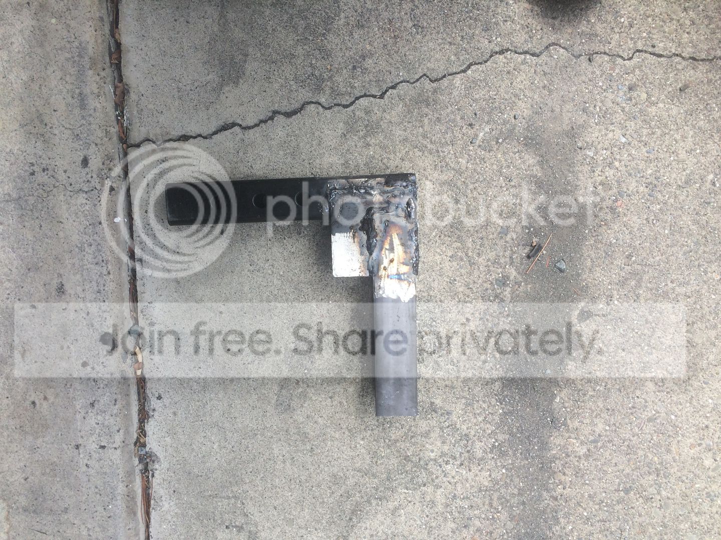

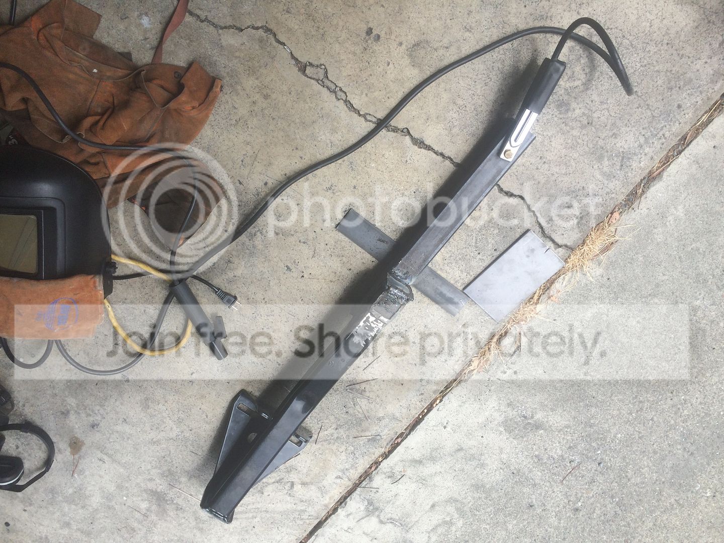

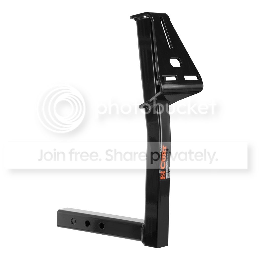

But I bought the Curt mount for $75...but it's too short... so I got some 2" square tube, and some plate and welded it via my little Inverter welder with 7024 rod...the welds aren't the best , but'll work ... still need to drill 2 holes in the side of the plate ( upper for lock pin ) and (lower for bolt / hinge). But for around $100... it oughta work and will have a fold down tire carrier so I can still utilize the back of the burb...I assume just a bolt with flat washers will work for a hinge ???
this shows the bought mount , then the added length, etc. , fyi thought step mounting the 2x2's would be stronger than butting them ...

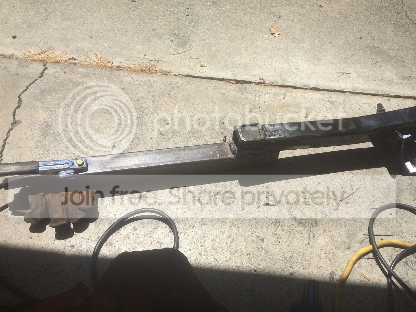

so I haven't had the time yet to finish welding it up ... but I'm gonna be adding 2-2"wide x 5 or 6" long strips to have the coupler lock locking it upright, then at the bottom of those strips drilling the 5/8" hole for a bolt to act as the hinge, then another short piece to weld in front of the "arm" to stop movement forward, then more flat strap welded for a license plate mount, then 2 small pieces to cap the open ends of the square tubes....

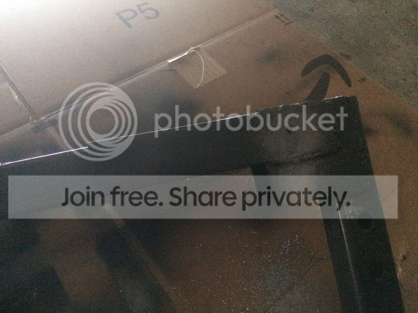

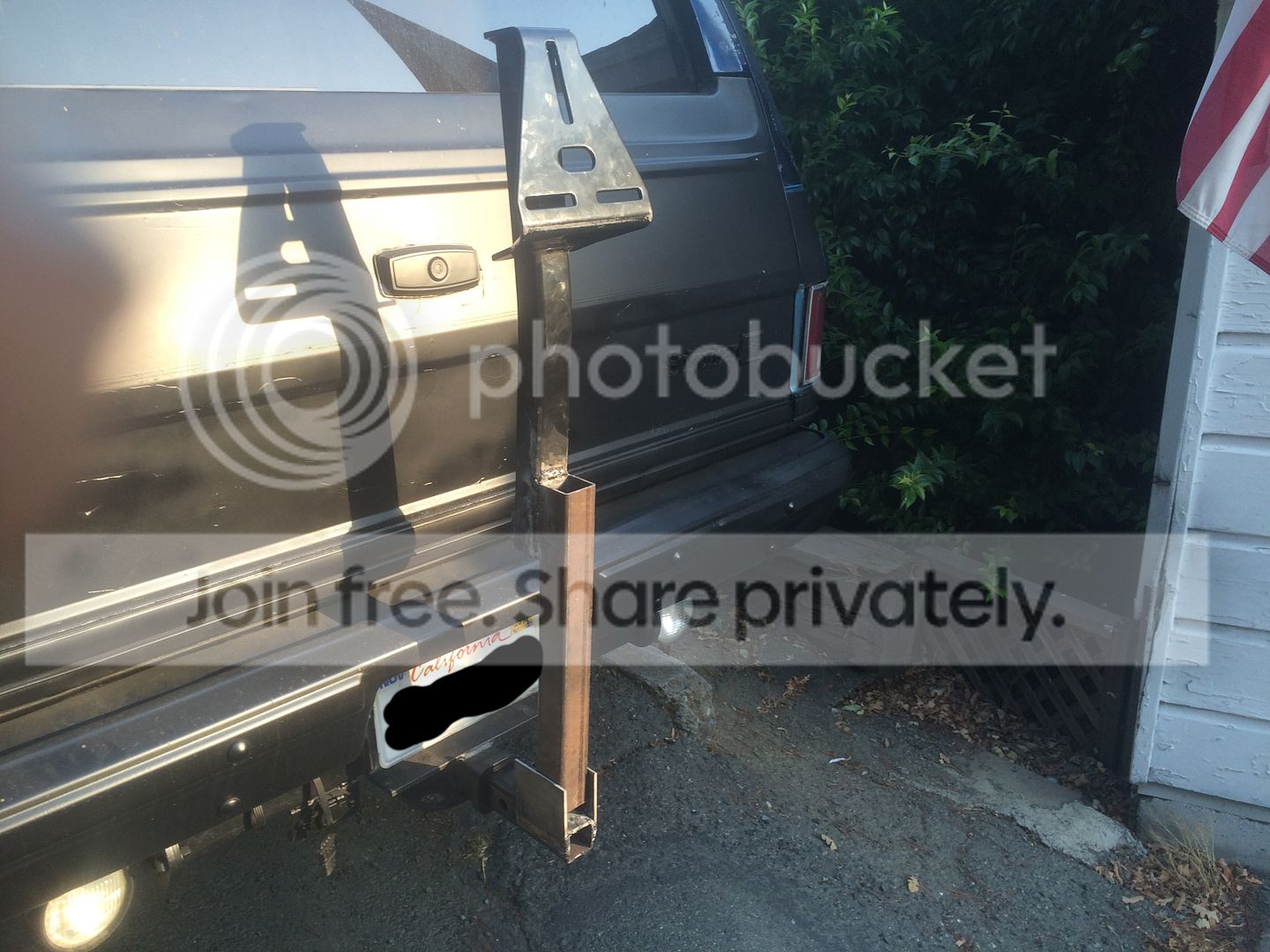

I should have welded the top half to the other side of the pipe for clearance to the burb ... but I think welding a forward stop will keep it from slamming the burb's tailgate...I was just thinking ... I better fit it up to the wheel , and see if there's clearance issues... cause my spare is a 36" swamper and the width may end up hitting the tailgate anyway ... hmmm

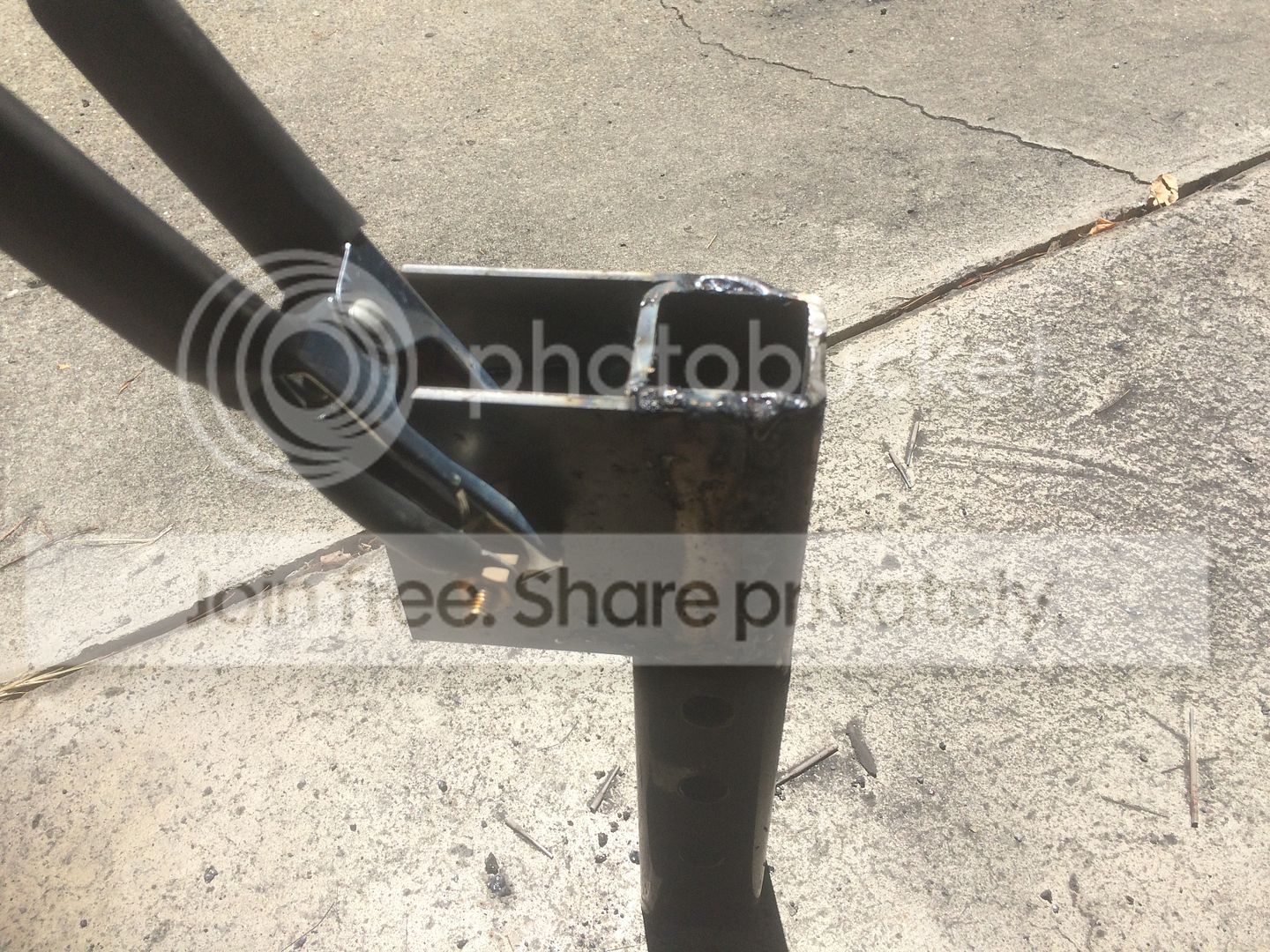

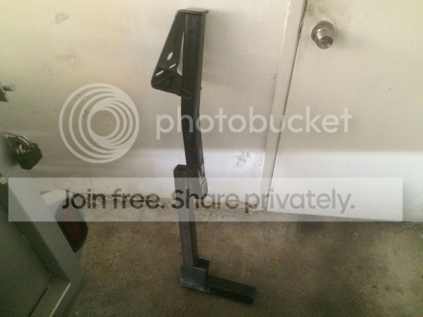

dry run and finished welds...need drill press for 5/8 holes
Tried drilling a pilot hole with my hand drill and can only get so far ... need to find someone with a drill press ! ... lower 5/8 bolt for pivot point and upper 5/8 hole for locking pin. I may also run some angle iron as a stop forward on the mount ( I know the upper locking pin will do this ) , but figured double redundancy...

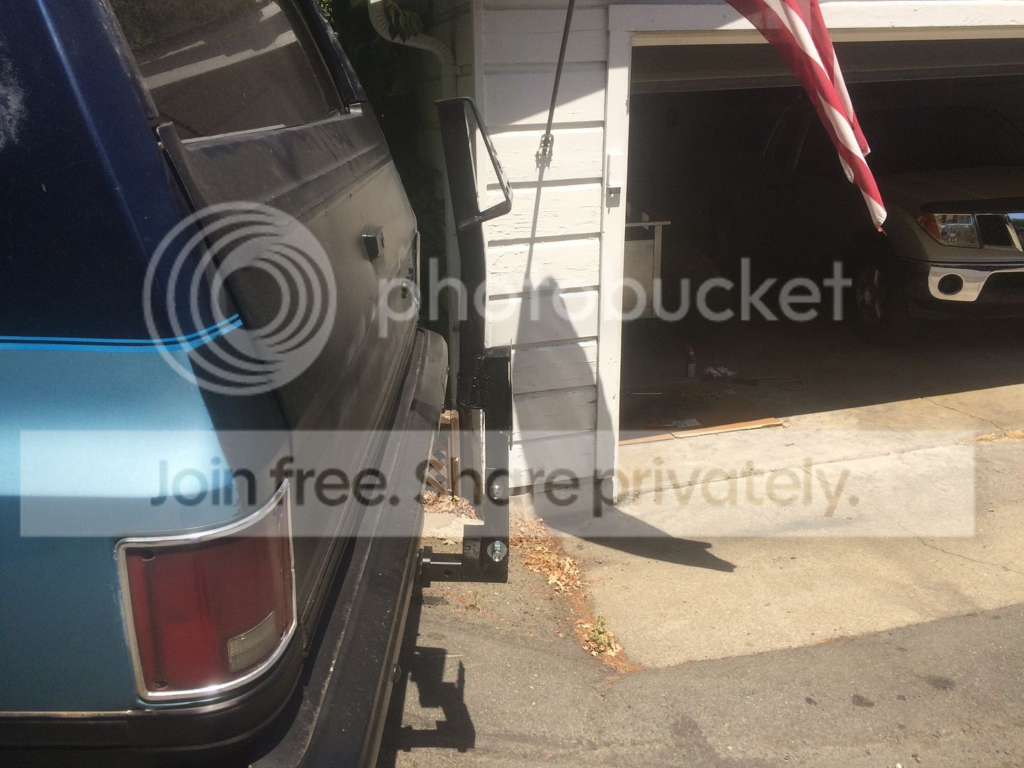

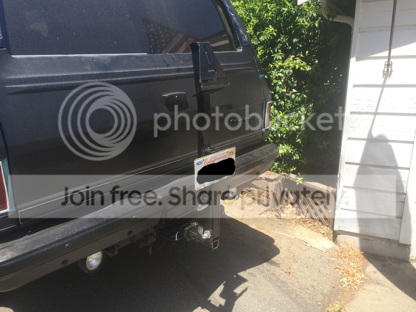

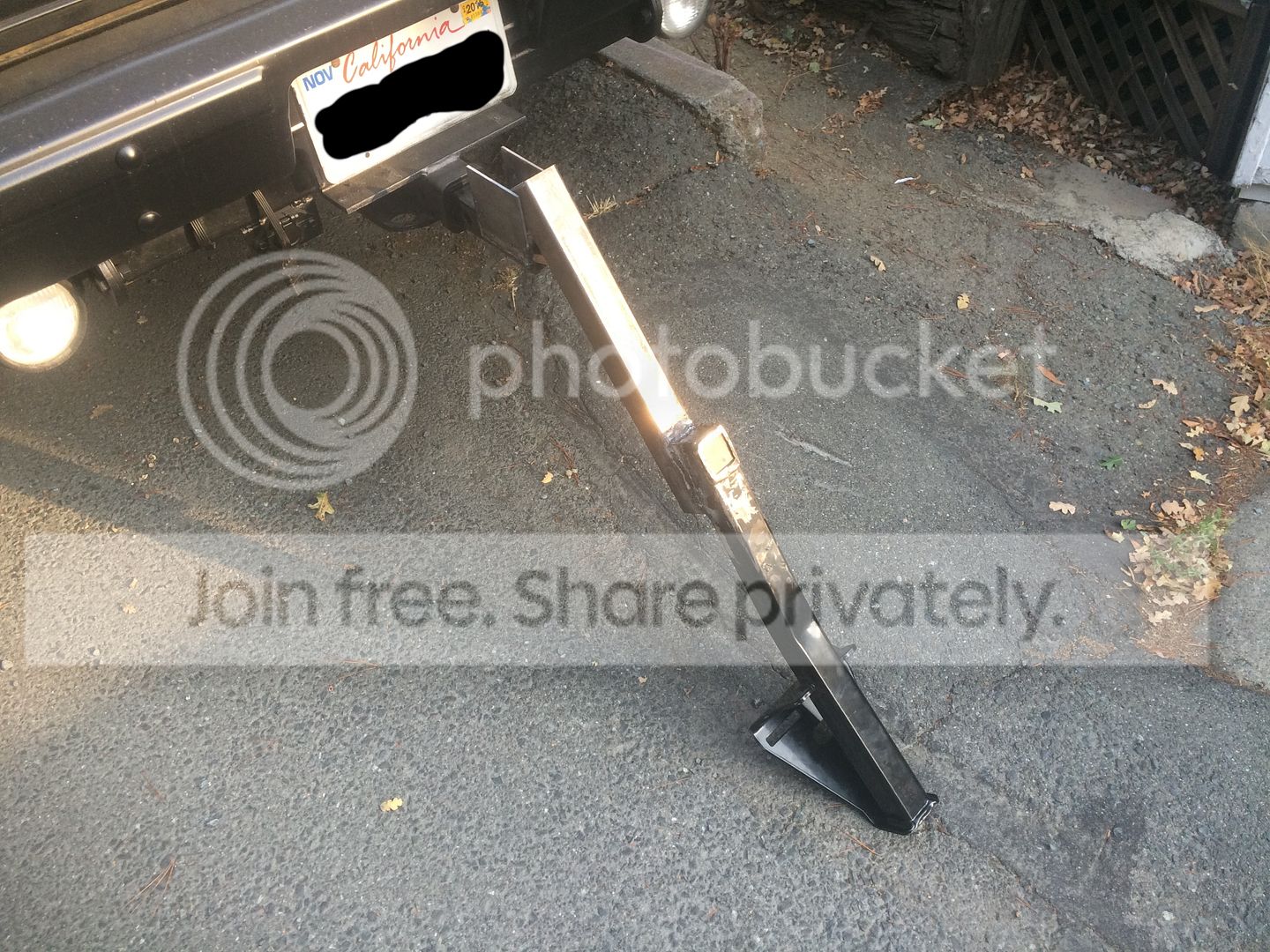

Finished Mount ( Almost ) ...
Still need to cut the bottom back of the arm or the top back of the receiver some to let it go all the way down to the ground, I missed calculated a lil...
