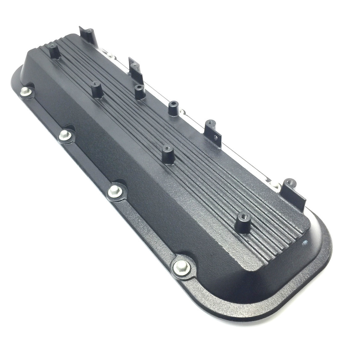

Just ordered a set of OE surplus valve cover. $34 each was cheap enough. And one less thing i'll have to clean up and paint.
