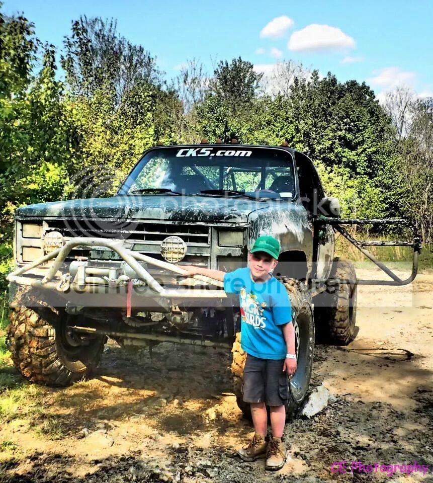

Is the traction bar made of 2x2 .250"? I've got some of that at home and was thinking of using it for a traction bar. Just seems heavy.
Close, 1.5x1.5 .250"
I went with the 1.5" so I could be sure to have a nice even bead all the way around the bushing sleeve. 2" would work, but, I had to buy it and 1.5" was cheaper and seemed plenty strong :D

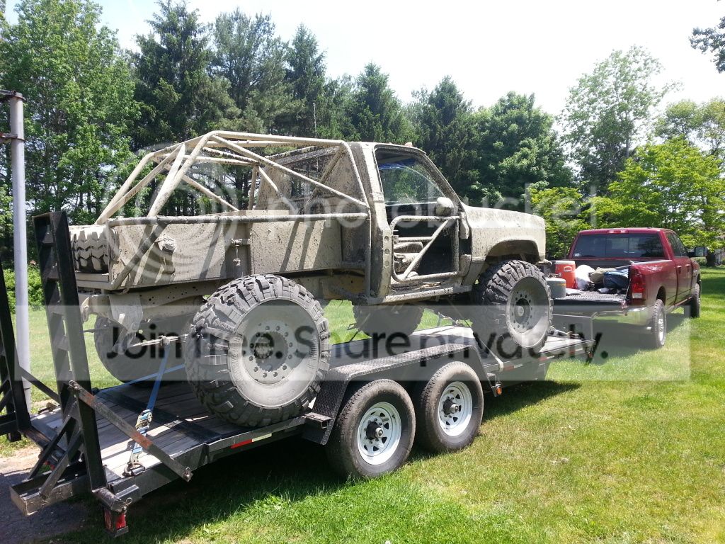

Is that right rear spring negative arched? Kinda looks like it in the pic. Do you have bump stops in the back yet?
Glad all the mods worked well. I'm gonna steal the cab protection idea.

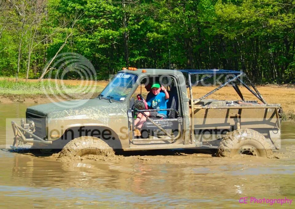

How do you like your Pitbulls in muddy conditions like you just wheeled?
$40 pro comp bump stops aka crappy shocks :haha: I am going to add a bump before next time, as for the spring....it right there, any more and it would be negative :D I think I am going to bump it right there maybe a 1/2" sooner and move the shock mount up an inch for when I do get a decent shock on there.
I will be honest, I absolutely love the pitbulls !!! In deep thick mud I'm sure a TSL or bogger would do better, but I've never had any problems in mud with these and for rocks, ruts, dirt and street these are by far the best all around "big" tire out ther IMHO.

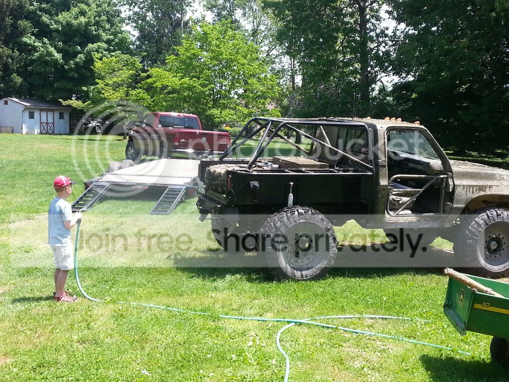

The aftermath
And since he got it dirty...he helped clean it

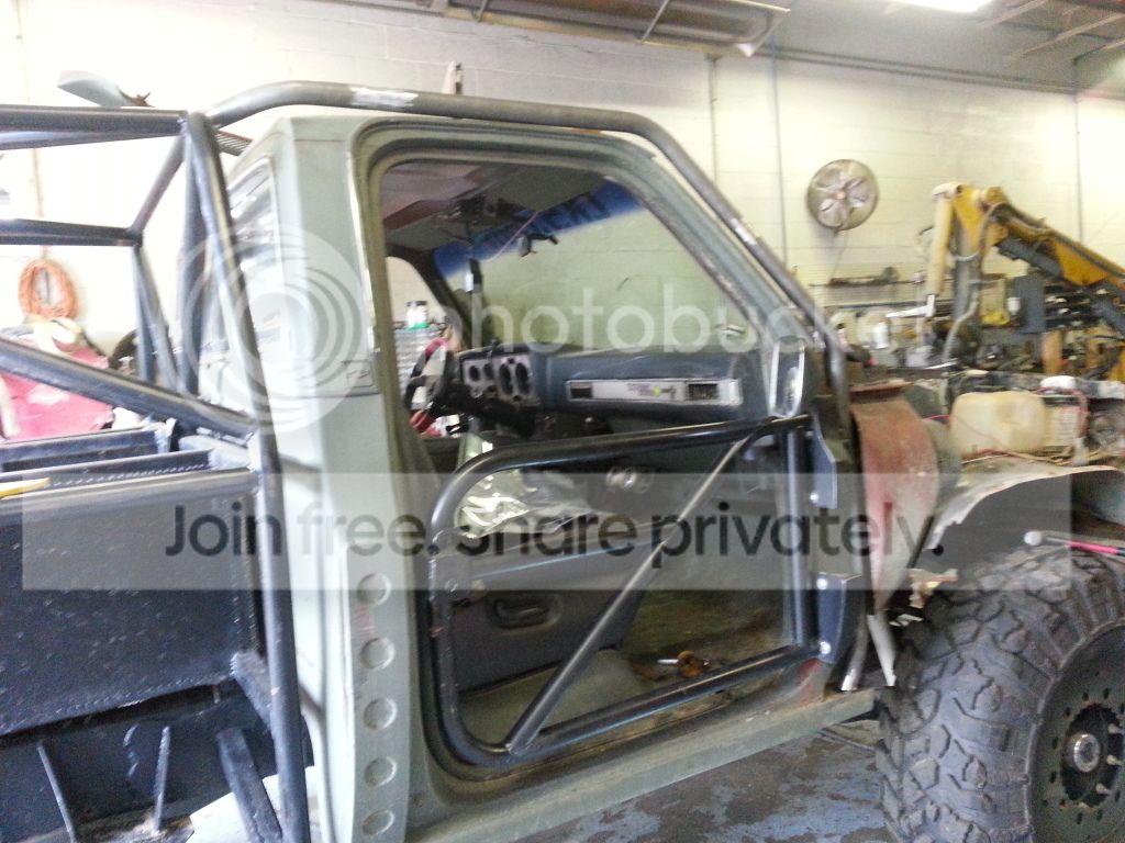

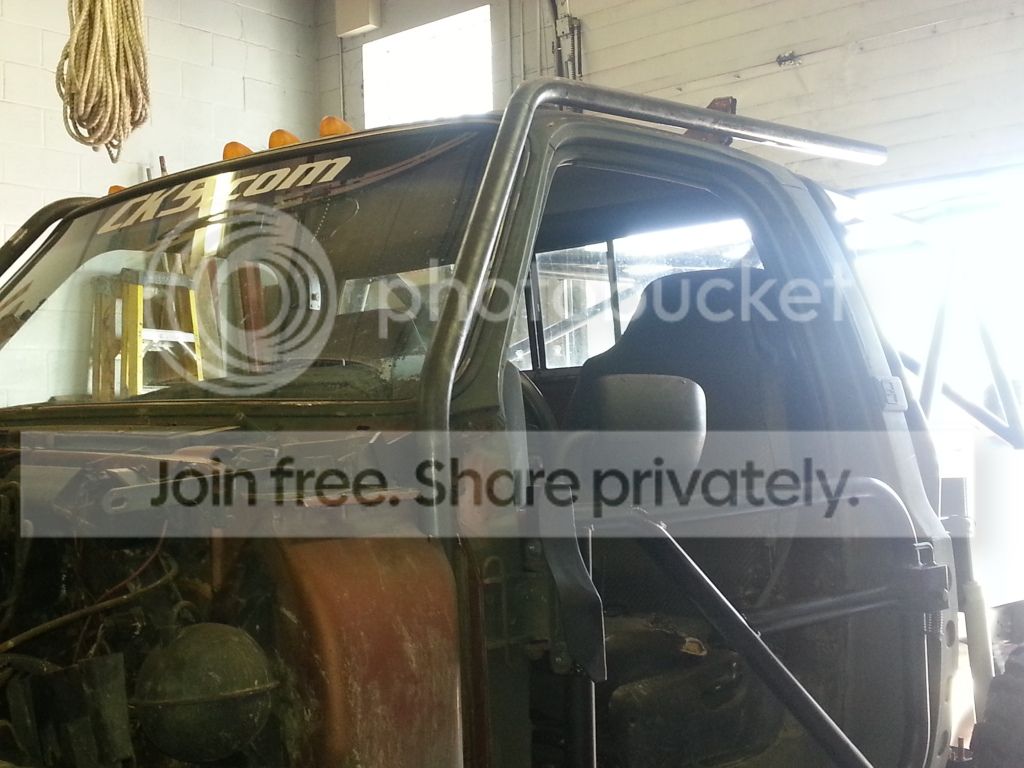

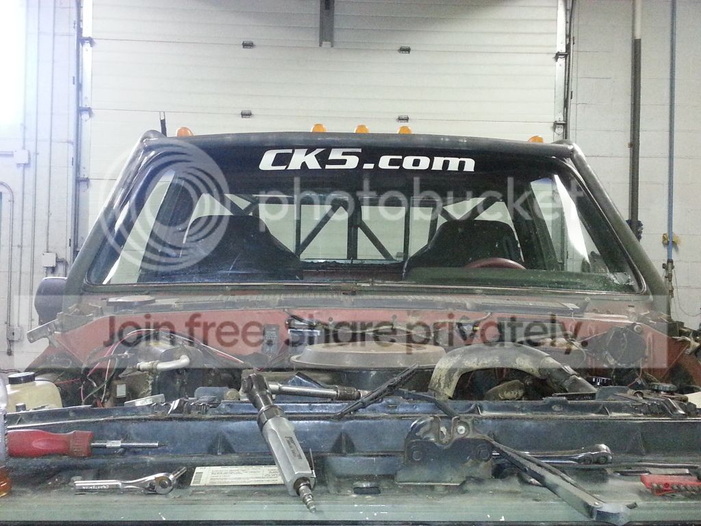

I've got a picture in my head of a really tight fitting exo cage for the cab that I hope to do in the next week or so ......hopefully it works the way I envision it :popcorn:

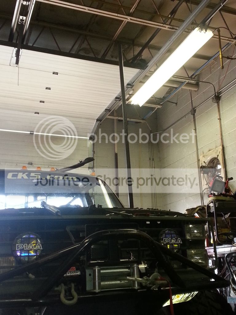

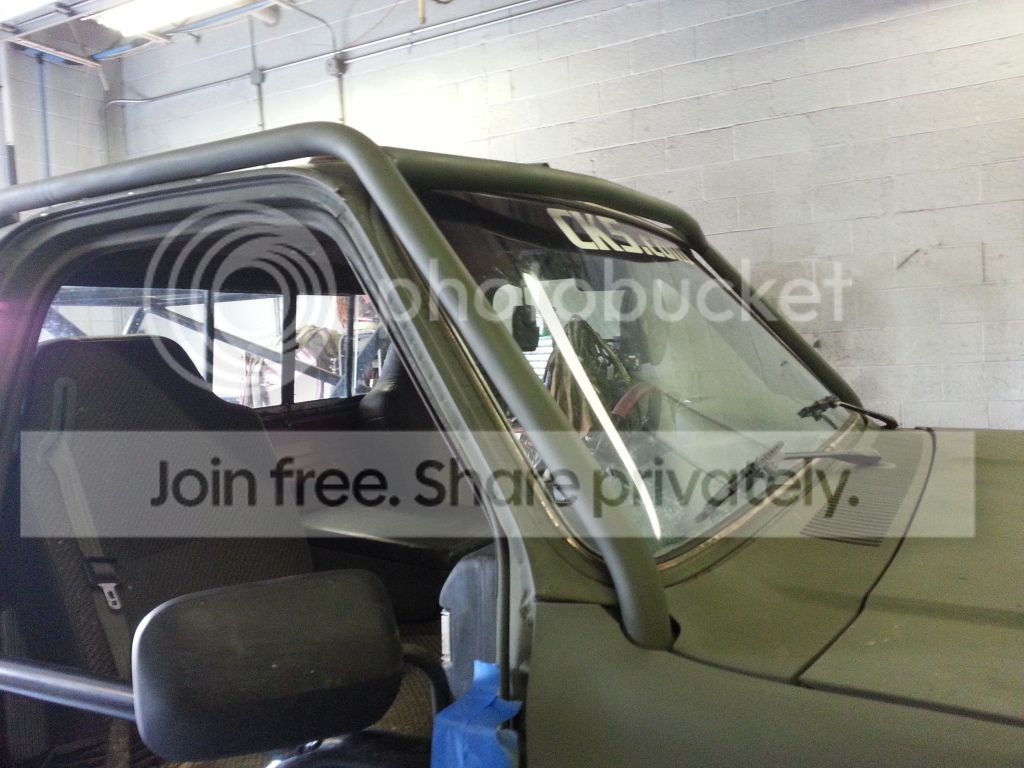

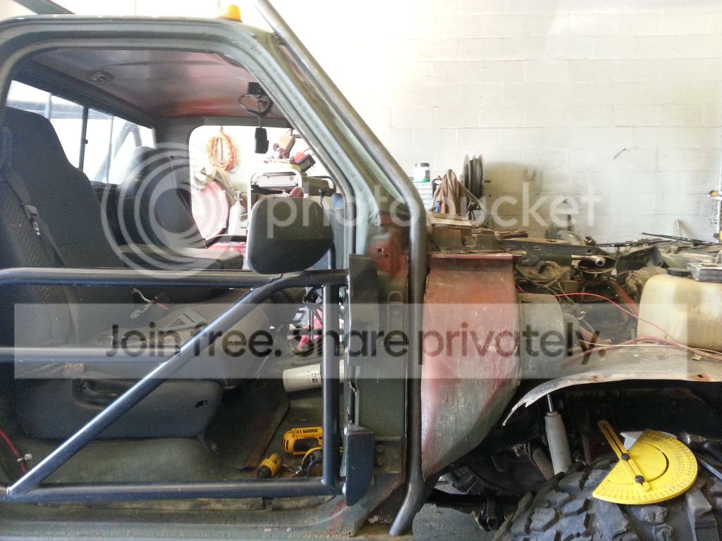

I had a case of the "tube bending bug" so......
Reverse curb feeler :D
So there's my "stealth" exo cage :pimp: I'm pretty happy with it, I have a few things to finish up but overall it worked out nicely...and like the rest its 1.75" .120 wall DOM.
nicely done.. love how that cowl exit point looks... :waytogo:
