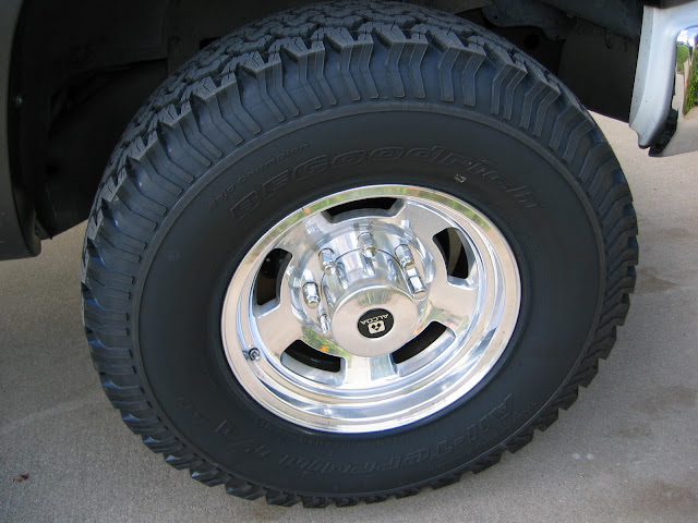

I wish i could track down a set of these (or wish i had taken them off before i sold this rig). The caps say alcoa, but pretty sure they were Mickey Thompson rims.

Which alum slot wheels are you 2 referring to? Pic?
those are cool....
