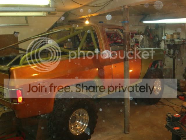

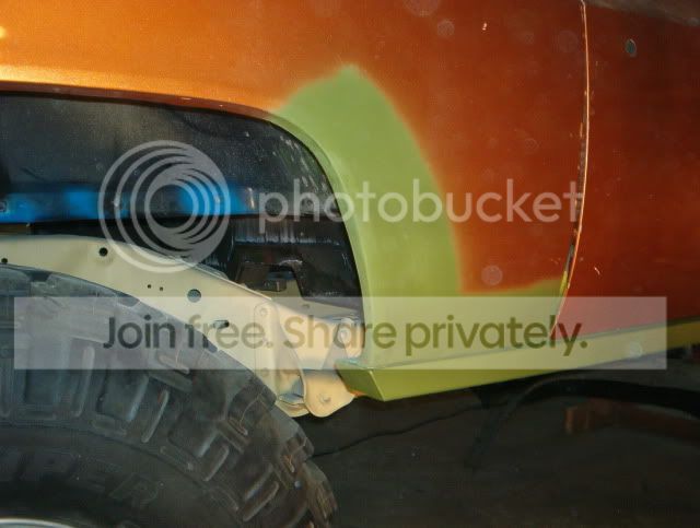

finished up the ps sectioning and rocker... just some more in green.... hopefully in about 2 weeks i'll be covering all the green with some urethane primer, little glazing putty and squirtin some color...
doh! need to clean that lens! :doah::o
I keep looking at all these pictures and I just can't seem to shake the feeling that something is missing. :haha: The tires and wheels do a good job of creating the illusion that the axles are there. I love the work you have done, keep it up.
ghost axles! :haha:
eh, there is a method to the madness... :wink1: no point in hanging em with no gears and getting em all covered in sh*t while I'm finishing up cab work.. even after I get the cab/cage ready for paint, I still need to get back under it and do some finish work on the underside of the floor.. so it'll be a few months yet...
