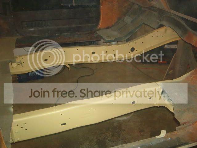

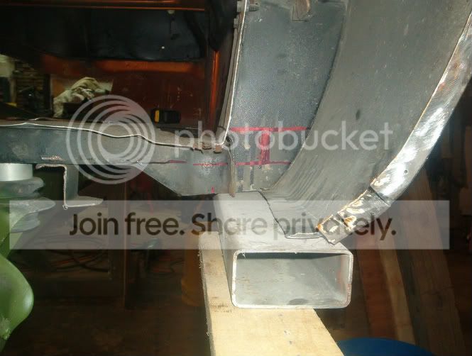

Hey looking back through your thread at when you were cutting out the floor and replacing the supports. I did't see what you were using for supports on the body to hold it to height and keep it from deforming. Sorry for the hijack but I am getting ready to cut out my floor and it would be very helpful. Thanks.
I guess my main concern was that when I cut out the floor the rest of the tub would distort or sag.
I have it supported in the back (by the tank) and the front at the firewall Is that good or should I support it in the middle by the rear cab mount also?
Your floor is the one that I am looking to as I tear into mine. I may be stealing some of your design.
