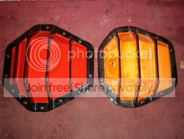

color comparison.........
thanks, me too.... :D

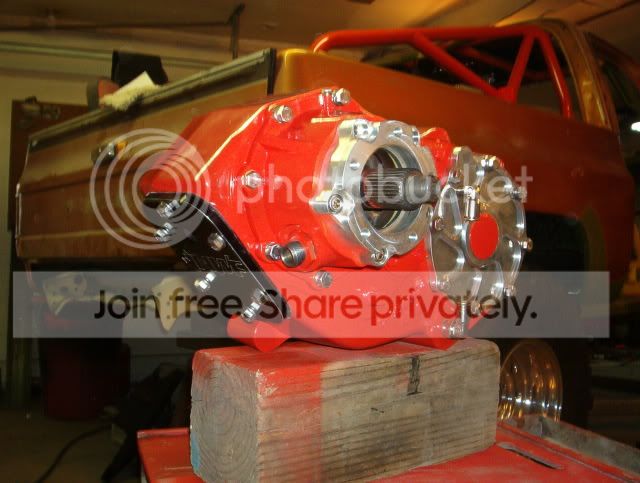

here's a little sneak peak of the 205..... still need a couple pieces of hardware for the cable shifter stuff, and the speedo so I can finish up the output and get the e-brake on... haven't put the sight tube in yet either...
I was half tempted to sand the black anodize off the PTO cover and polish it cuz I'm so pissed at NWF i don't wanna advertise for em! :haha:
boy, those pics are still coming out a little redder than it really is.. definitely more orange in person.. maybe some day I'll get a new camera.... :rolleyes:
That has got to be THE sweetest looking 205 I have ever seen :bow::bow:, of course you also just tripled the amount of cleanup/prep time that I will now have to put into mine :crazy:.

I can just flip the cover over. but it has some ugly machine swirls on it... at some point i'll pull it back off and sand/polish it... I'm not worried about it now, it's not like it's a qrter panel sticker...
