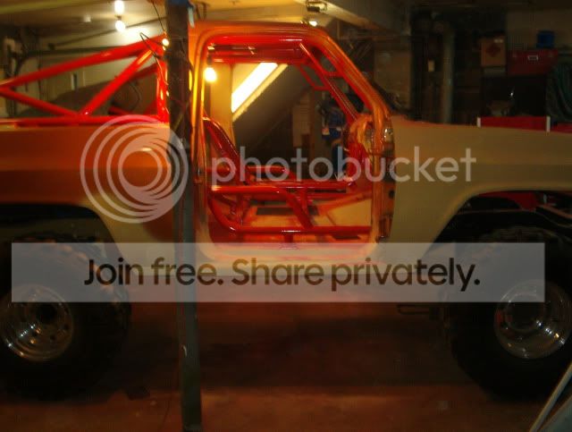

i love the cage its really awesome... gives me great ideas for the future.
thanks, i'm very happy with it.... i had to make some compromises, but it all worked pretty well... I think that lower b-hoop wall got a little overkill, but i was trying to make up for the "climb thru" window..
some of the design features that I'm really pleased with are the a-pillar over the door style, thru the dash, the grap handles... how the side seatbars kinda mimic the seat shape.... the console flow and I'm very pleased with how the back turned out with the angles up top..

it figures..... paint the cage last week... then come up with a brilliant idea for my overhead console that involves messing with it..... :eek1::doah::haha:
not gonna do it now, really needed to plan on this one from the beginning probably.. I'm working out the wiring for the overhead, and the issue of maintenance... as i've mentioned i'm going to make it so the overhead console drops down to a reasonable level, then has a disconnect harness...
started thumbing thru some boat photos i had, and let out a "you focking idjit" :haha:
what i should have done was made the front edge of the panel hinged... :doah: that way you unbolt the 6 countersinks and it swings down from the front... probably could leave the snaked harness thru the cage hardwired right to the buss bars i'll have on the backside of the panel.. instead of coming up with some way to have a longer harness, that disconnects..
the problem at this point is the only moderately easy way to do that now with the way the composite panel sits on the tubes, would be to have an exposed hinge.. they do make some pretty cool marine hinges in black that once you open them, you can just shift them over and one 1/2 seperates from the other 1/2 of the hinge.. made for like removable engine doghouses and such...

but i really, really don't like the idea of an exposed hinge.... now to do a hidden one somehow would/will have been tough... here's why.. the panel comes over the tube about 1/2 way to sit on a flush part.... you can kinda see in this photo
if i had completely planned this out in the beginning, i could have gotten a hidden hinge out at the pivot point, hidden under the panel, by cutting rectanguler recess holes in that tube, than plated em, mount hinges, yada... little late for that (plus it woulda been a fockton of work!) but now, any hidden type setup is moved back too far from the end of the panel, the pivot point...
see...... this is the stupid design sh8t that bounces around in my brain..... :doah:
as of now... i'll avoid it till it comes time for that initial wire harness snake run thru the tube... :whistle::dunno: and kinda go with what i planned originally with a long detachable harness..... :doah: i'll figure something out.... :deal:

well.... I came up with a solution to the hinge dilemma, i think....:popcorn:
what I'm gonna do is mod the panel... pretty sure i can make the panel 2 piece.. cut it right behind the cb, like 4"s from the front.. hinge it at that seam... from up on top, hidden...
the end, small piece will have the last 2 countersinks securing it, and the back big section will be secured with the other 4...

so are you routing the wire through the tube? If so what about ribbon wire? Those are all switches anyway so the small gauge wire should handle the load?
neat idea, but shouldn't be necessary..... it'll be mostly small gauge control wire, but it will have 3 10 gauges and a couple 14's too...

If you want to save the existing switch panel without cutting you could run a set of shackles along those longitudinal tubes (on the inside) so that they're hidden. Play around with lengths and pivot mount positions so that the motion of the shackle will allow the entire panel to arc down to provide access without binding where the plate overlaps the tube.
If the shackles are long enough the entire panel should be able to hang down vertically, giving you access to remove the harness plug, then pull the pins holding the shackles in place...voila! Completely removeable and serviceable, and no new visible screws or hinges.
Shouldn't even be much work either. If you can't imagine it from my description I can do an uber MS Paint illustration.
:usaflag:
i get the general idea.. tho i'm drawing a bit of a brainfart on the logistics of it... one thing i'd like to avoid is anything that could potentially rattle when in the up position... if ya get a minute, a pic would be great... no rush at all, it's a backburner issue... :bow:
