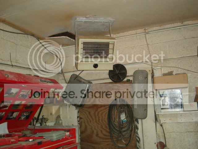

oh, new heats in... it rocks the dungeon pretty good.. when it's 20 in there, it'd take a long time to get warm... but if i run the propane for a 1/2 hr or so to take the edge off, it does an awesome job once the room is maybe 35, 40 at bringing it up, and maintaining a nice 55, 60....
it's really gonna save my butt when i go to paint next week.. flattening agent does not like the cold... you'll have to excuse the cheezy install.. the dungeon is such a disaster... all that rocks gotta come down next year...

Do you have a way to keep the heat circulated in the dungeon. I have a ceiling fan in both of my bays, and it keeps it within 5 degrees or so, even close to the overhead door.
I keep mine on all the time (4" insulation throughout) and at about 45*, I'll bump it to 55 or so while I'm working out there. With a sweatshirt on, its just right.:waytogo:

the heater has a fan that blows pretty good, you can actually feel it about 1/2way across the room...
other than that, no... being a body/marine/glass guy, I normally have ALL kinds of fans, especially box fans... but my last one just cr*pped out recently... need to pick up another cheapie at Wallyworld... it'd help just running that on low somewhere in the room.. ceiling fans wouldn't be viable.. but I'm very pleased considering that thing is heating 2 bays.... plus, it's a million times safer than running the Orb of Warmth...

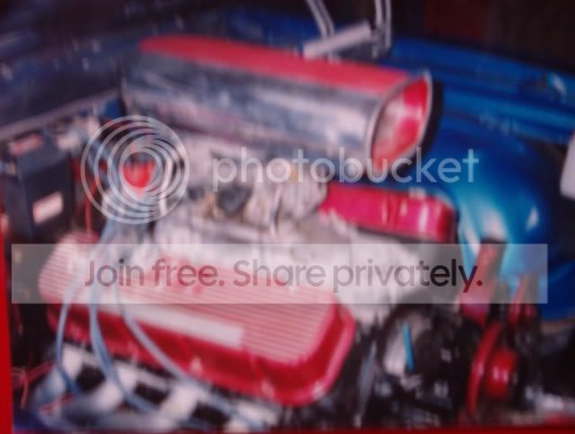

fresh mill.....
