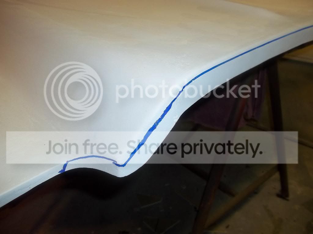

here's what I had to trim off the back of the cowl.....

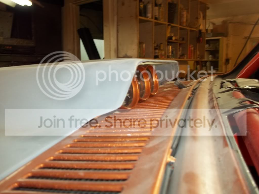

here's the hood back on, trimmed in back, with 3 gauges thrown up there to see how that'll work.....
but I wonder if its going to cause airflow problems while crawling.
One other thing, do you think the windshield wipers will block the view of the gauges

Don't give up on the larger gauges....just modify the cowl (original one) to drop the height in that area by maybe 1/2". If the very bottom of the gauge isn't visible it won't matter, the important stuff is what's going on across the upper part of each gauge.
Personally, I'd like to see you figure out a solution that keeps those gauges out there.
