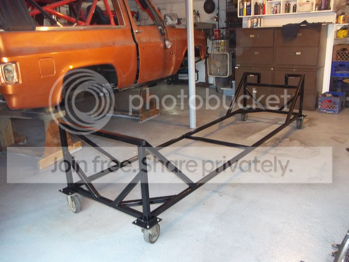

little bit of love for the K5......
getting a roll-around cradle...

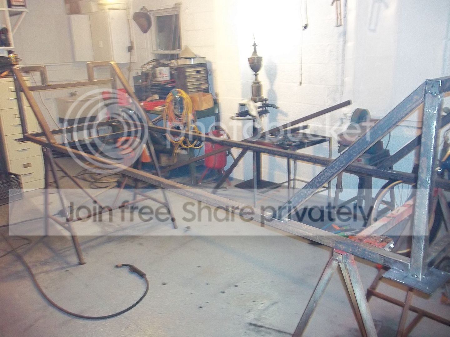

sitting up on saw horses for welding... it's 1.5" x 14 gauge, so it's pretty light.. picked up 70' last night for $120... tomorrow I'll add some more bracing and get the wheels bolted on..
the plan is get it a bit more mobile in the shop, finish my redo of the Dungeon, meaning install new lights, pick up and start using my bank of file cabinets for storage from my friends house....
2 of these low fockers... I'll stack one on top of the other...

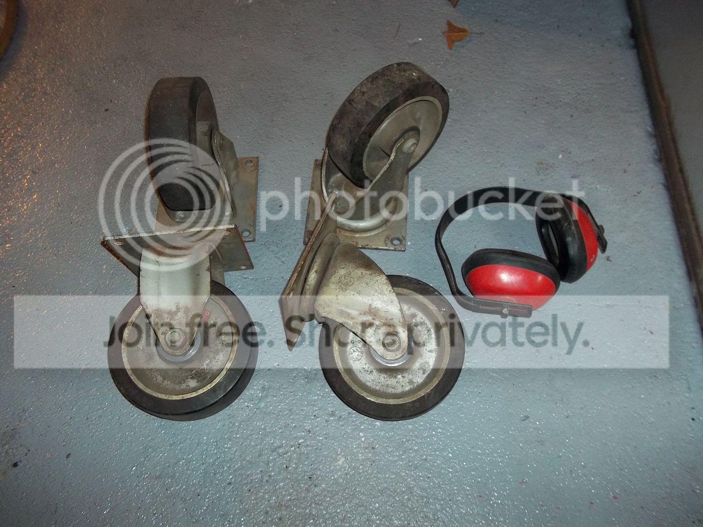

neither would be easy tho... if I push it outside, i'd have to ratchet strap it back over the door lip... they're 6" wheels... and only 2 spin 360.. the other 2 are fixed.. i wish all four spun... but it's what i got..

custom K5 dolly....
K5 on said dolly...

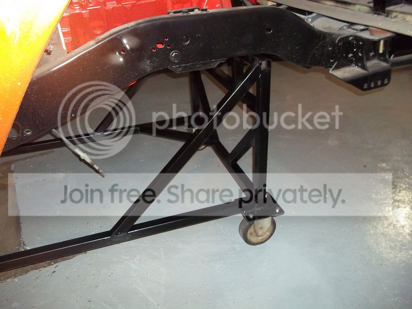

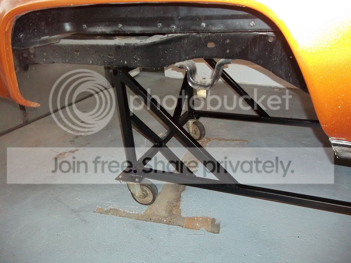

floorjack and lumber in the back and a cherry picker picking up the stinger on the front bumper...
Just curious....what does the body weigh as it sits?
no hardtop, axles, tires, suspension, or trans effectively, just a mock up case... on the otherhand, it has about 500 lb's of tube and a winch added to that body.. I'd guess there's between 3200 and 3500 pounds there.. just a guess tho..
