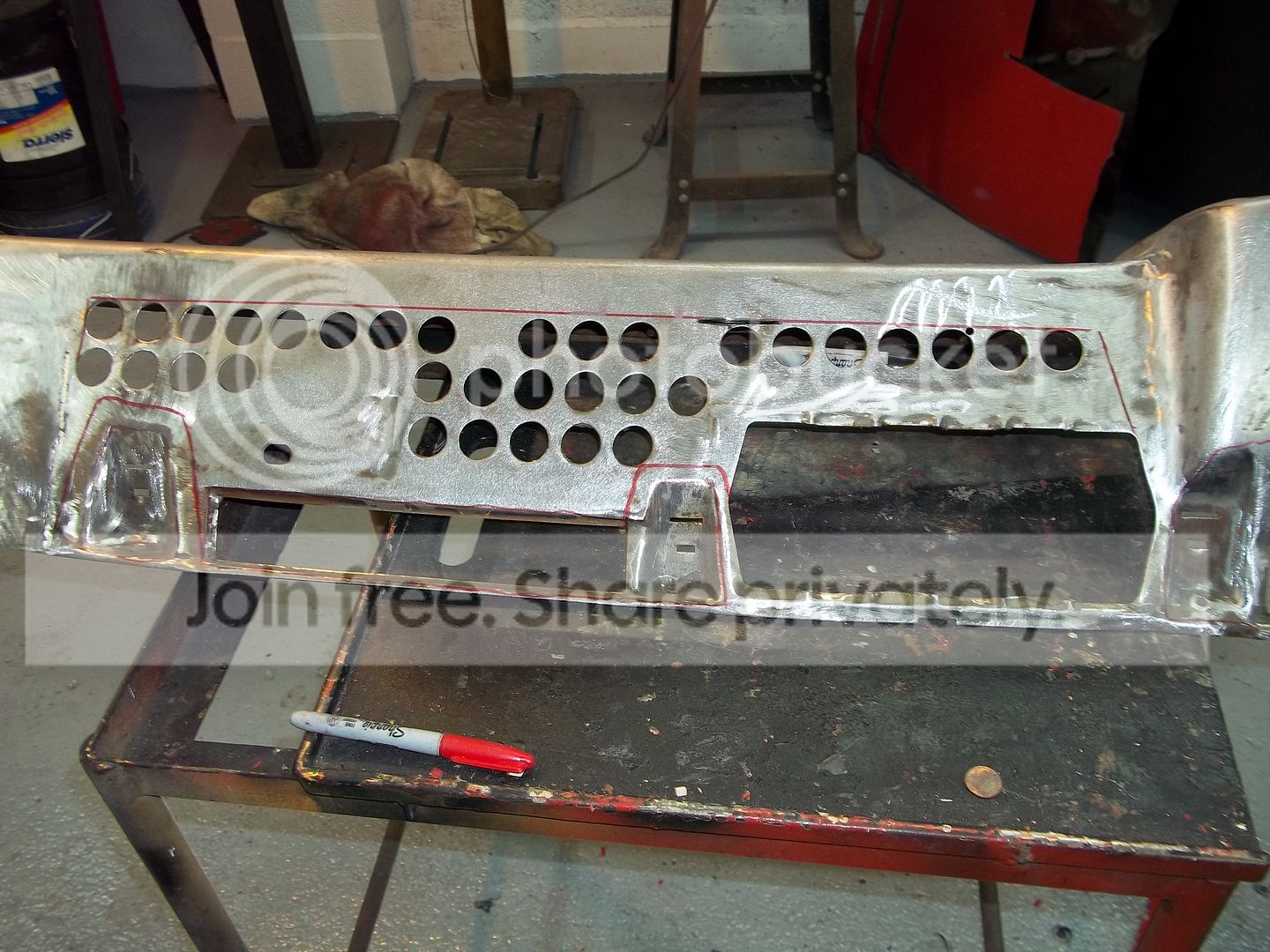

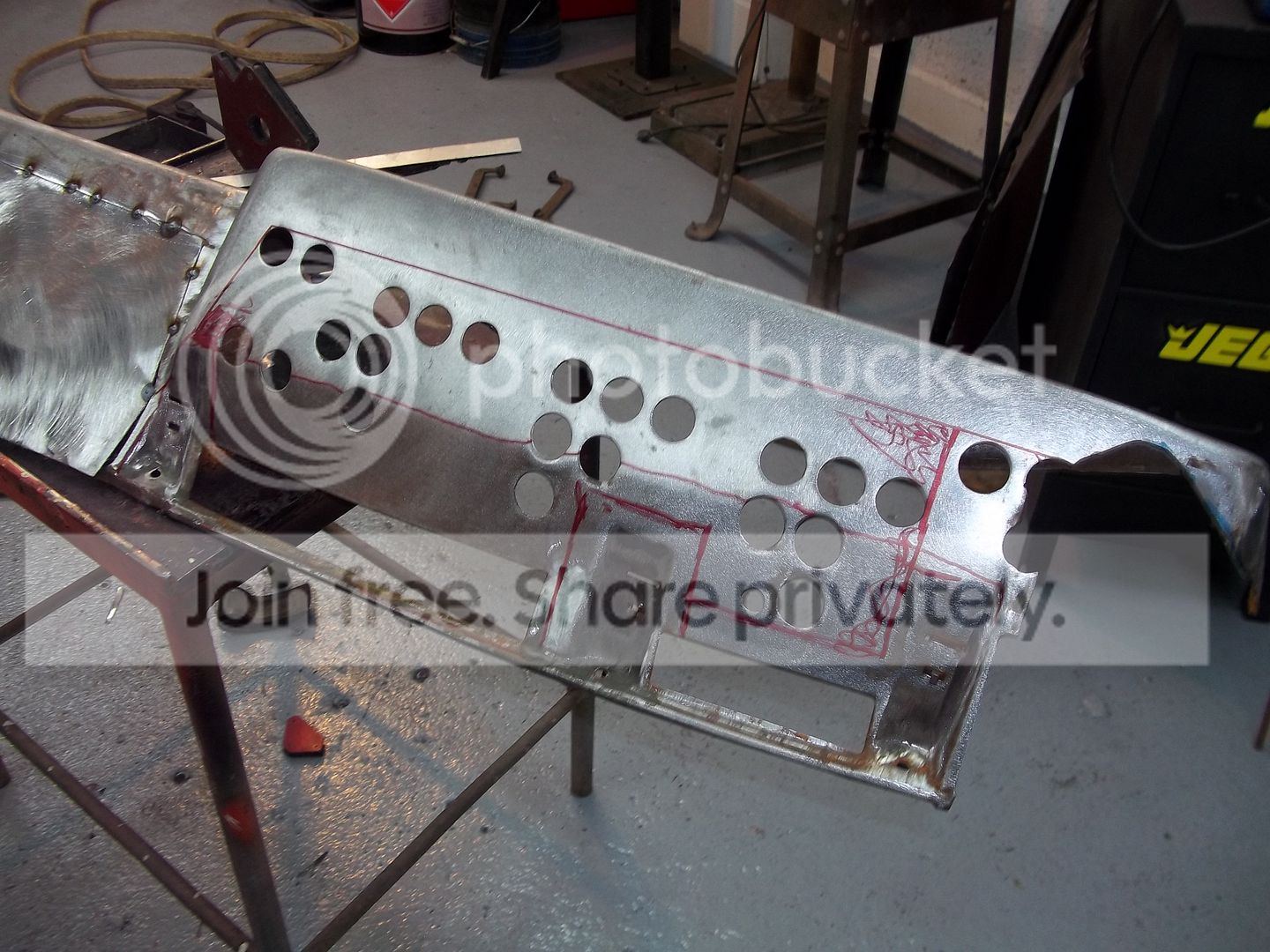

should work well.. i'll drill holes on those flanges around the clip areas
and plug weld em to the back of the patch..
I'm still up in the air about the very back lip by the windshield rubber, I may leave the rounded factory lip, but I'll more than likely cut it off once the clips areas and patches are in, and go with a section of round rod the length of the dash...
give it a subtle, framed smoothness and continuity..
plus, that'll help keep all them hooker $20's from slipping down behind the dash! :pimp:

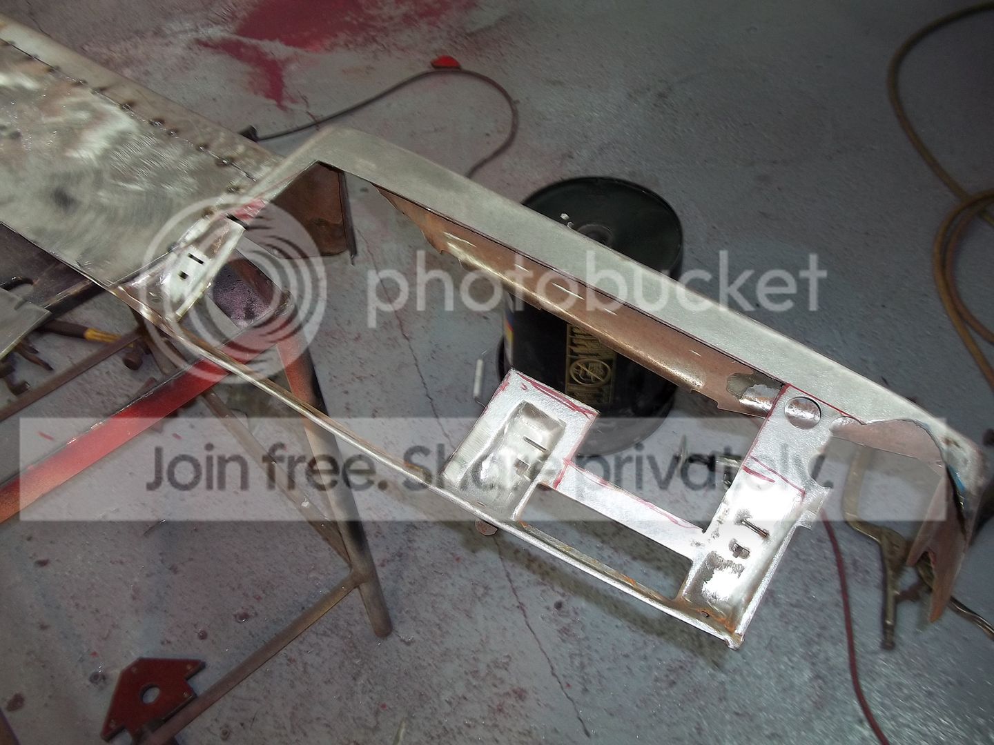

there are the clips that I've been talking about that slip into slots in the dash sub-structure, up by the windshield..
you push the dash into those slots.. than a series of screws on the front lower lip/bezel retain it back/down.. mine is staying with that basic mounting config... I felt the clip fastening at the windshield was crucial to keep in some way for ease of mounting, maintenance, etc...
once this patch is in, I'll cut the hole for the defog.. than I can do the glass work on the heater... fit that up... than the ds patch.. than the plexi area metal framing, yada...

well, there's the dashpad, than the dash under structure that it covers up and attaches to.. that is bolted on the sides, and welded under the windshield..
ahhh...so it is welded....I won't be removing mine....:whistle:

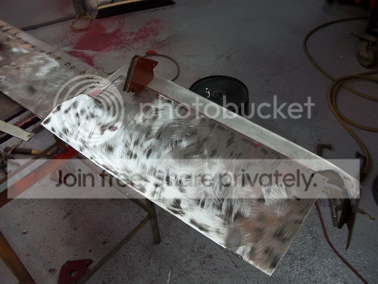

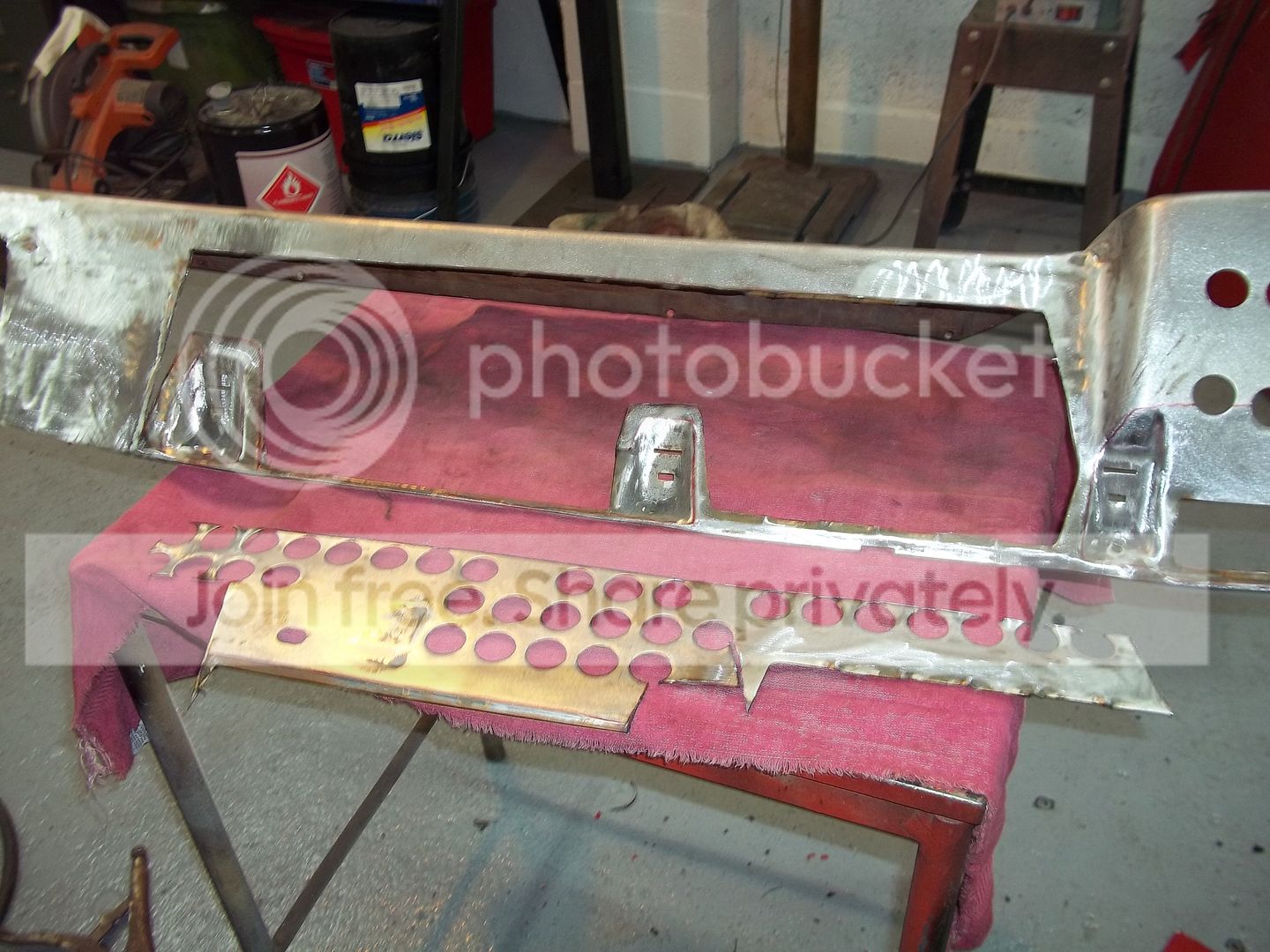

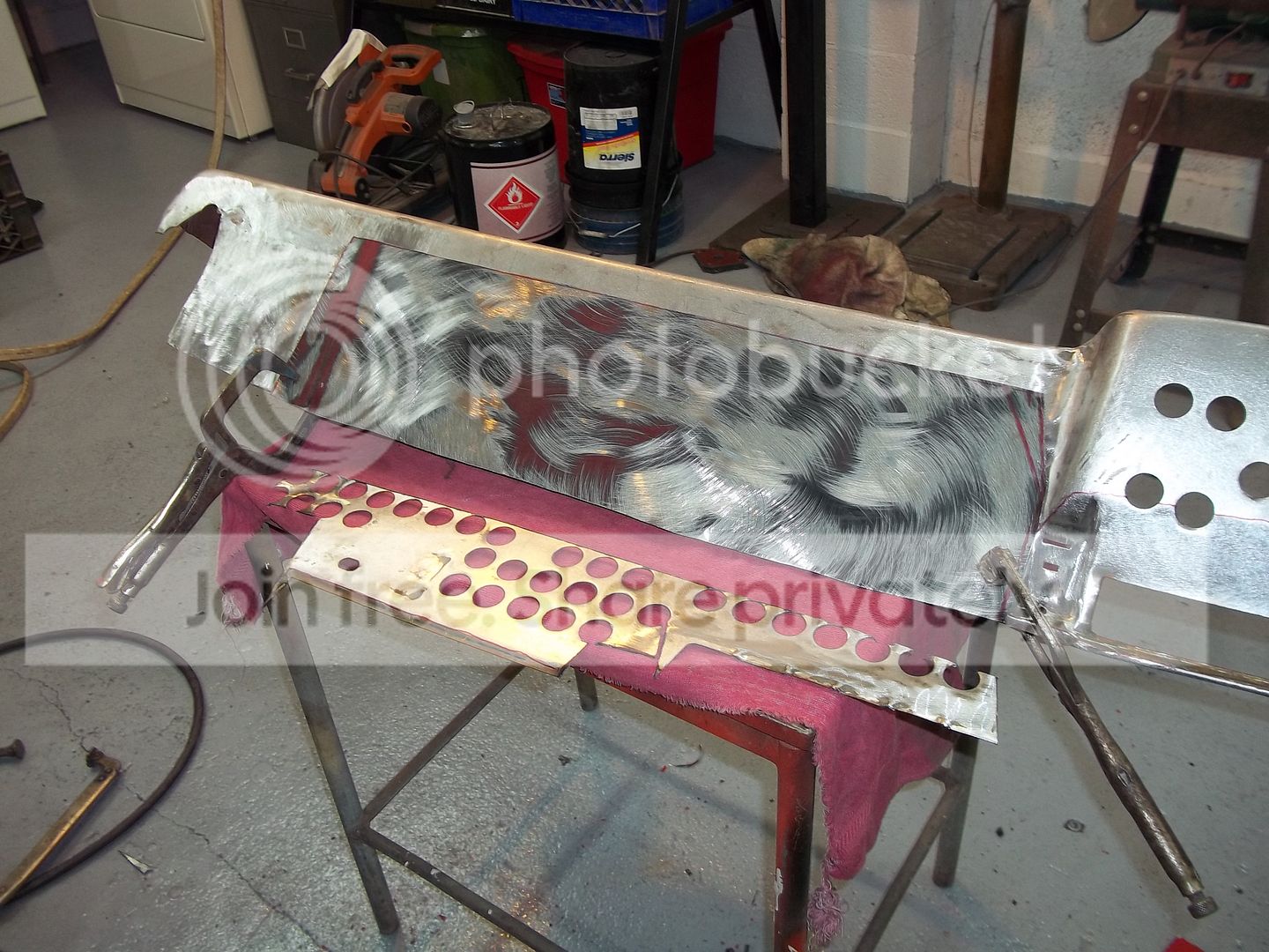

when it's done, that section to the right where the last hole is, will be gone...
tomorrow I start tacking and forming it in.. trimming as I need to... same plugweld treatment on these clip areas as the other side...
I've also decided i'm going to eliminate the whole back factory lip, and do roundbar only back there...
trickiest part is gonna be 3Ding the VIN window.. :popcorn:
