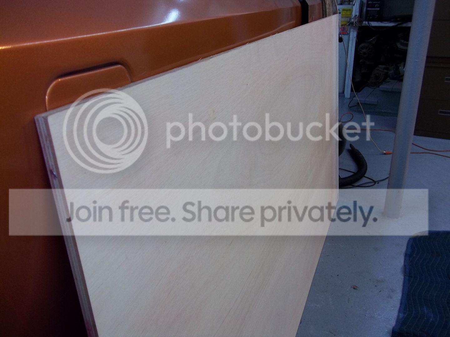

well, bought a truck box for Mutt today, got my blaster kit in and just bought the 2 sexiest, smoothest sheets of 3/4 ply eva at $46 a piece..... :eek1: :haha:
sanded hardwood ply..... even the $30, sanded on one side stuff was a bit cupped... I certainly could have made it work.. but said, f*ck it, these are ballsflat poifict....
my tentative plans at this point are to leave the inside raw and paint the exterior with the same gray floor paint I've been using..
but it's sooooooo fancy, I'm tempted to just put a coat of varnish on the outside! :pimp:

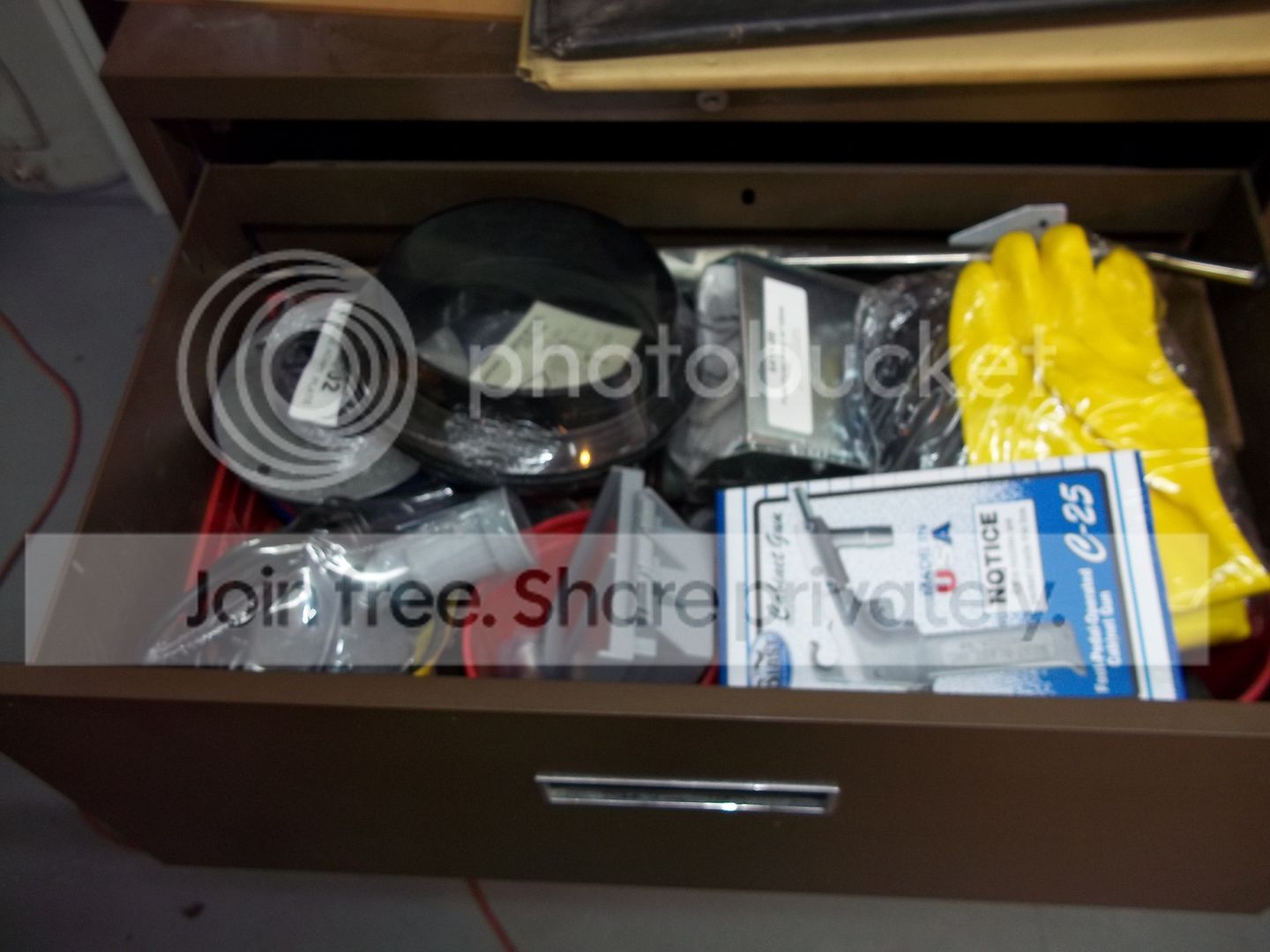

here's a drawer full of blaster parts..

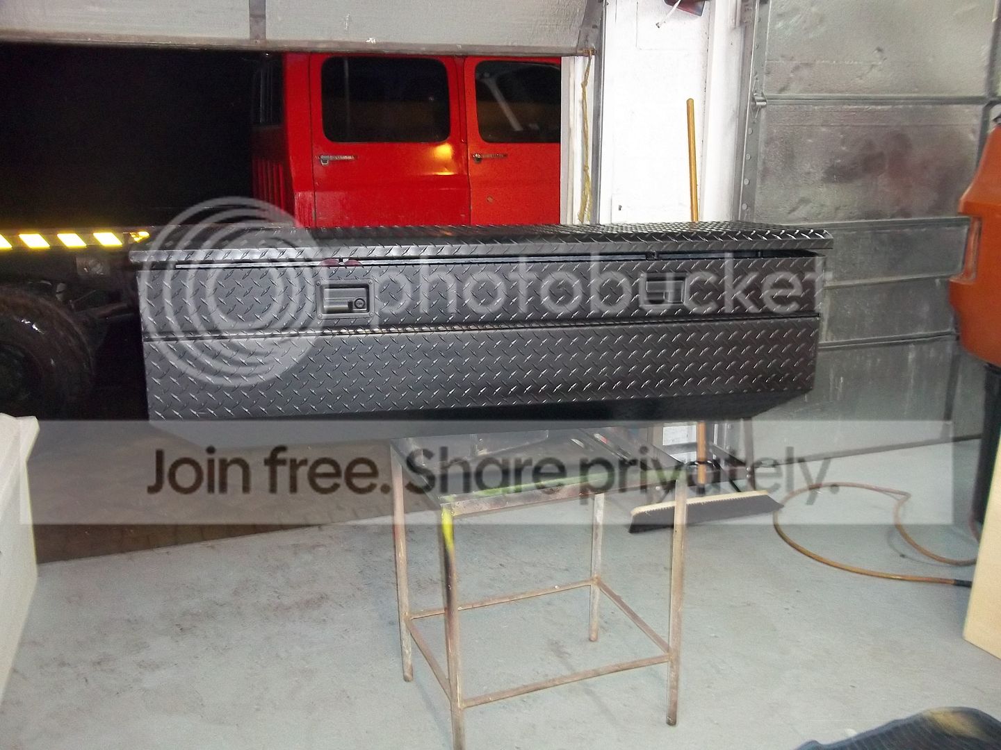

Mutt's box in zinc/flat black.. I'll do an install update in that thread sunday..

They're proud of that furniture grade plywood. It's always $$. What are you making w/ it?
For finish I'd go one of two ways.
If you want a traditional wood grain finish use Min-wax's water based polyacrylic (blue can). One of the wood working magazines I read recently did a comparo and the new water based poly held up better than the old tried and true oil based. Plus, it dries much faster (30 min compared to 3-4 hours for oil based) so you can recoat much sooner, odor doesn't linger as long, and it comes in spray cans (what I use for my peppermills).
Option 2 would be to used a bedliner. I made a clamshell type box for my friend's guitar pedals a couple years ago and used Rustoleum bedliner to cover it. The stuff sticks to wood even better than it does sheet metal. It protects the wood from dents (I tested it by hitting it w/ a hammer) and it makes the wood totally water proof.
Will do with the pics. Agreed on $ for HF tools, but from everything I can find any saw below a grand is more or less made in the same factory. Depending upon the brand, some don't even change the cabinet.
it's the blast cabinet.... I think I'm gonna do mahog stain and that water based poly maybe. thanks... not gonna bother with sealer and such... it is a blast cabinet in a garage after all.. :haha:
