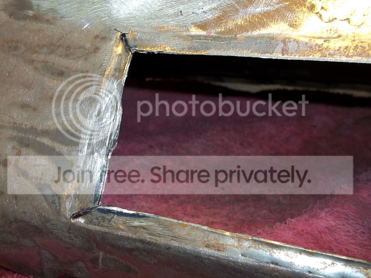

as you can see in this one pic, as the sheetmetal gets to the trim recess, it drops in about a 1/4"...
well, I knew I would have to cut straight across from that upper and lower hole edge...
than I'd need to bend the lip, and hammer it smooth, so I could get every mm of sheetmetal so the edges of plexi where covered, and the majority showing.. in addition, it gives me some chance of building/securing the frame I have planned...

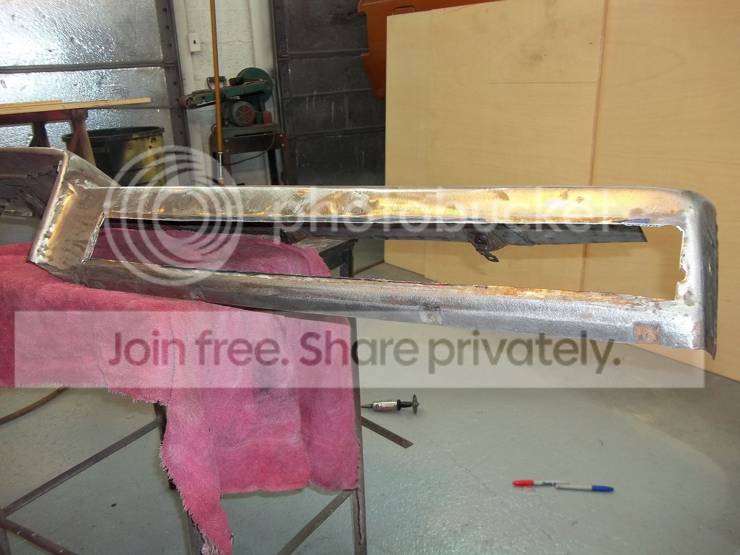

here you can see where the peak was, and how I'm flattening it going around... I'll finish the hammer/dolley work off tomorrow..

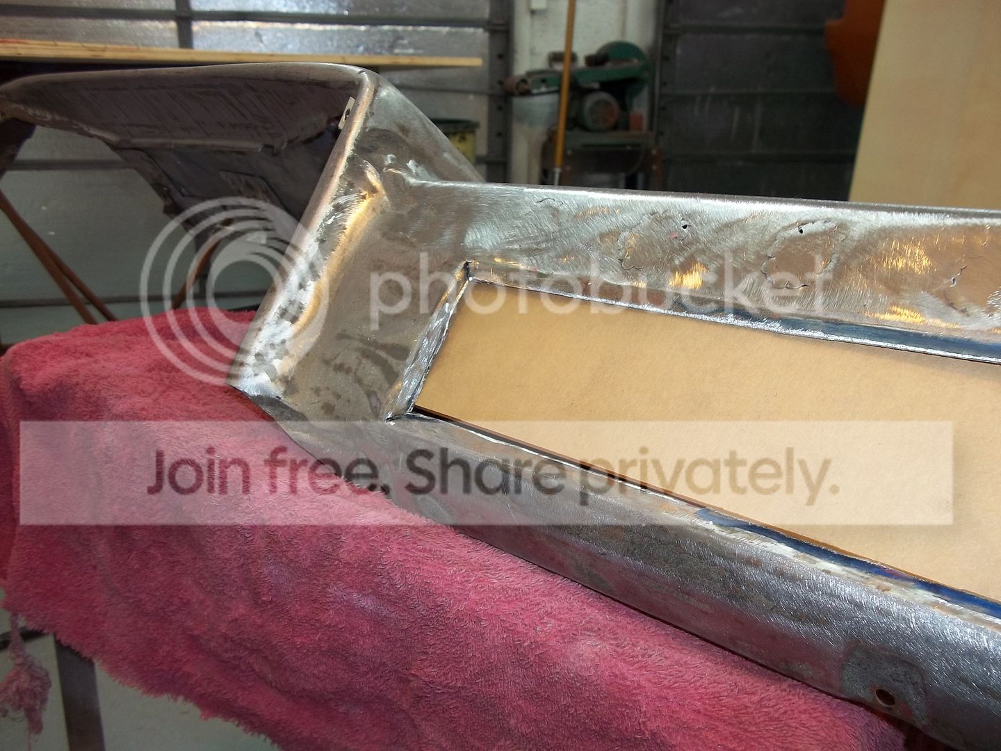

but here is the plexi behind it.. 1/8" of sheetmetal all the way around...
once I build the frame to hold the whole assembly, it'll be absolutely perfect... the LED's will be hidden by the sheetmetal, and lighting up the plexi from just off the edge..
