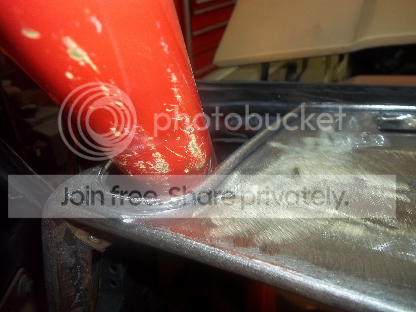

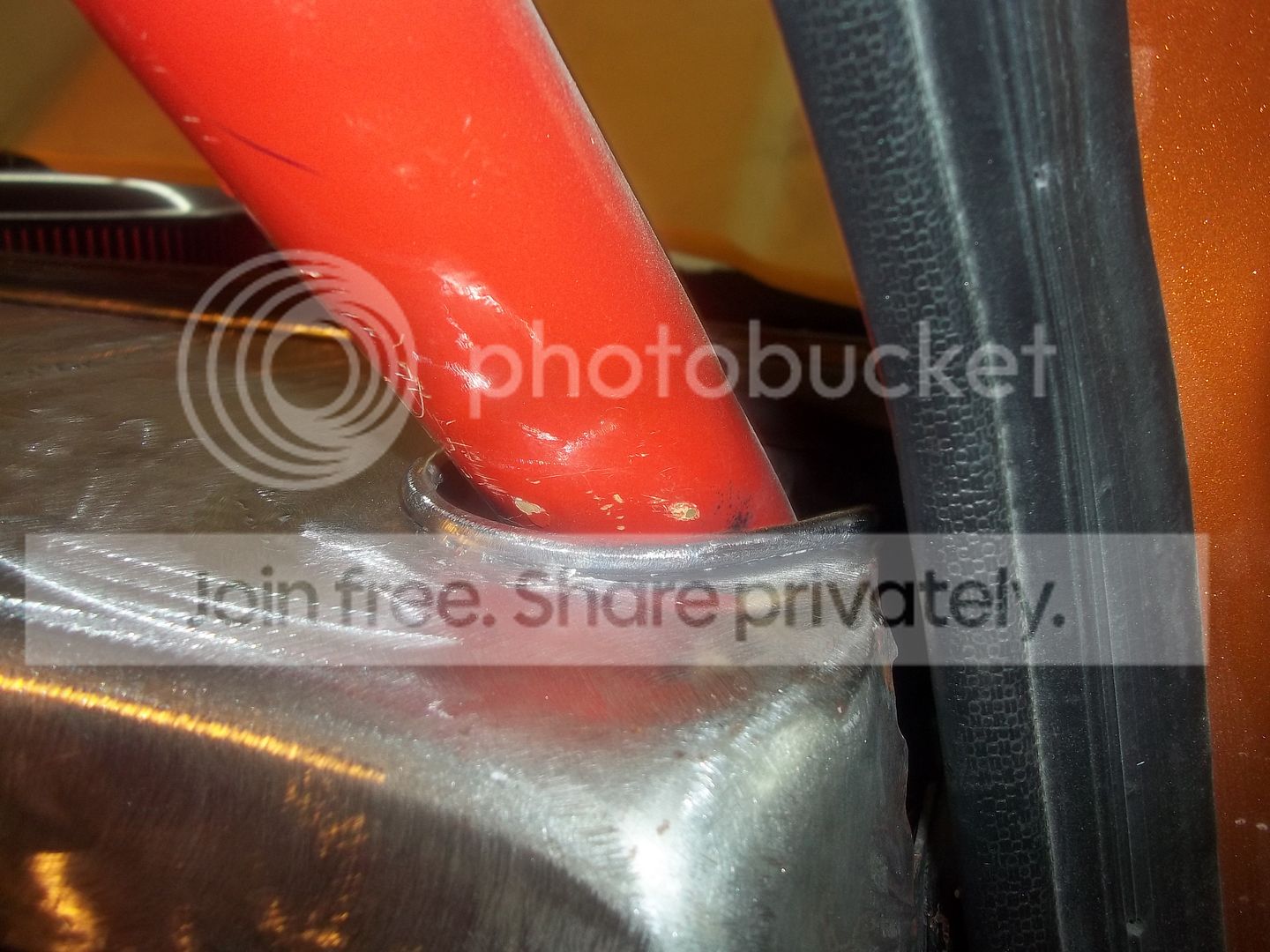

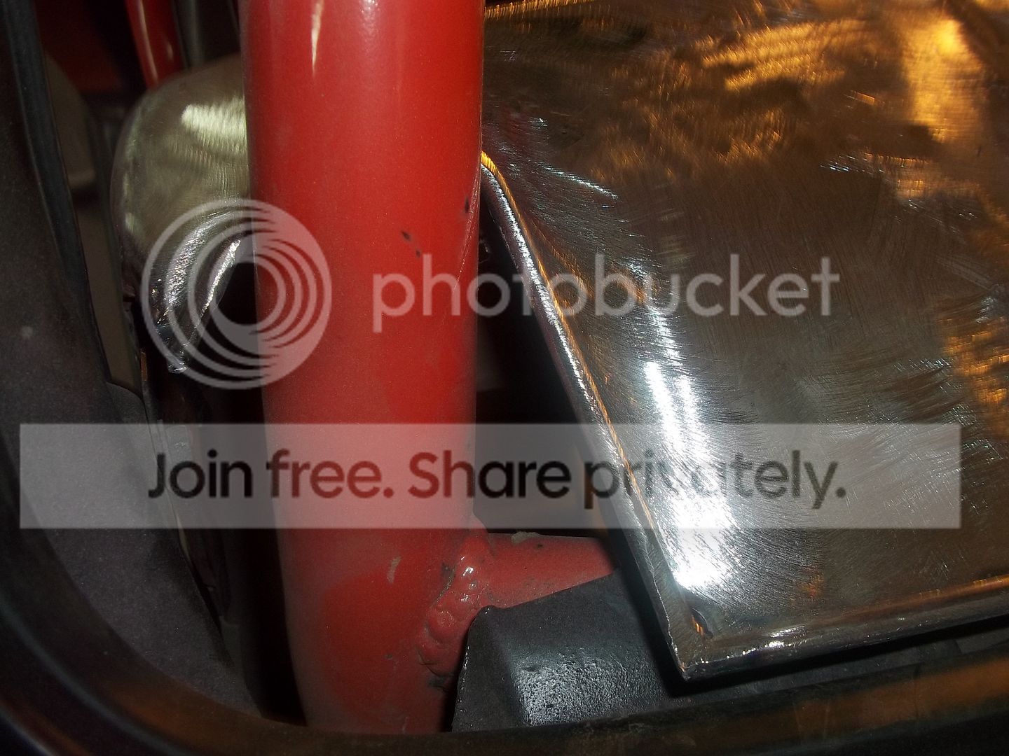

last of the dash metalwork.. wanted to carry the round rod around the cage cutouts...
Nice touch:waytogo:. I like the whole one off concept you got going on with your rig. I'm sure you can't wait for the finish line, there are plenty of us waiting there also:thumb:
thanks... :D the whole rig has become that... it gets to a tipping point customize-wise, where it just becomes 98%... doing a couple projects on a rig is one thing... this, on the other hand... :whistle: :doah: :haha:
one more off the list... :thumb: gonna try to get this primed and painted over the next week..

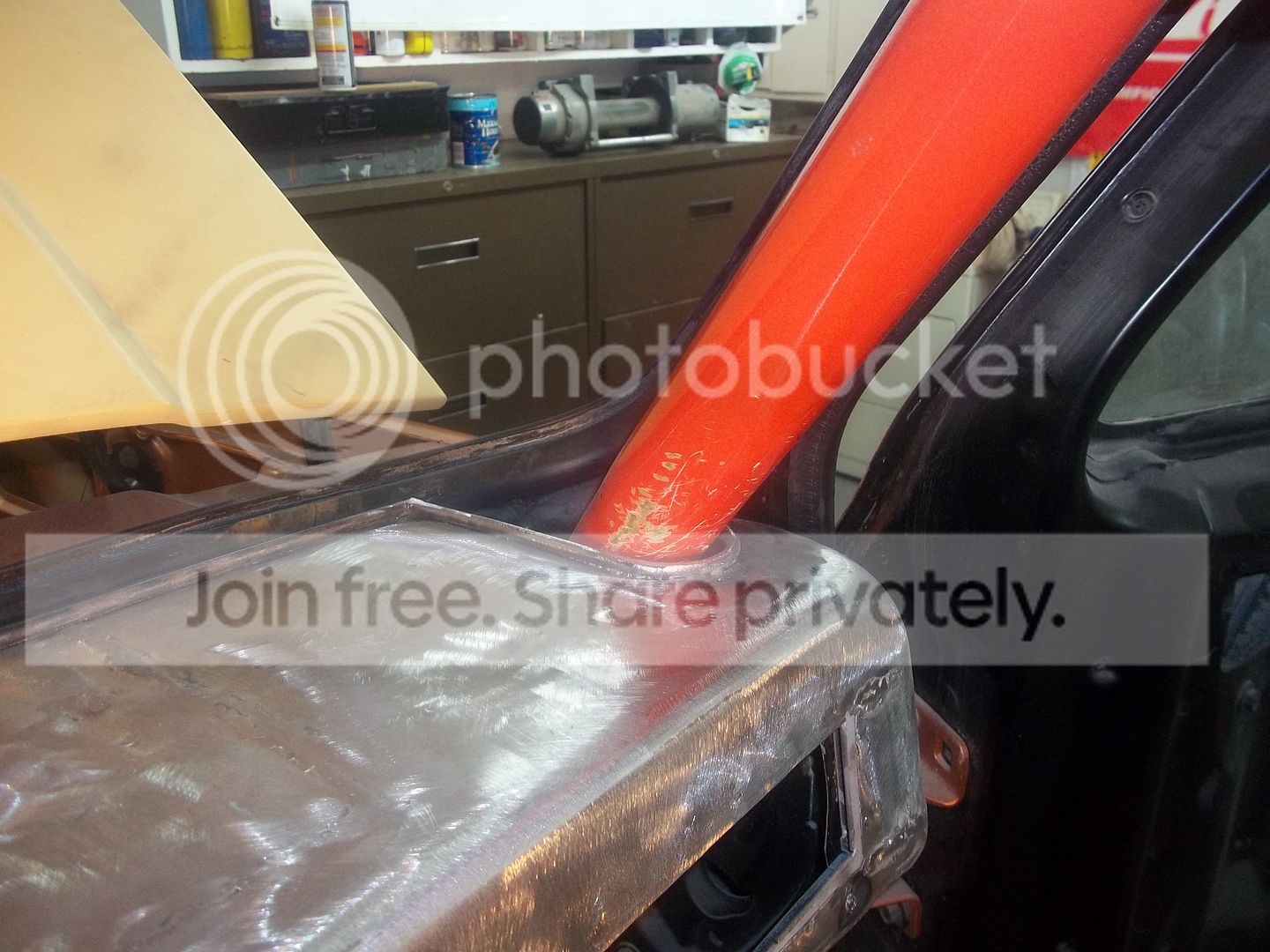

I'm dreading this heater hole.. tis gonna suck... :doah: :haha:
the dash doesn't just drop in.. the clips slide it forward and down...
so, it needs to be in place when locating the opening..
the heater can't be installed unless the top lip is low enough..
trim, try fit.. rinse.. repeat.. scream.. beer repeat.. rep.eat
think I have an excellent plastic vent for the top tho.... :pimp:

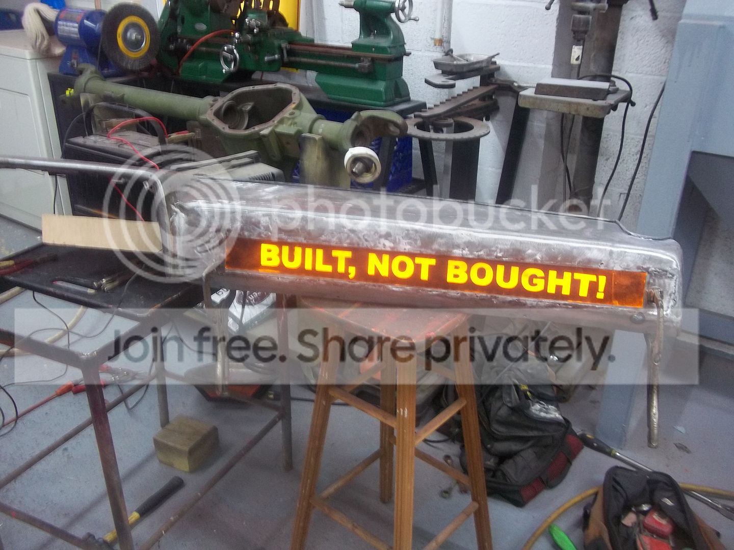

I suppose they call this "proof of concept" work...
and a blurry dark one...
It will also do the same in green...
I may at some point work on some where I can use both the colors... like green lettering with orange shadowing or something...
the only issue I have to correct is me being a dyslexic brainfart.. all this reverse letter, stencil stuff get's me backwards sometimes.. thank god Scott is patient with my psycho needs.. :haha: :bow:
when I had him make that up in sandblast mask, I had it forward, so I needed to blast the top.. it works, but it's equally as bright when you etch the underside, and leave the smooth side out... :doah:
the main difference being when it's on the outside like currently, when the lights are off, it's still very drastic.. whereas when it's on the underside, you can barely see it when off...
no big, the plexi is $4, and I've already got something of another Scott order already to go so...... :haha:
but now, I see it works... just gotta weld some studs in for the holddown...
anybody wanna buy advertising space? :haha:

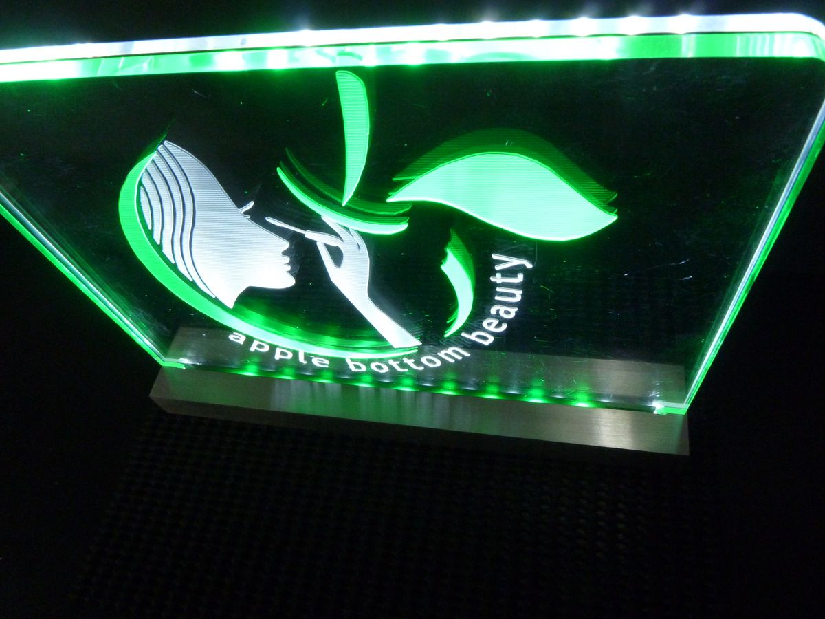

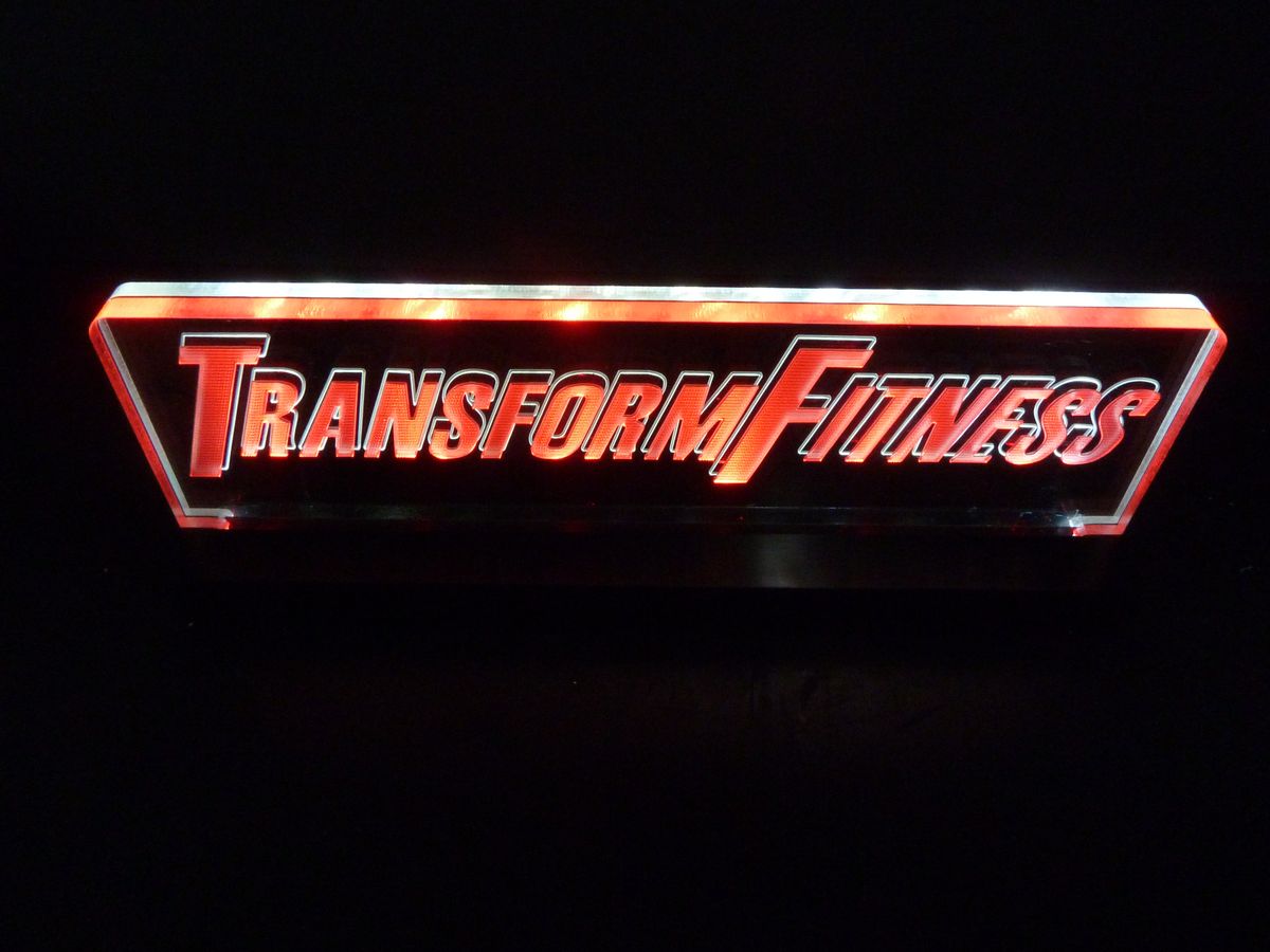

well, just figured out how to do dual colors... you just do a layer of plexi for each color and stack em.. which with the frame setup I made, makes this super easy... ya have to have 2 layers automatically, cuz ya need a backer one behind the first one anyway with the frame...
so now, I'm just gonna buy a stack of these plexi pieces so I have many blanks to play around with.. cheap enough... found my new late night hobby, coming up and drawing new engraving possibilities... need that dremel/router setup now.. sit at my coffee table watching military channel and making plastic shavings...
already trying to work up some other panels to put in there for various occasions...... some just graphics only... I'm working on a couple 2 color ones in paint now.. a shadowed, wide bowtie emblem, Zombie Squad, a flame one, Ryoken's Rig, etc...
this still seems to be the best 2 color job I can find...
a 2 color, side by side kinda deal..
this ones a pretty detailed shadowing effect, tho a lousy pic...
