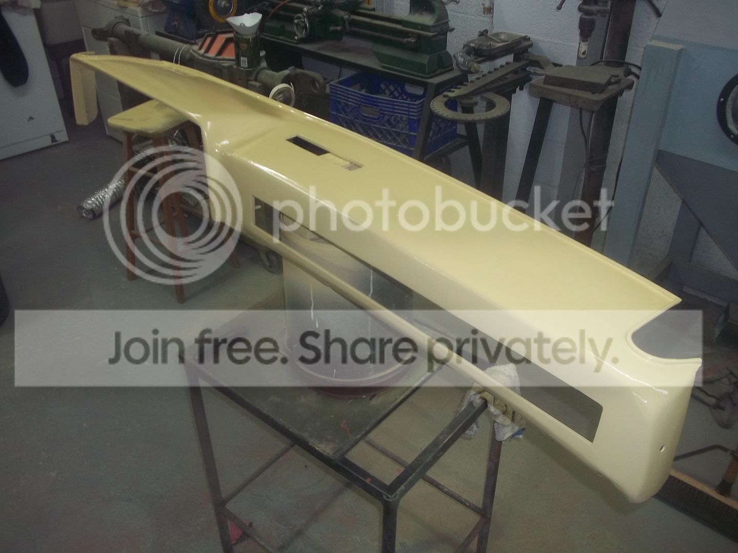

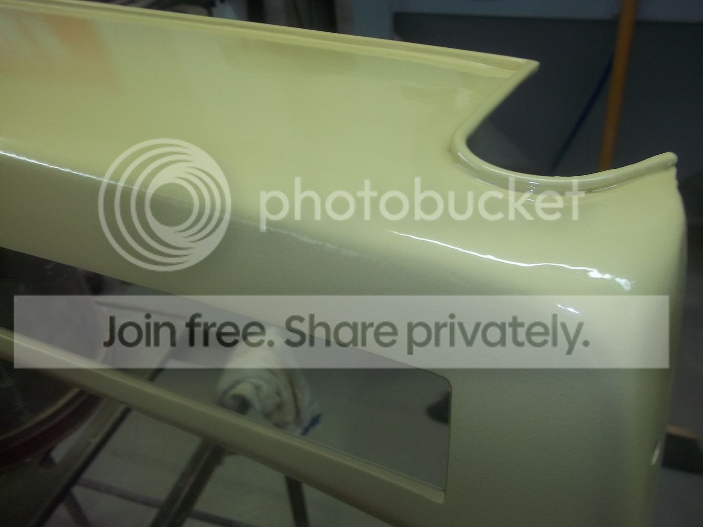

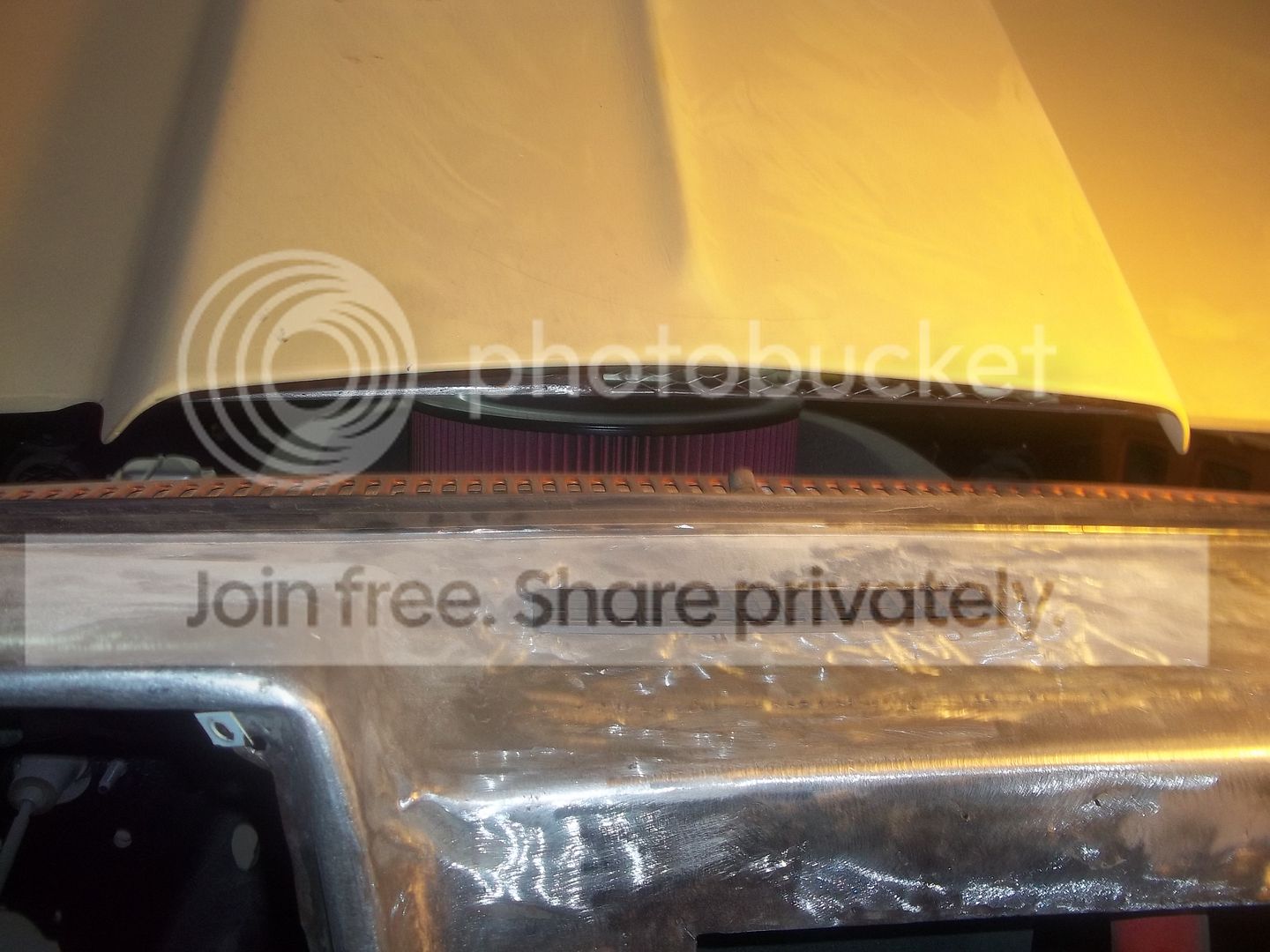

what a pain in the arse... first, locating was a big enough pain....
than I must of pulled the dash and heater out eleventy times to modify the heater box for proper height...
than I had to add some structure to the underside of the dash to retain it's flat rigidity....
grrrrrrrrrrrrrr... damn garage heat went out..... :mad:
I was gonna prime the dash today.... I'll have to get "creative" to warm up the garage tomorrow so I can shoot primer.... :pimp:

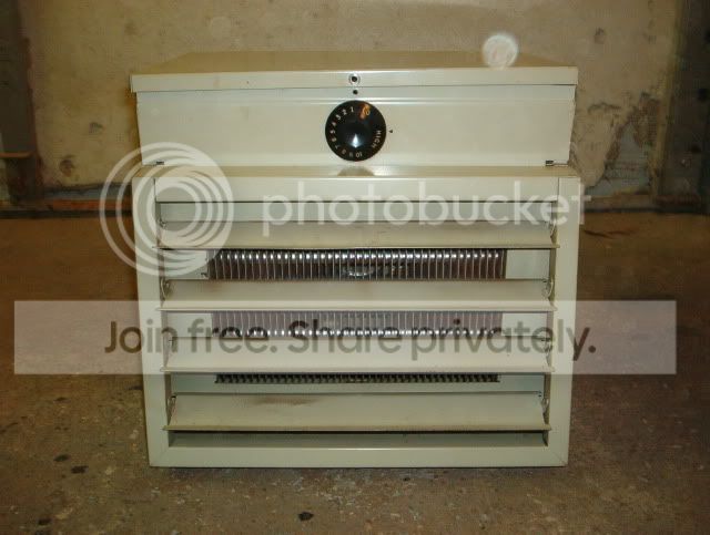

couple oil filled electric heaters and running the dryer with the vent inside should take the edge off... :haha:
oh, yeah, focker runs like 500 a month if I run it every day...
it's why I didn't do much in jan, but I'm trying to get some projects going before I go back to work, electric bill be damned! :haha:
I've gotten a bit spoiled with it the last couple yrs.. I don't mind it cold, just taking the edge off is fine.. at least your out of the wind..
biggest issue is getting stuff to dry...

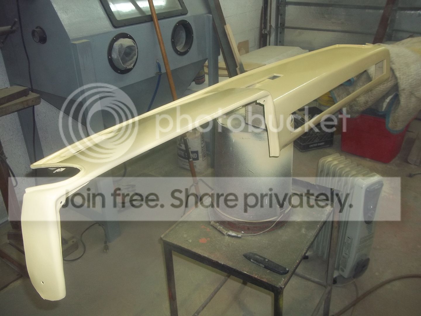

finally, paint tomorrow....

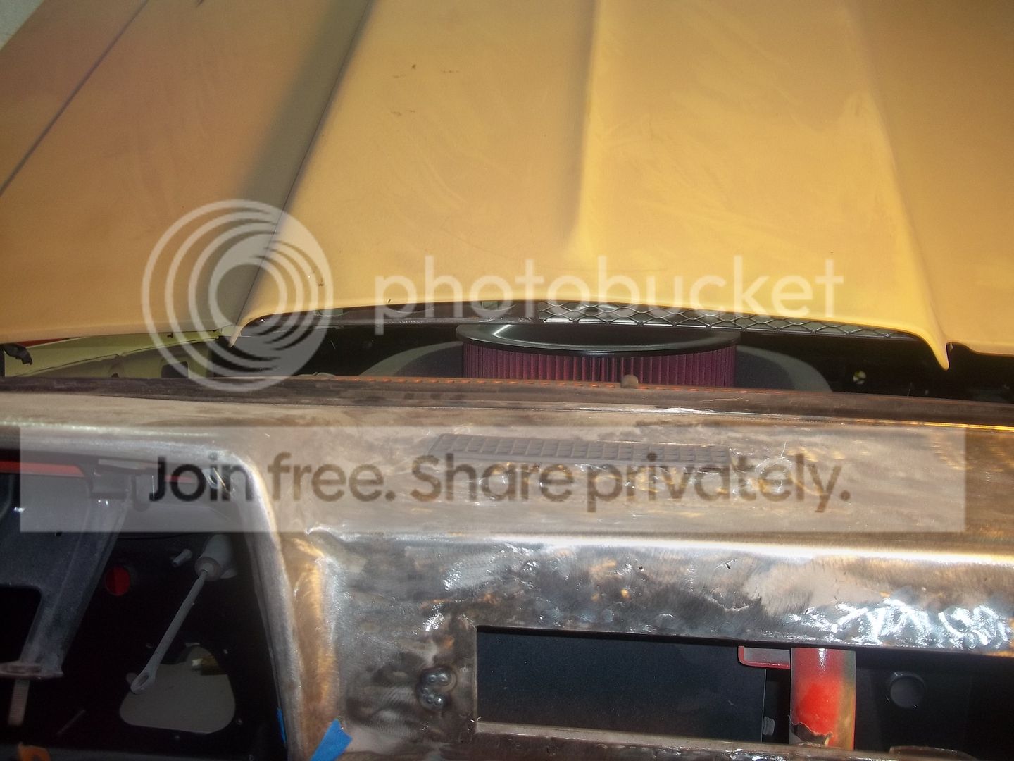

1 - the rest of my time off will be spent finishing up the driverside bodywork... what? you can only look at one side at a time!?! :haha:
nah, the fender is raw steel.. the sectioning is done but I gotta zinc it thru paint.. but the qrter panel sectioning is only 1/2 done.. still gotta weld/fab that... hood, fender and lower back will need paint.. can't afford a $400 gal of Chromabase with Mutt upcoming... that'll wait till the next time I delve into this.. if I can get it all in primer now, that's cool..

oh, and before I primed that, I blasted it in the new blast cab.. 1/2 at a time...:haha: hung a towel over the door opening with it sticking out! :pimp:

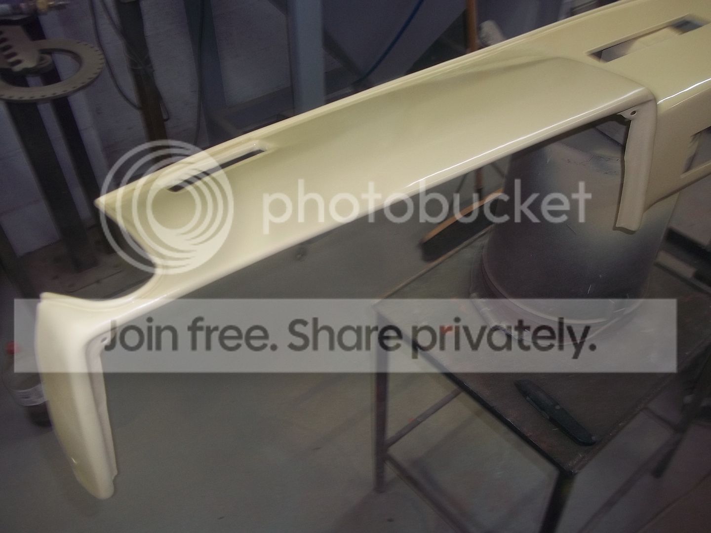

Man, that dash is sick! I can't imagine the work that went into that puppy! Excited to see you digging into this thing again!
check another off the "one off" list... :haha:
thanks mang.. I probably have 80 hr's in it or something... :whistle:
it just kinda seemed the right direction... keeping the stock lines was important in the look I was going for with the center console/cage blending into the stock dash..
and I think if I get the right etch job in the plexi, it could be cool when on.. I have a new idea for that.. the line work all needs to be much more dainty and involved... right now I'm working on a much more subtle 2 color bowtie.. also a GMC...
but working on that is actually below playing PS 3 these days! :haha:
unfortunately Mutt, health and finances have reared their suckyness in this build... but I do miss it and need to start investing in it again soon...
have to make that brain pic... :screwy: :saweet:
hopefully it looks exponentially better tomorrow night painted black and installed.. ;)

what are you painting the dash with...standard or are you putting something on for extreme durability?
