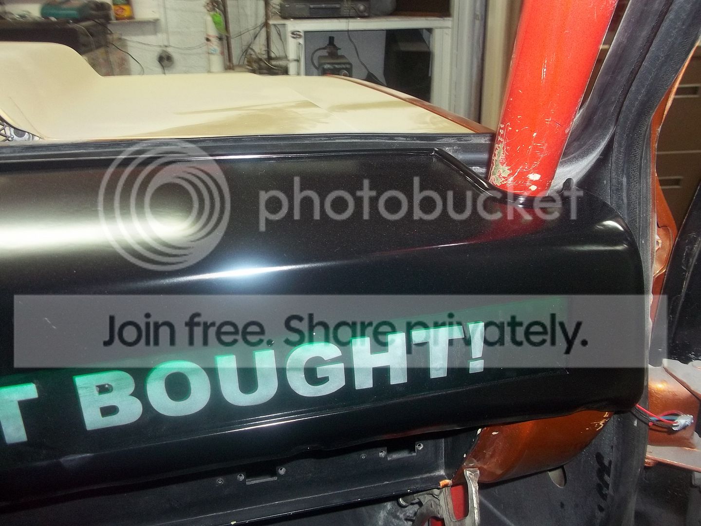

Interesting, I just thought glass was glass. It does make sense though, I know when I had a window busted out on my old 2011 Silverado I wanted them to put factory back in.

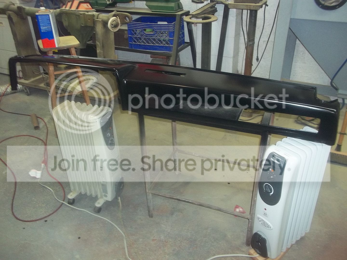

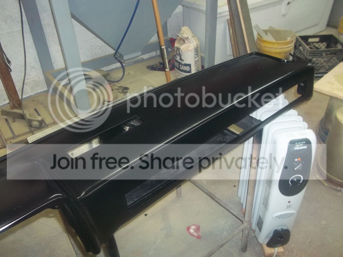

it'll dull out a fair bit more as it dries in.. be cold down there.. :whistle: i'll prolly wait till tomorrow to install it..

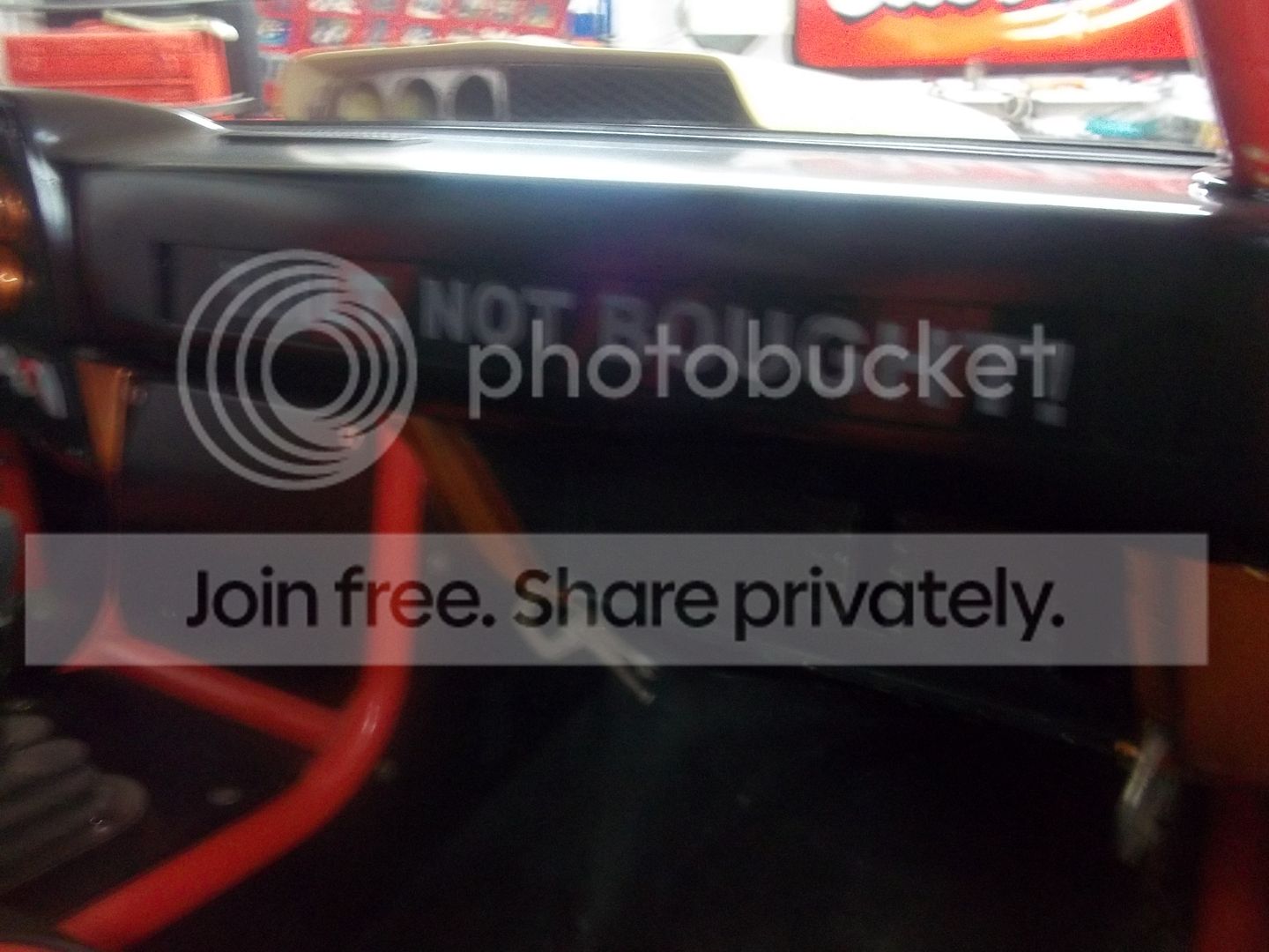

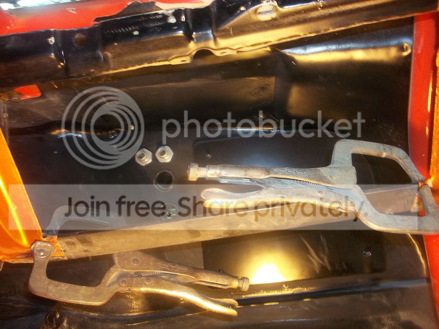

working on glovebox stuff now...
the 1.75 x 1/4" strip steel..... mmmmmmmmbeef....
you can see the floating ECM mount in the background.. it mounts on shock pads..

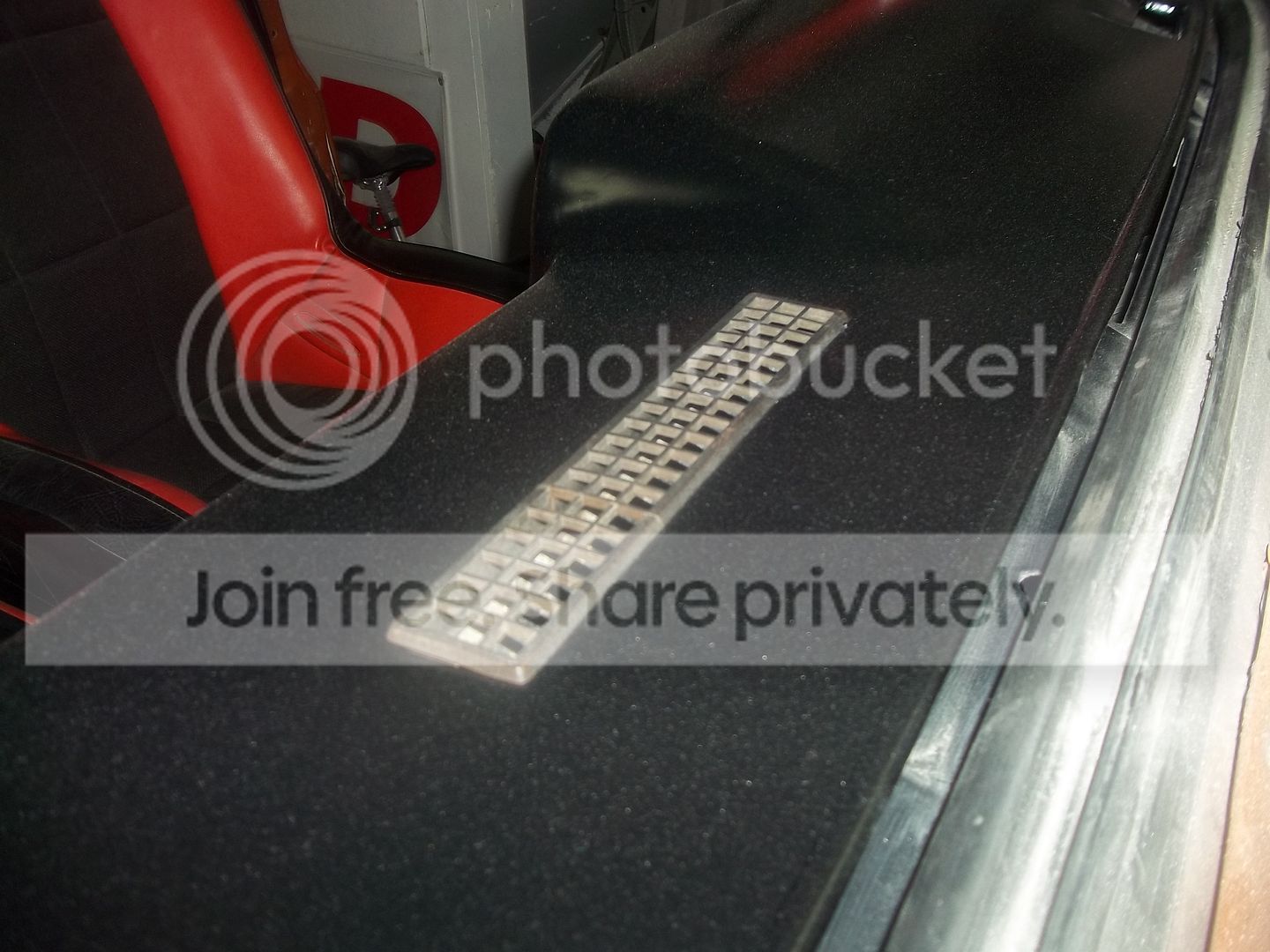

I'll be adding a small strip of glass across the bottom of that.. so the kickpanel can lock/wedge in there first as you click it up in place with these flush mount/pop out/1/4 turn gizmo's.......
the conturas are my new winch controls... update tomorrow on that stuff...

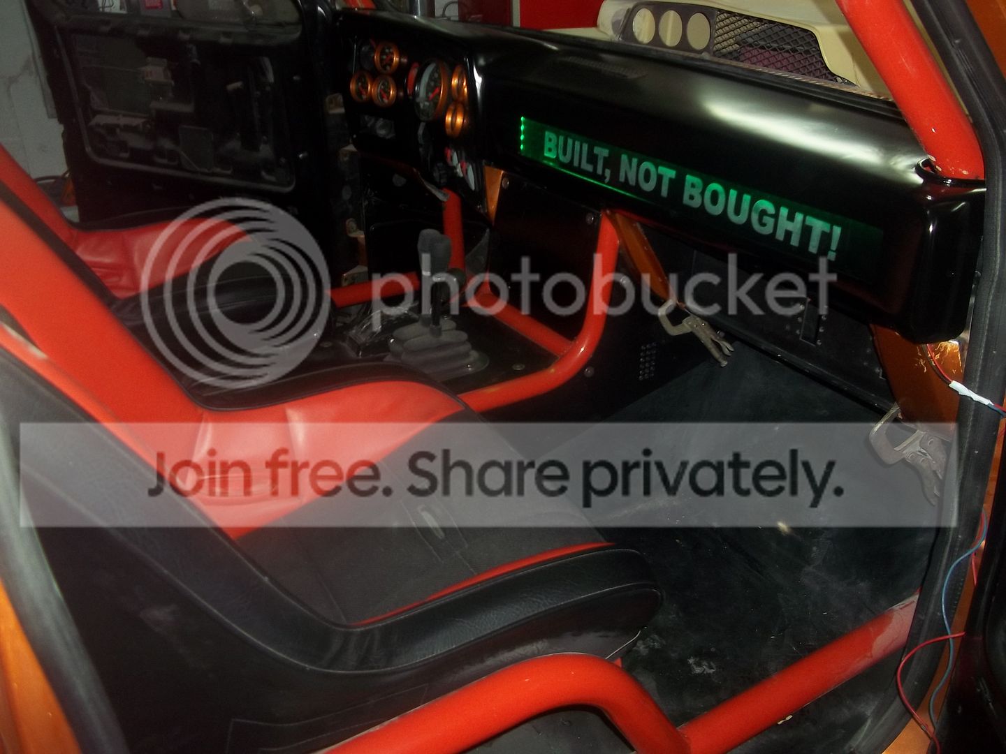

you'll have to excuse the scuffs and dust, etc.. things have been getting bounced around since Mutt got here... some things need overcoats, etc...
but it gives ya an idea of some final looks and lines..

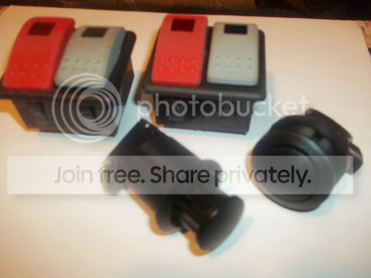

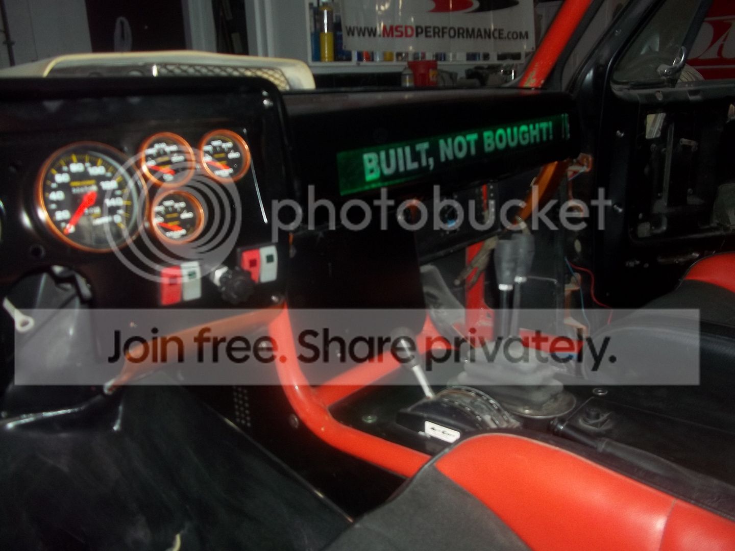

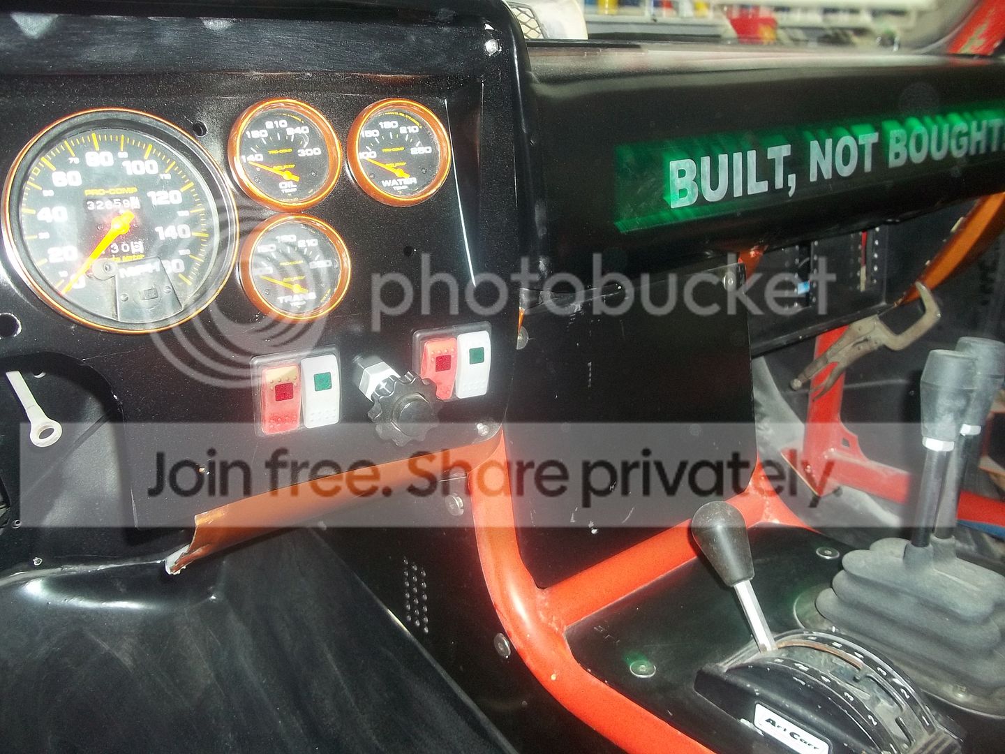

reconfigured the right side of the dash switches..
left to right...
front winch power, in/out..... hand throttle..... rear winch power, in/out....
I'm almost ready to wire this insanity...... :eek1:
need that 747 touchscreen to round off the dash tho... :pimp:

I know nobodies really digging the plexi at this point, but I think I can make it cool with other effects down the road... the tech certainly worked super well, for what it is.. has me revved up about trying dremel engraving... :popcorn: wish I was an artist! :doah:

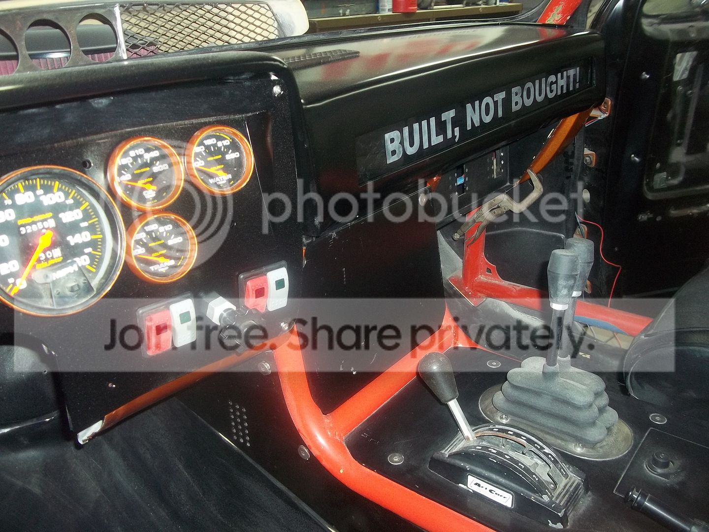

redone with shiny blackface when off, for cruising around, should help appease those preferring a "not so over the top circus wagon" light show look........ ;)
first I'm just gonna try adding a layer of amber flames to that and see what it looks like with 2 color... but I suspect it'll be a bit busy..
so glad I built the rack/frame that holds/stacks them... there is a 1/2" angle iron, external frame that slides over the one welded in the dash.. I welded 4 1/4-20 studs to the dash inside, so the retainer frame is adjustable for 1, 2 or even 3 plexi layers...
simple to change out designs...
anxious to get the smoked plexi door in there now.... :woot:

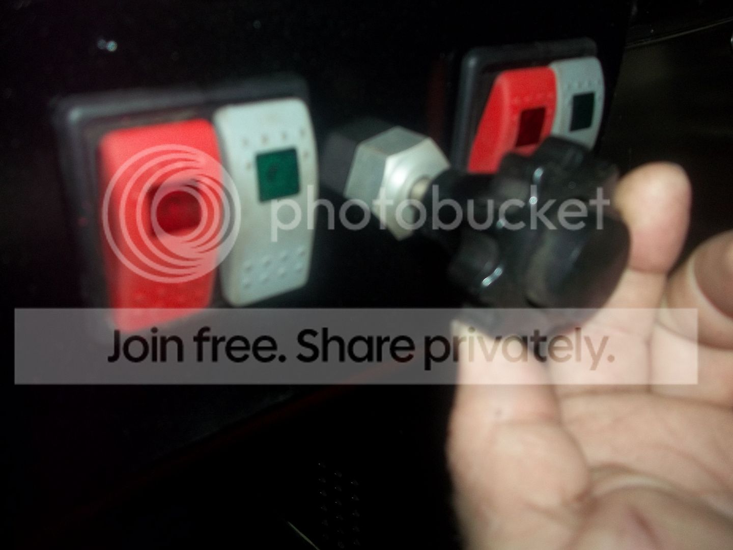

and here's the hand throttle for those that didn't see it when I bought it..
push button, full slide control...
and than it has the much finer adjustment of turning the knob in or out too..
