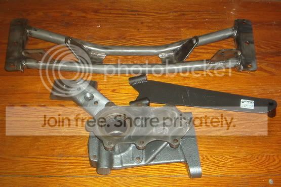

The other stuff coming in... 27 spline input shaft for the 205, matching coupler, fitz-all spacer, 32 spline front output, another set of 0-rates (they forgot to ship), 4" front TC E-Z rides, H.D shackles and ORD's FUSH kit, all greasable...

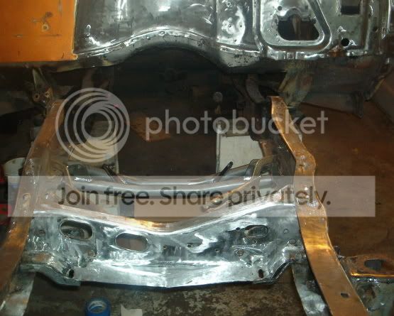

I'm going 1 ton and x-over now... prepped the frame for the weld-in brace and some filling and smoothing.

Thats ORD's engine x-member.. just clamped in place.. probably gonna mount it today... I'll figure out the back setup once the motor is in...
I have a few anticorrosion methods I'm gonna apply on the frame stuff/parts/work..

Ok that makes sense, I was trying to see if it was the trans crossmember or the engine. So my guess is you then cut out the original cross member correct? Can't wait to see the slider and tunnel.
well, with everything out, once the rivets where done, I just slid it out towards the back intact. todays projects are to figure out my tentative shock avenue and source a 2wd sector shaft..
